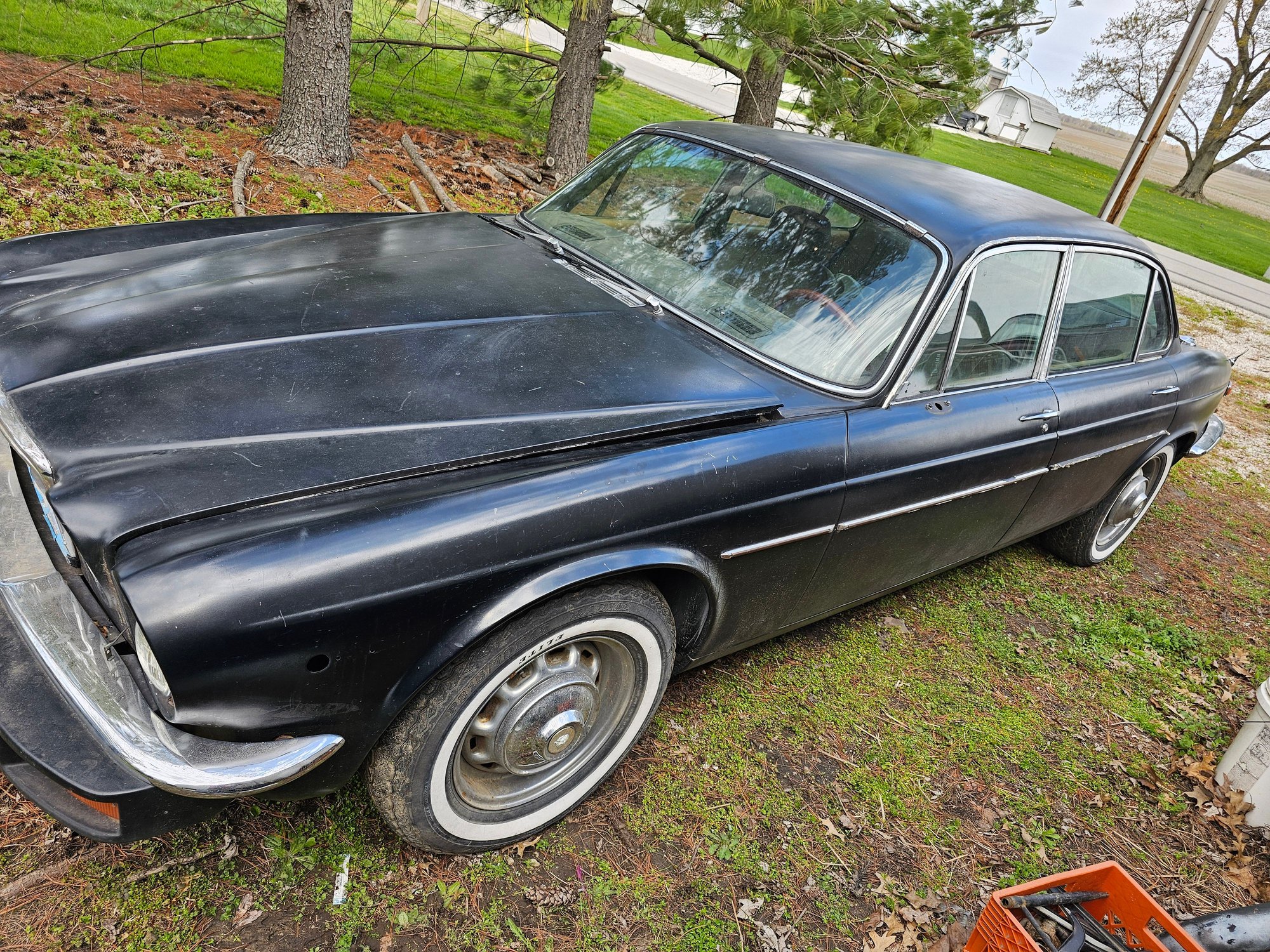

I have a 1979 Xj6L series 2 (I'm brand new to jags and know zero about them) that's needing some parts and I'm getting mixed answers online about what all fits what
I'm in the central US.
Nothing with the motor really. It will be replaced by an LS soon.
Floor pans...they're listed some places as series 3 fitting and xjs.
What are the correct pans and wheres thr best place to get them?
Brakes and brake system components or upgrades... what fits and where to buy?
Same with axles, shafts, suspension parts...
basically anything that doesn't have to do with the motor, what all jaguars are the same parts as the 79 s2 xj6?
