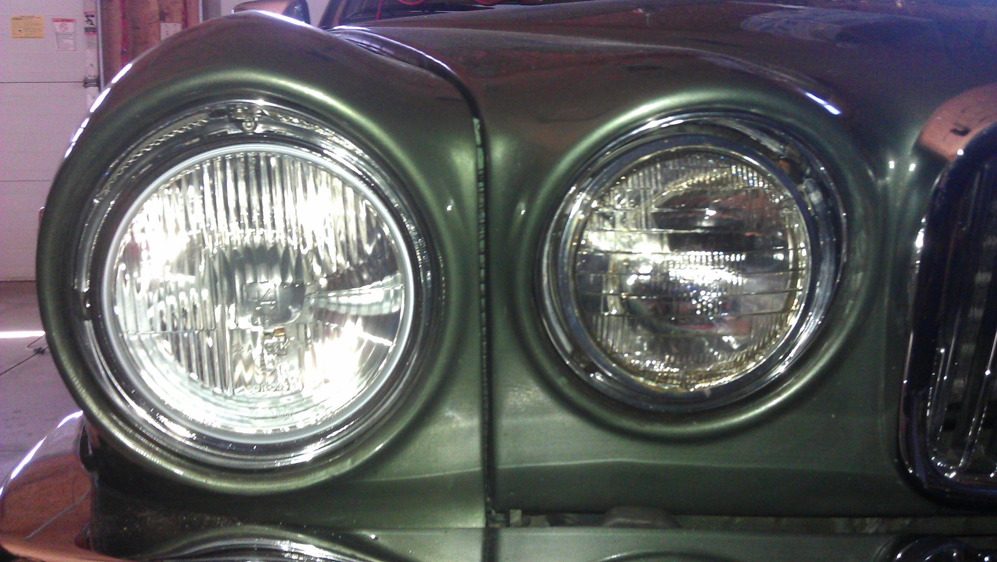

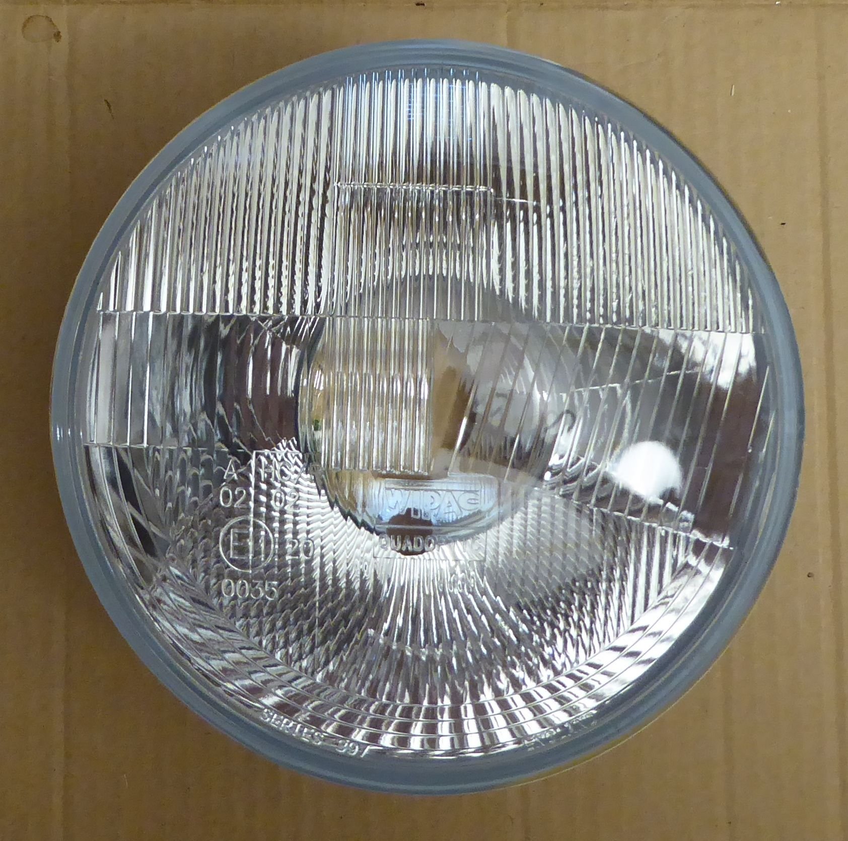

Here's a few pictures I took when converting my 1985 Sovereign ( which came with / still had factory 7" outers ) from replacement regular sealed units back to ones with replaceable H4 main bulbs with city / side / pilot lights ( small 194 bulbs below main bulb ).
I used the WIPAC bulb housings, Hella H4 bulbs, and Orange LED 194 bulbs. The picture with them on is just the "side lights" which look almost like orange/yellow fog lights with the main bulbs off. The previous owner had cut off the side light plugs in the buckets but left the wiring in place. I reconnected the wiring and used the side light plugs that came with the WIPAC housings. The only down side is that the side lights are on anytime the parking lights are on. They look cooler in person, almost like the cat has glowing orange eyes !

This is what I used. Other than slight trimming to allow the spring adjusters to enter the original mounting plate, everything went in smoothly. Plus, they look amazing (I think so anyway), Unless you remove the headlamp, you cannot tell it's not original. I used the headlamp that incorporates what they refer to as a "position" lamp. I call it a Daytime running light (DRL) and use it as such. It's powered by a relay that takes it's signal from the white wire running to the ignition coil, so they are on whenever the engine is running. When the headlamps are selected on, a separate relay interrupts the DRL power and they switch off. Works for me. I found that unless I was running DRL's here in Canada, other drivers just did not see me.
I also had to trim/grind 1/8" off the circumference of the adjusted so it would sit in the7" bucket (that came from some model of Triumph car - I cannot recall, perhaps a TR7) The adjuster is sold as a part for a motorcycle!
