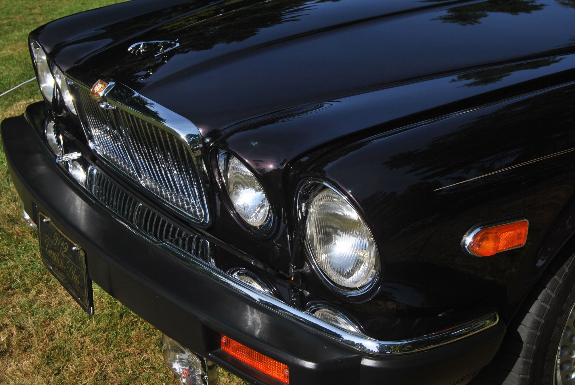

Originally Posted by retroren
if i go with "flat" glass lenses, how would the two outer flat lenses look sitting next to the "curved" inner high beam lenses? wouldn't this mixture of flat and curved produce an unusual look?
Not at all unusual - in fact it is the original and correct factory configuration, shown here on a 1990 V12 Vanden Plas (Canada specification); the flat lens outer (H4 bulb) and domed lens inner lamps (H1 bulb):

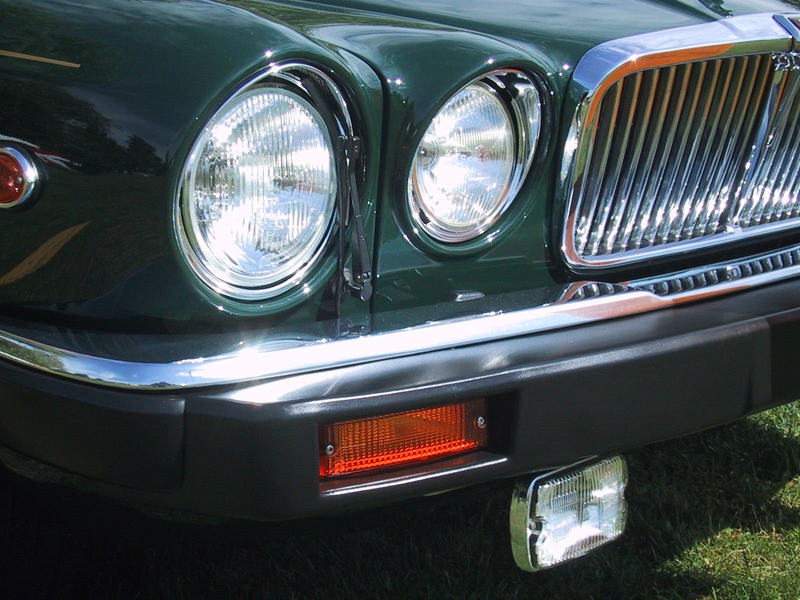

and on the same model, this one being one of the very last 1992 cars:

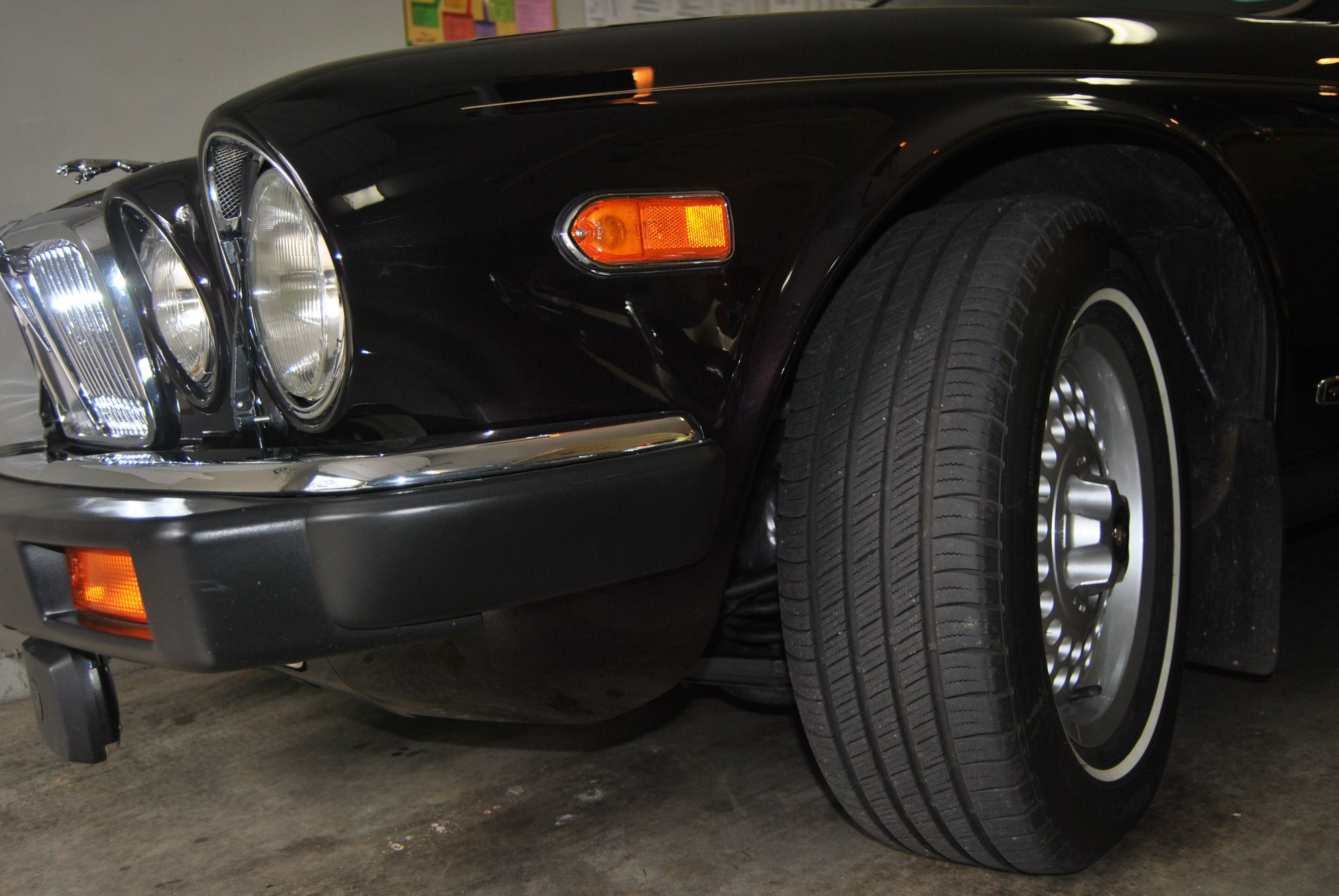

The same car from another angle:
