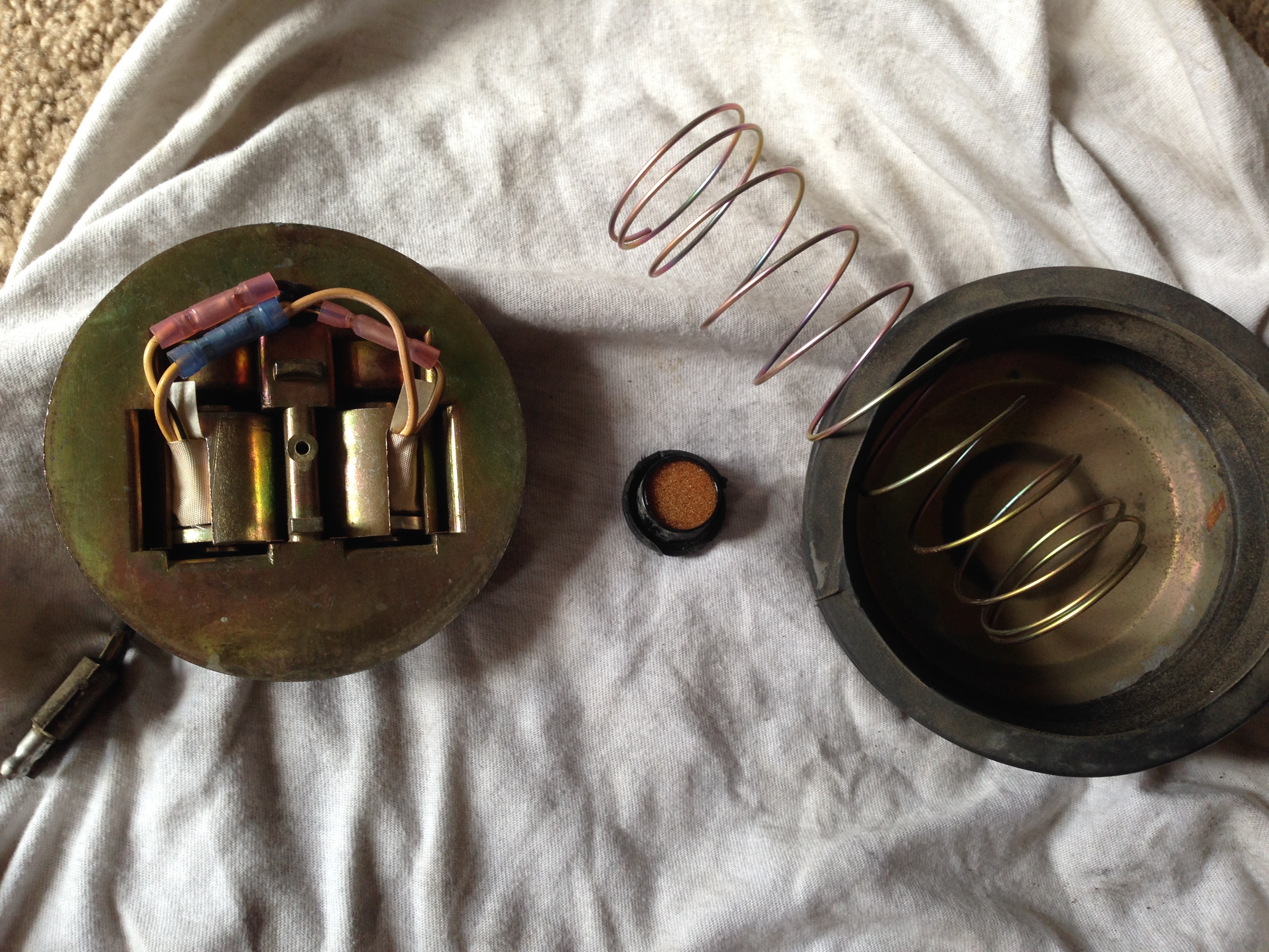

So I'm a bit bored today, decided to try and fix the cruise control. questions...
1. Is this actually the right part?
2. Silicone the bellows? How? Do you even get them out?
