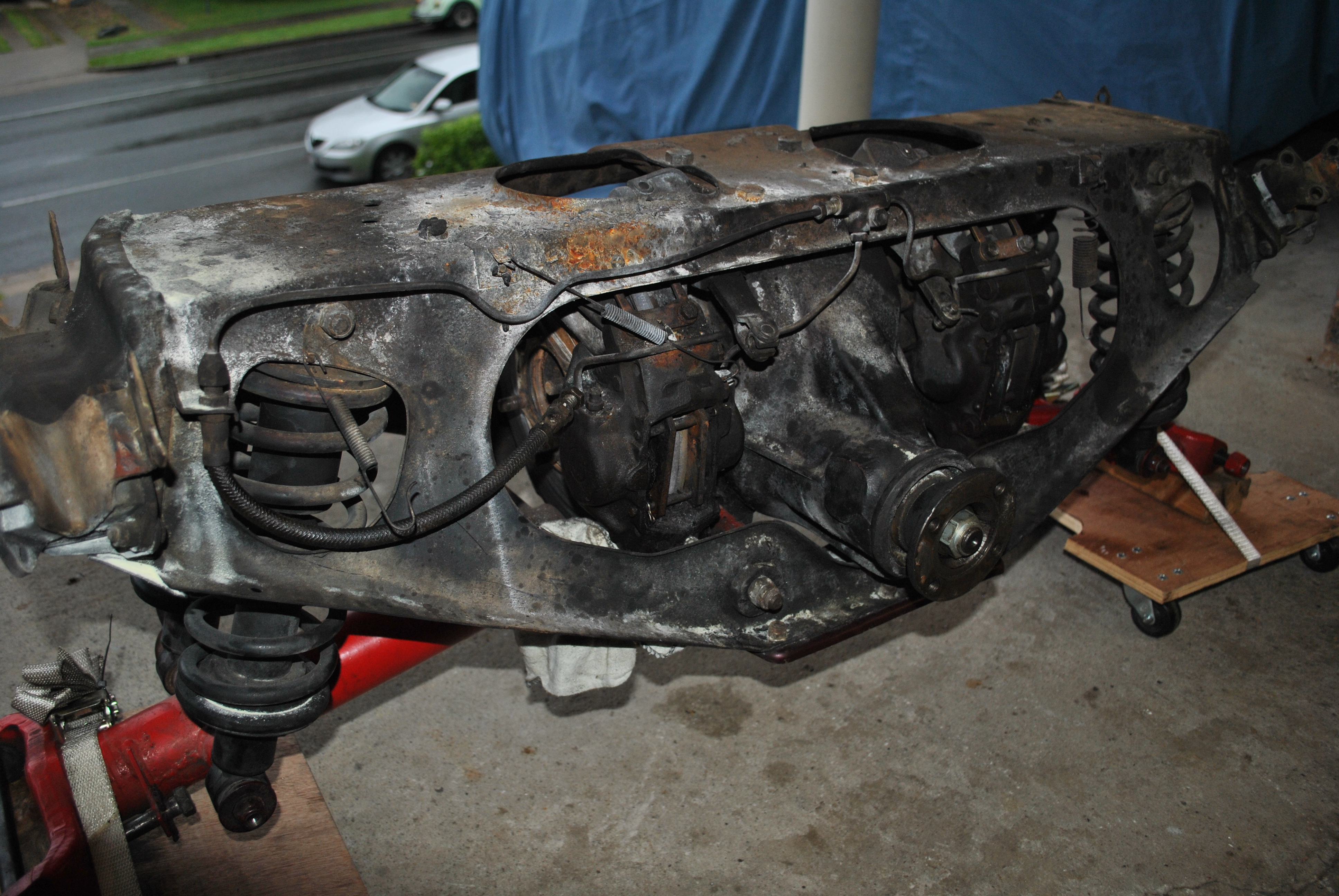

Thursday afternoon when I got home, husband informed me that Friday, since neither of us works that day, we were going to the Wrecking Yard to pick up the IRS under that '83 we found last week, the one I got the Opticell from.

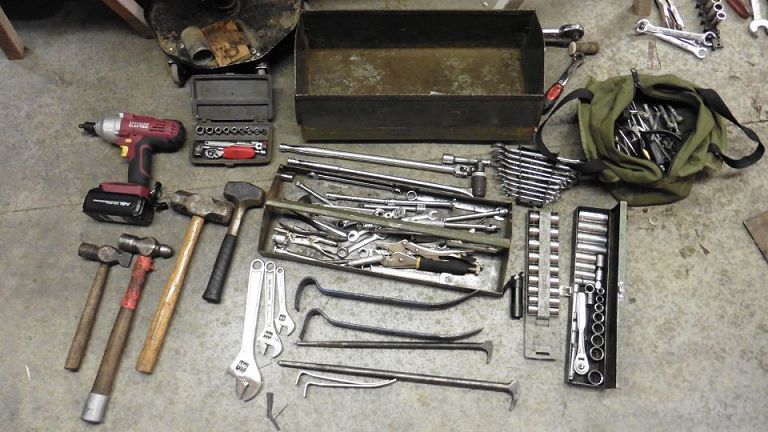

So he made a list of all the tools we could possibly need, which included some Really big hammers, various wrenches, sockets, ratchets, tubing wrenches, everything but a floor jack which the yard won't let people bring in anyway; something about liability if someone dropped a car on themselves.
The weather was Very good in the yard; a nice Delta Breeze was coming up from the South, bringing cool marine air and poofy cotton ball clouds.
There was a good sized square of carpet under the car so husband could work under there in relative comfort. While he did what he had to do, I scanned the cabin again to see if there was Anything I could use. When I opened the glove box door (hadn't done that last time) I discovered a light and switch! The light cover was a little discolored, but not warped, cracked or melted. So I took the whole box and all the mounting screws. This was between running tools for husband, and holding the odd flex handle when he needed 3 hands.
The hardest thing about dropping the unit was getting the exhaust out of it. It would have been easier except that husband forgot to take a hacksaw. It turned out OK though, and we salvaged all the special muffler clamps and the BL mufflers. Resonators will be replaced with glass packs.
I think it was over in JagLovers that I saw mention of this bar to pry the Big Donut bushings off the radius arms. Husband says it was a Great idea and worked Very well.
When the IRS was on the ground under the car, we went back to the desk to ask if someone with a forklift could bring it up for us and load it in the pickup. On the way to the desk, husband told me to do the talking, so I asked if they could use a fork lift to get the IRS up front for us (we deliberately didn't ask beforehand).
Two of the counter staff said it was against company policy and we would have to use their rinky dink little carts. So we took another of said carts and tried to get the unit out from under the car, but no way could we even drag it on the gravel let alone get it on that cart. Even if we had succeeded somehow, the tires on the carts are so underinflated we would Never have got it back to the front.
So we went back to the desk, and I explained what we had and exactly why a fork lift was needed. Still the answer was No, so I said, "OK, then, are you gonna let us take the pickup back there and drag it up with a chain?"
I thought I was asking nicely and respectfully, but also being firm and precise as to why such mechanical help was needed. Then The Boss said to take him out to look at what we had and I agreed. After Boss and I left to check out the situation, one of the staff asked husband, "Is your wife mad?" He said, "No, when she gets focused she's just a little abrupt."
Upon seeing the IRS lying Under the car, The Boss said, "Oh yeah, there's no way. I'll grab a couple of my guys and we'll get that for you". He did just that! And even dropped the thing in the pickup! Nice guy!
As we went away we left them a 12-pack of water, for which they thanked us profusely.

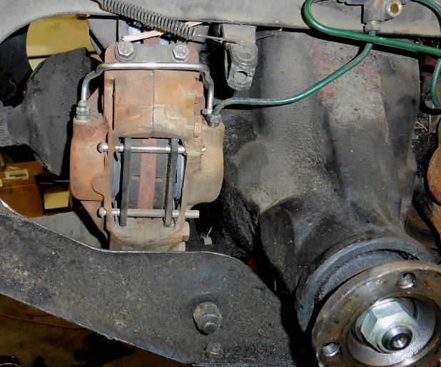

This unit has a Bazillion miles on it. It's dirty and greasy, all except for the calipers which look almost new. They're rusty, but it's a light, new, surface rust, and most of all, they aren't dirty or oily. Now husband has another garage decoration!
The purpose for this is to rebuild it over the winter (if we even have a winter) and when Nix needs new rubber in the rear, just swap this one in.

I particularly like the 4 "persuaders" lined up in the tool kit, conveniently ranging from gentle to mental!

If you cant get it out with that lot its oxy acetylene time

good find, it looks in great condition, even the green brake lines are original, glad you didn't have any accidents, it's a pain to work on gravel without proper support.

Yes, there are *Only* *Four* (4) bolts on each side holding the whole entire rear suspension to the body of these cars!! (You have to take the lower bolt out first so you can get a wrench on the inside of the upper one) The arms are held pretty tightly by the donut bushings, it took a good bit of effort to break them loose, but they don't do much holding the IRS to the car.

The one he found most useful for that job was the one to the right, the "Short Handled Basher." There wasn't much room under the car to swing a hammer so that's the one that beat the mufflers off the pipes.

Just the 8 bolts, tailshaft,handbrake cable, two sectins of exhaust and one brake hose

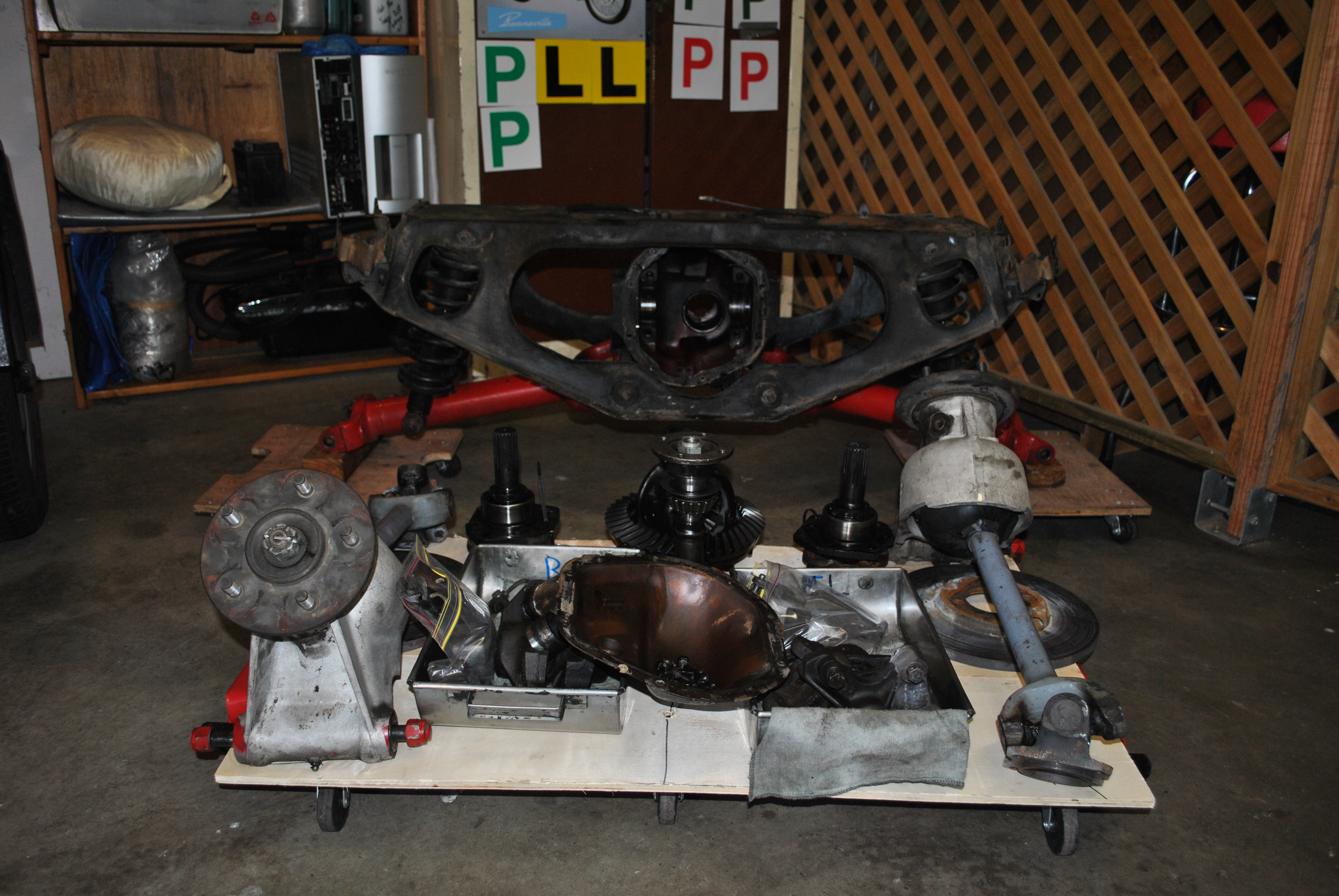

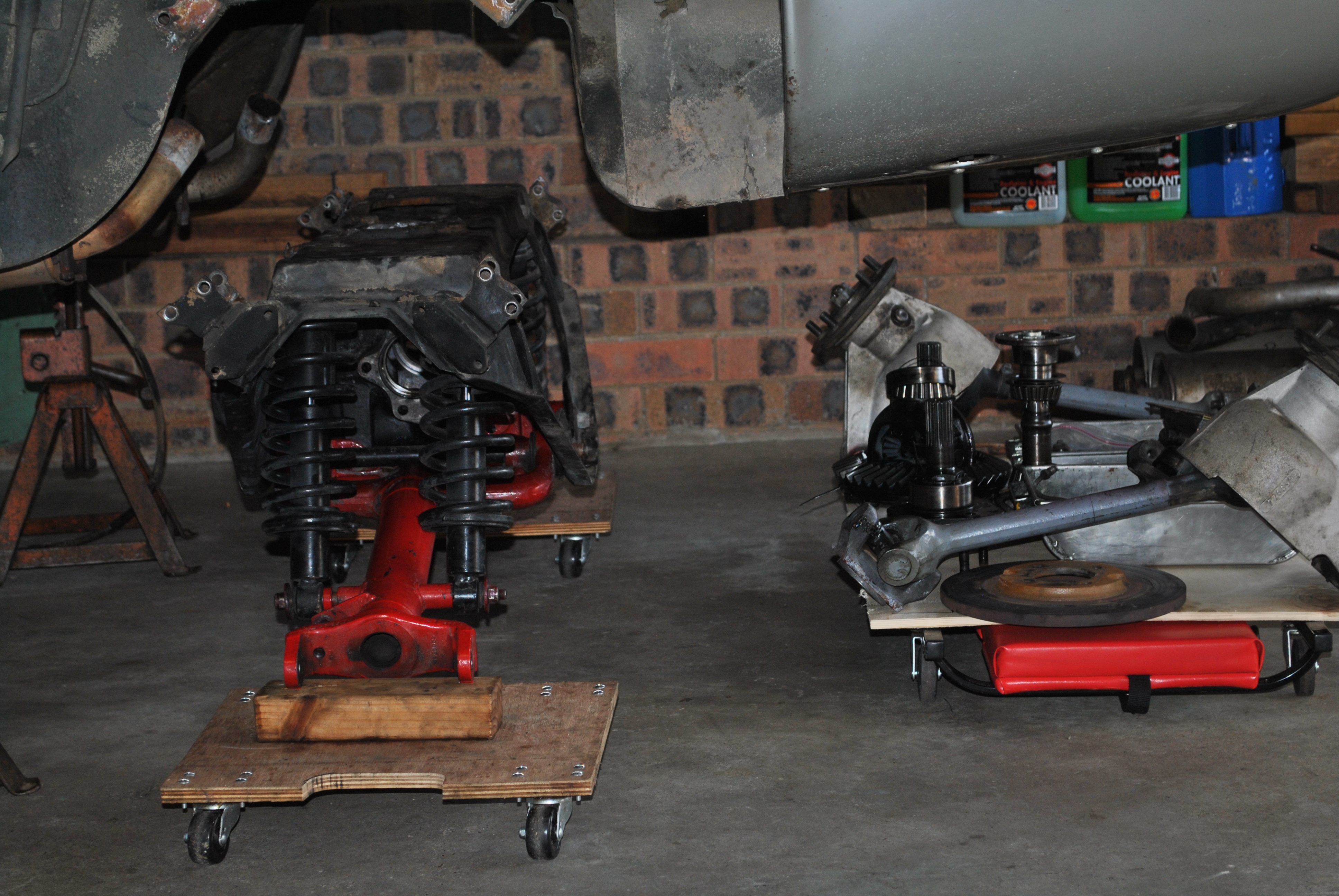

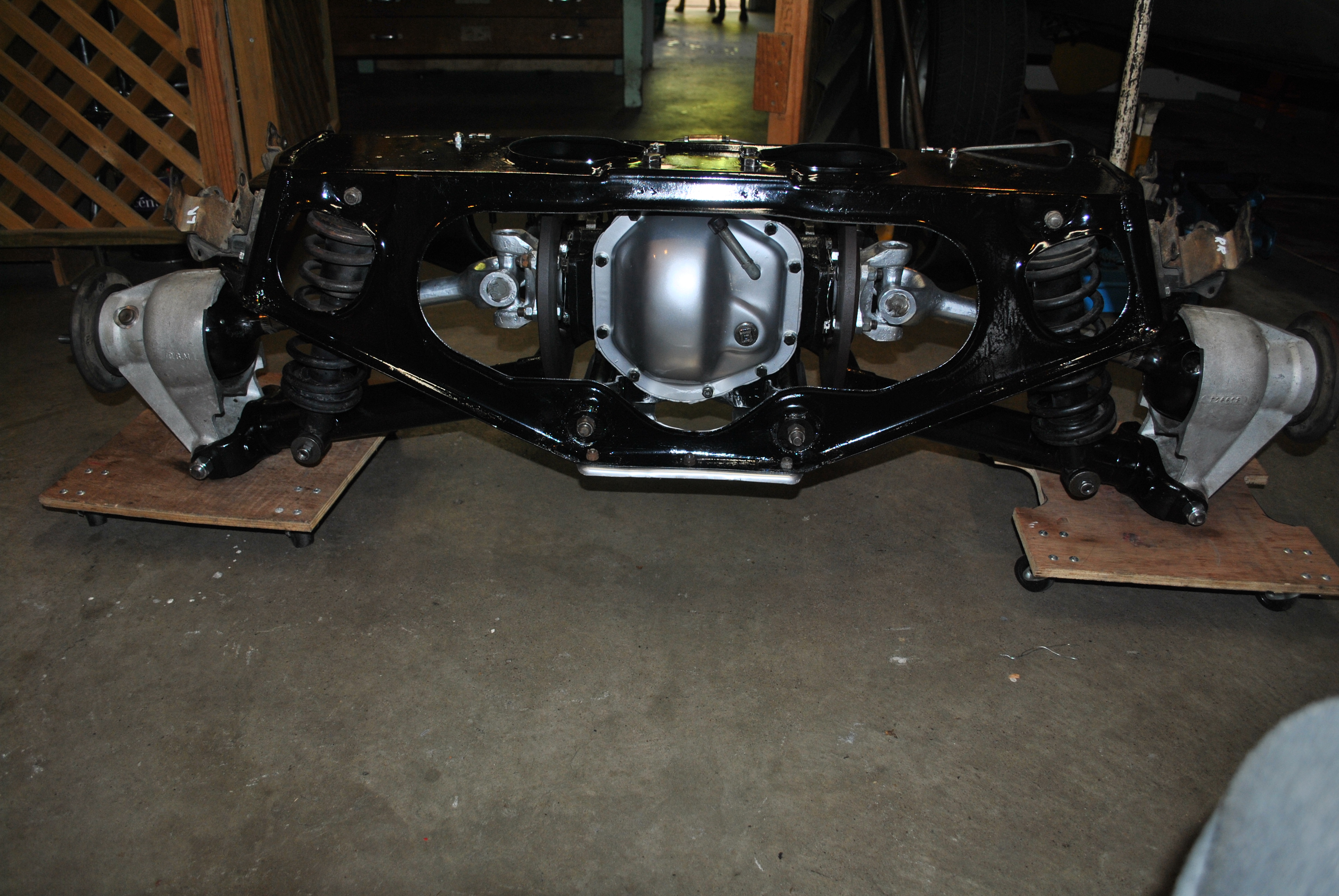

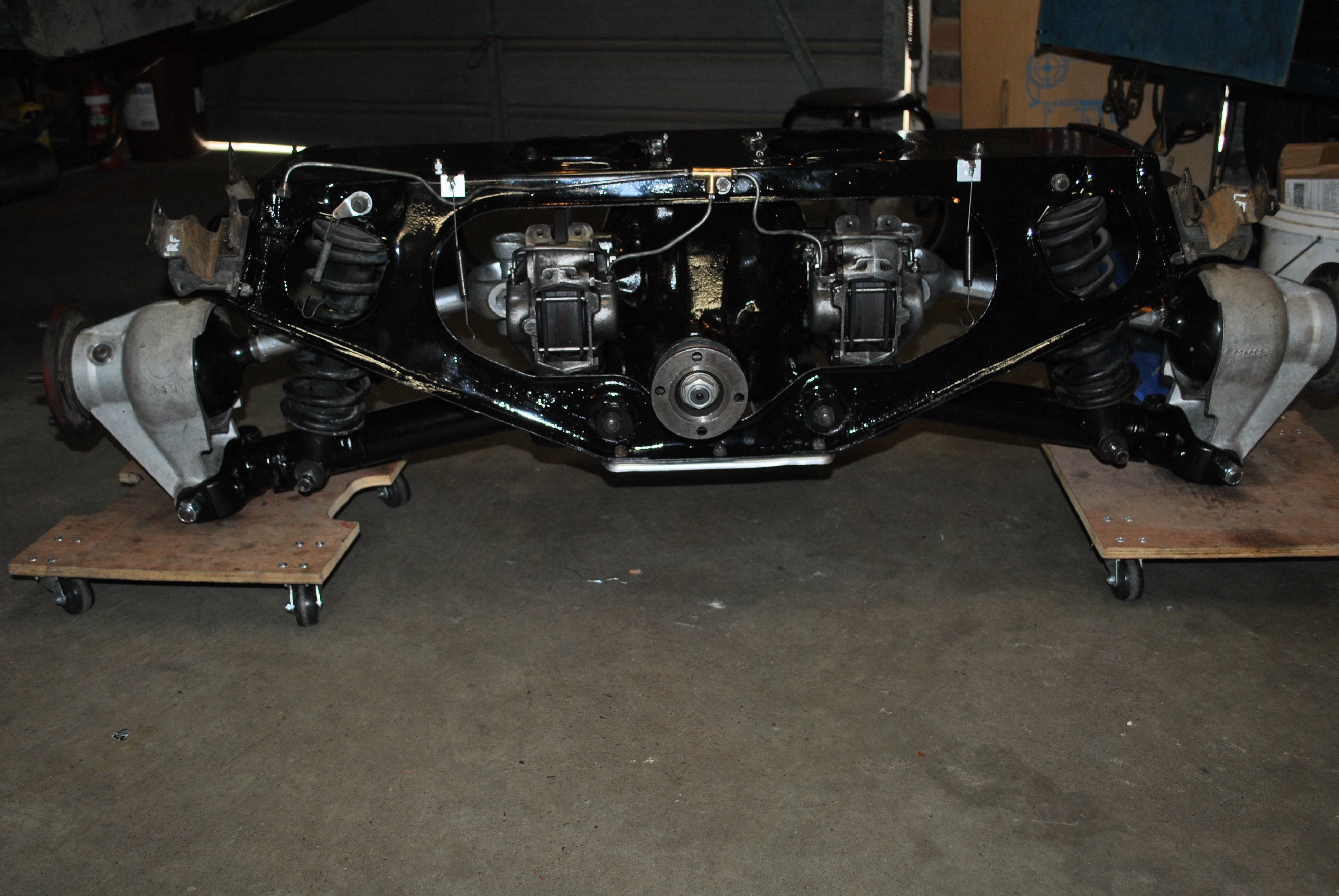

Before
The Junk Yard and the IRS-dsc_8944.jpgThe Junk Yard and the IRS-dsc_8995.jpgThe Junk Yard and the IRS-dsc_8993.jpg
After
The Junk Yard and the IRS-dsc_9269.jpgThe Junk Yard and the IRS-dsc_9272.jpg

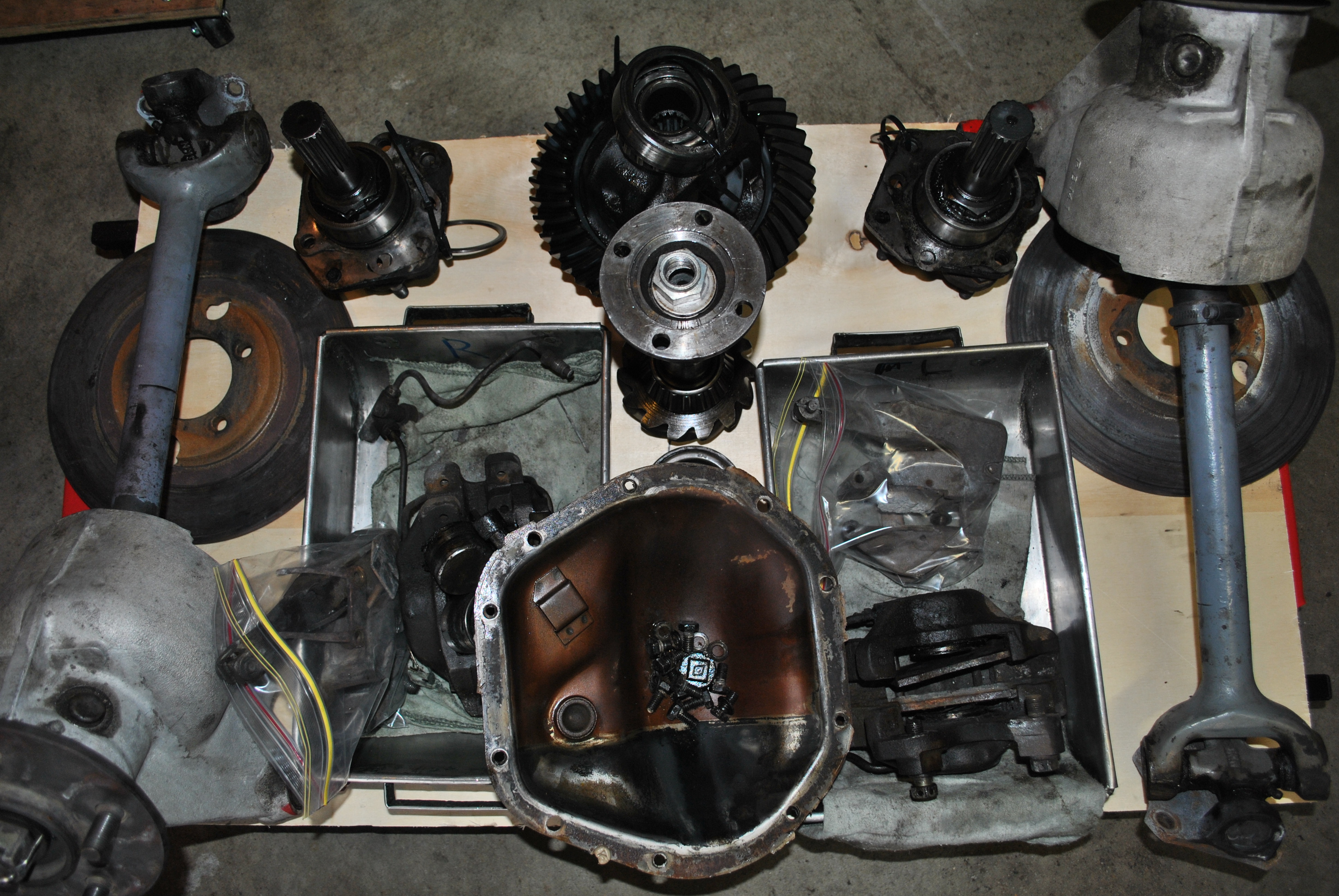

Further inspection of the IRS currently hanging in the shop reveals the bearings are tight, the U-joints are tight, there is little slack in the diff, as seen in pictures, the calipers are New!
Some Bozo jacked it up without a proper board under the tie plate, bending it all up and damaging the drain bung, but that seems to be the only really Bad thing about this. We'll have to change the pipes to the calipers because mine comes from the other side, but that will be easy.
All this has to wait though, because there's no space in the shop at this moment to work on another Large project. Until Winter then.

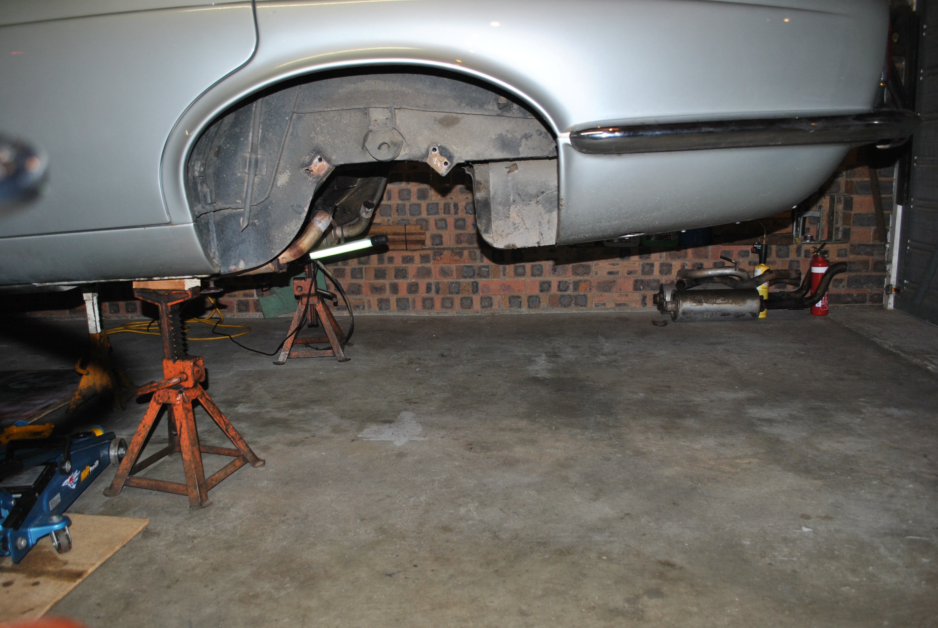

If a floor jack was not allowed, how did you get it on to stands?

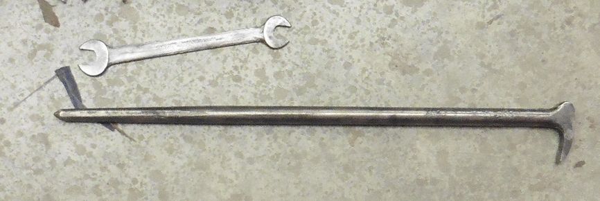

No matter what, one never has enough tools on a task away from the shop! Missing only one, is as good as it gets.
Those are sometimes known as "pinch" bars. fingers, I suppose. The pointed end is useful in getting parts to mate up for the installation of the fasteners. iron workers used them in assembling big beams for bolts or in the old days, hot rivets!!!

Relatively new calipers, pads and even rotors, a definite bonus.

We didn't get it on stands. We had a rear cushion from a Taurus on one end and an unmounted tire on the other end so as not to damage anything by dropping it from that full height onto rocks. And then husband pulled out the last 4 bolts (one of each pair) and let it fall. It did fall with a thud even with all that padding!
The longest bar from the HF set was Just Right. Had it been any longer it wouldn't have cleared under the car, and any shorter wouldn't have given him the leverage needed to pop the bushings.

Woops, wrong car. That is Clark's car securely on stands on firm concrete.

2. That big nut on the pinion sure looks clean. Evidence of work there. Pinion seal perhaps. If the slop is excessive, that might be why.

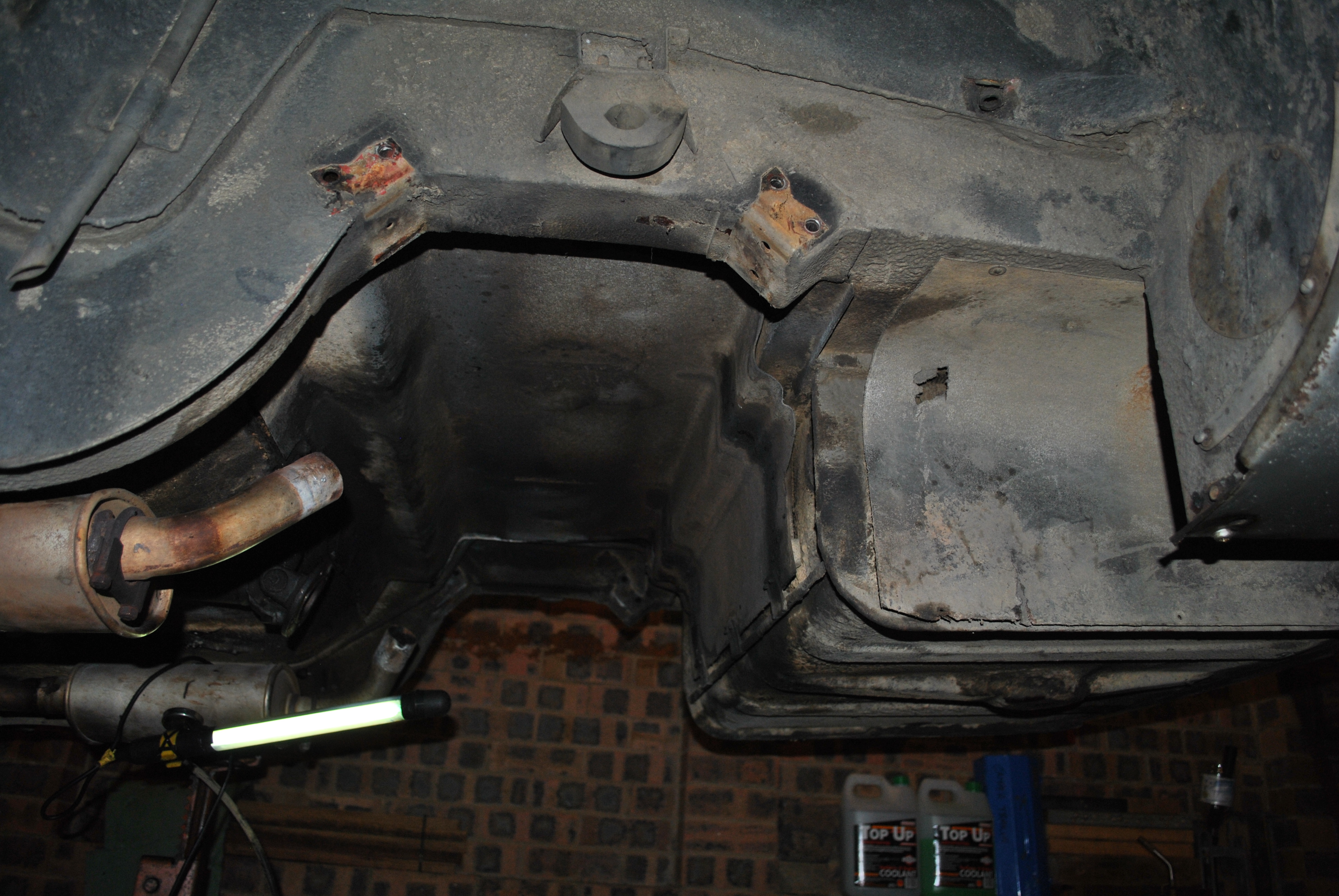

We went back to the yard this afternoon to get the plate and pan under the drive shaft as Nix's is none existent, but only the captive nuts give evidence of what was once there.
The Yard Guys had used the fork lift to first tip the car (her name was Rhonda) on its nose! That certainly gave them more room to chain up the IRS, and gave us Great access to those two pans.

The shields "over" the drive shaft? I wondered about their purpose a decade or so ago. I did clean them up and replaced them. But, I wonder if they are the source of a mystery rattle in my car? If I was doing it now, I might just dump them, as the lumpers of Nix apparently did.

Um, these were Under the drive shaft, sort of lending a false sense of aerodynamic improvement, on a car that's already about as aerodynamic as a brick?! I thought about the possibility of rattling, but that's what Loctite is for.
