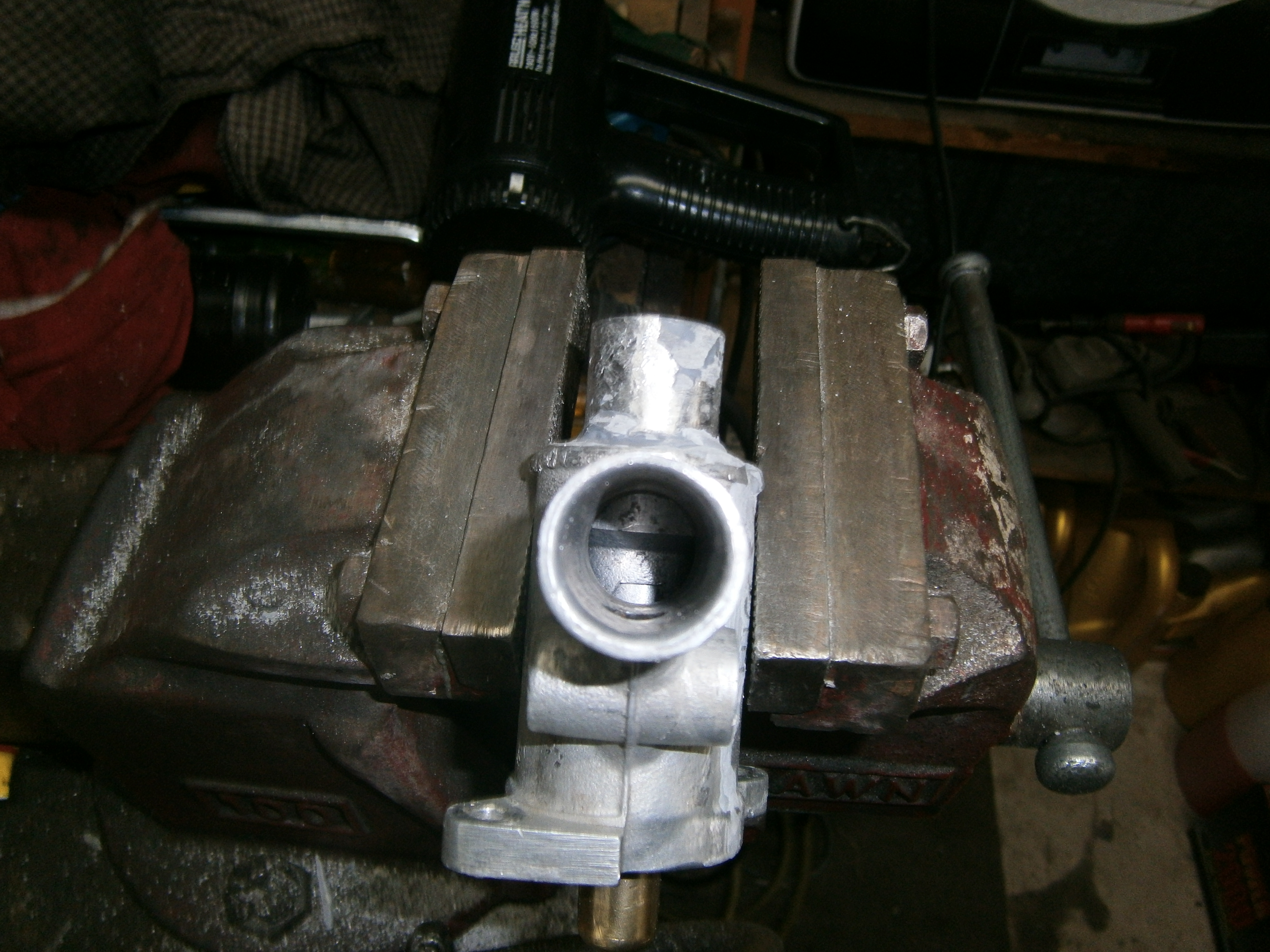

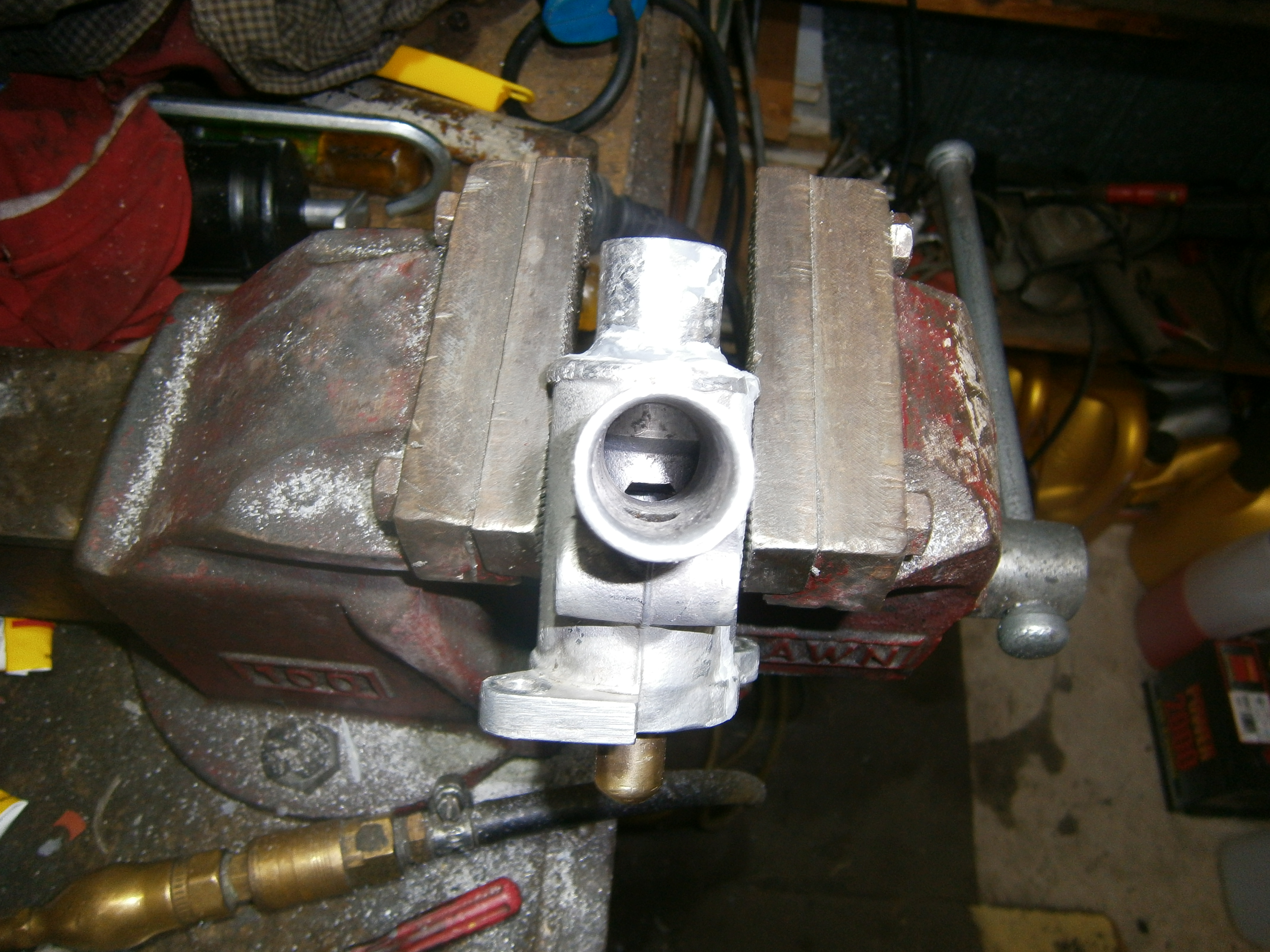

If you are good with mirrors, you can look up the spout when its HOT, and note the slide position.
I am not that good, so I remove them, and its simple.
Cold setting, or hot FAIL.
Hot setting, closed 100%

Thanks fr yr answer Is there no simpler way, measuring pressures?
Disconnecting ATS could indicate a lean condition, if idle gets better, but this is not always due to the AAV beeiing open of coarse.
Old Jul 31, 2016 | 07:51 AM
Posts: 28,829
Likes: 11,287
Nope.
Unless you can actually eyeball that thing closing when at operating temp (hot) any other tuning you may be attempting is a total waste of time.
I have NO idea if the ATS or anything would give any hints. The D Jetronic EFI system is a very basic/dumb system by todays systems standards. It is purely an analogue system. These engines will run quite comfortably with ATs and/or the Throttle Switch unplugged. The HE with P Digital, no way.
They jam regularly, and that is a fact, so I would suggest if it has not been dismantled and freed up in the last 5 years it will not be closing.
Takes about 15 minutes to remove, including the torn skin from that top elbow, and about 25 minutes to reinstall due to the torn skin, AND, the new elbow giving grief. Silicon Spray on the new elbow helps somewhat.

A stumble on acceleration, strange hot running idle due to the obvious vac leak the system is detecting, inability to lower the idle speed with the idle speed adjuster once the engine is AT operating temp, are all symptoms of an AAV having a moment.
ALL that I have been involved with, and there have been too many, have ALL had AAV issues.
Rebuild it, or remove it, is what I do.
It is SIMPLE to rebuild, and time consuming to remove and re-arrange a few things, choice belong you.
IfF idle is lousy, CLEAN the inner bore of both throttle bodies. They get contaminated with "V12 goo" regularly. I clean mine at each oil change.

Hello, If I suspect a failure to be caused by the open AAV when hot, Is it OK to plug the tube from the air filter to the AAV, in order to proof it? How can I do it without harming anything.. type of plug etc?

Doug is corect for the HE, but the PreHE has no hose set up for cap venting, unless it has been retro fitted.
When the engine is Hot, and the AAV is closed, there is still an airbleed via a seperate internal passage to allow for idle speed adjustment. With that Inlet plugged that air bleed no longer exists, and the engine usually stalls.
The PreHE D Jetronic that stumbles off idle is one of a few things.
In NO particular order:
AAV not closing
Throttle switch adjusted incorrectly, they are a PITA to adjust correctly.
MAP sensor is leaking vac, or the internal circuitry is out of range.
Vac enrichment switch is inoperative.
Throttle cross rods are adjusted wrongly, as in 1 throttle opens before the other, causing an imbalance stumble as the engine comes off idle. More noticed on the HE, but it still happens on the older system.
