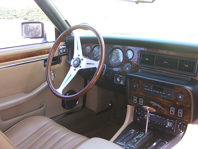

hopefully the photos show up here, with the plastic stick on dash stuff and the one i refinished myself you shuld be able to tell the difference

It really wasnt difficult at all as I got a vdp dash from ebay so when i was done all i had to do was swap the two, it may be a bit more work using your existing dash as you need to remember where everything goes when you are done. Take lots of pics! Basically the wood (even on the old dash that i threw away) was in really good shape, its the clear coat on top that was cracked and faded. Do not try to pick the old varnish off as you stand a chance of pulling up the wood veneer beneath it! All i did was take all the gauges etc out of the dash, sand it back down to the wood then it took a couple of tries to get teh clear coat on properly, first i tried using my compressor and paint pot to spray it on, but its too much velocity and causes wrinkly lines, Sanded that back off (when it was dry) then tried brushing it on, came out ok, but you could see brush marks here and there, in the end i used a small aerosol type sprayer called a preval, and was very happy, i used semi gloss and have since been told it should be gloss, but im very happy with how it is and am not changing it!!!
Good luck!
Darren
P.S. attached is on more pic that actually show the difference between the stick on faux wood and the real thing! the area around the shifter is the sticker thing that looks horrid.
