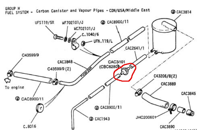

the one you want to deal with is the 1-way check valve located on the passenger side, inner wheel panel.
either remove it entirely and replace it with a straight-through connector between the two hoses, or insert a 1/8" drill bit on one side of the check valve and pull it out the other side. The idea is to rupture the inner membrane which is causing the backup of fuel vapors and creating excessive pressure to build up at the tanks. The problem will dissappear once you do that.

yes, just get a thin drill bit and push it through either side and pull the drill bit through the other side.
to find the 1-way valve that is causing the expansion-contraction of the tanks, all you have to do is look behind the passenger side front tire with a flashlight, if you cannot see it, raise the car with the jack so the front passenger tire goes down, then you will see it on the inner wall;
simply disconnect the check valve from the rubber hoses. Observe that one hose is wider than the other, it only goes back one way.
