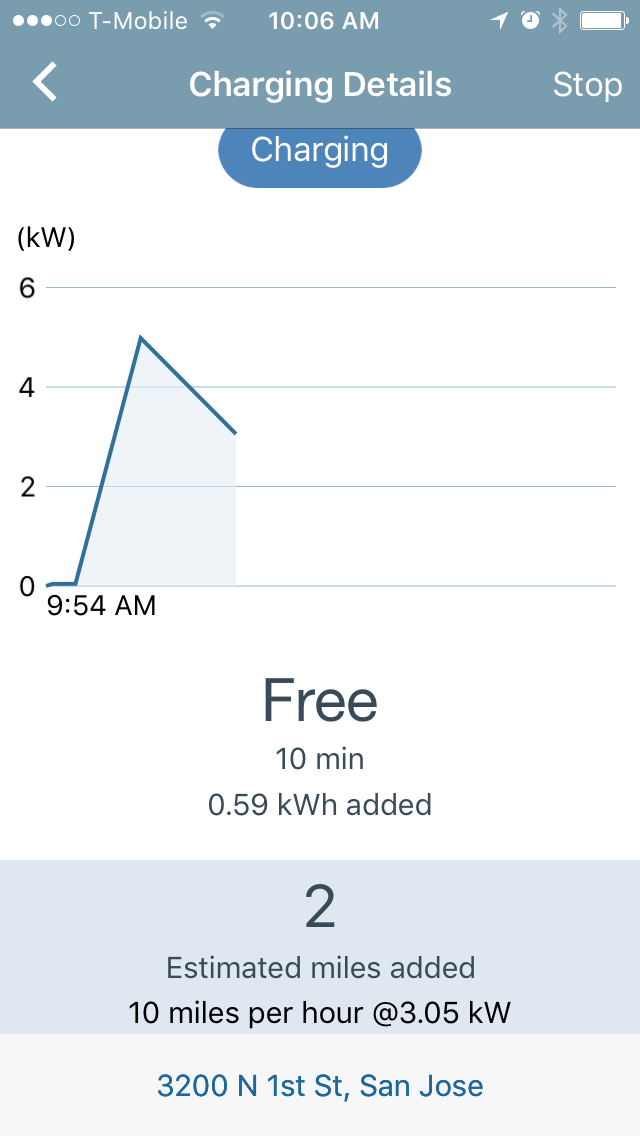

Thanks guys! Currently charging at the office

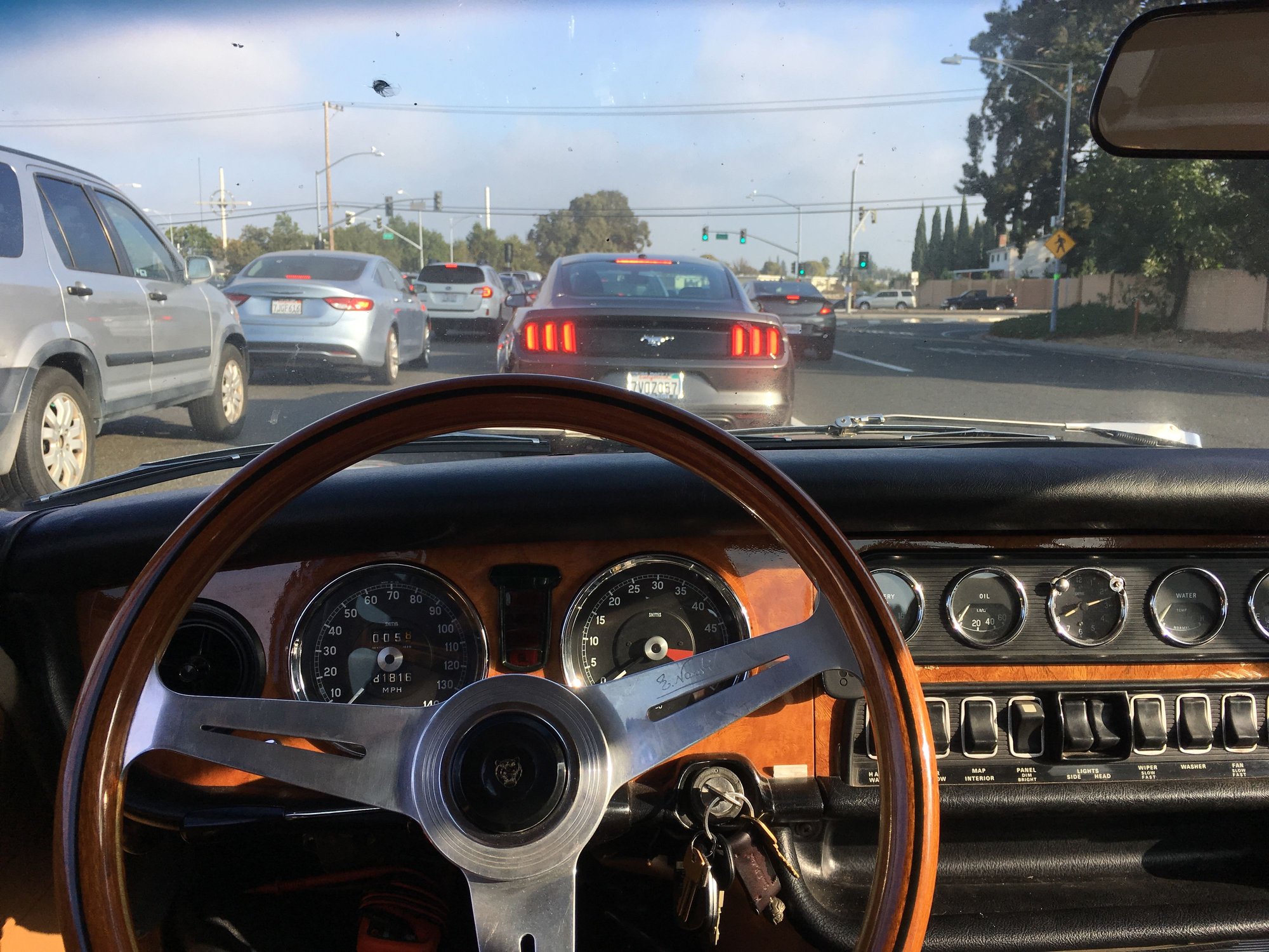

A bit odd to see the car moving right along, but the tach and speedo needles at rest.

Speedo is working.. look closely when the street in front of the car is shown...

My tach-ammeter is having some trouble, but don't worry it'll be operational real soon as Roger said, the speedo (original!) works a treat with the speed hut GPS driver

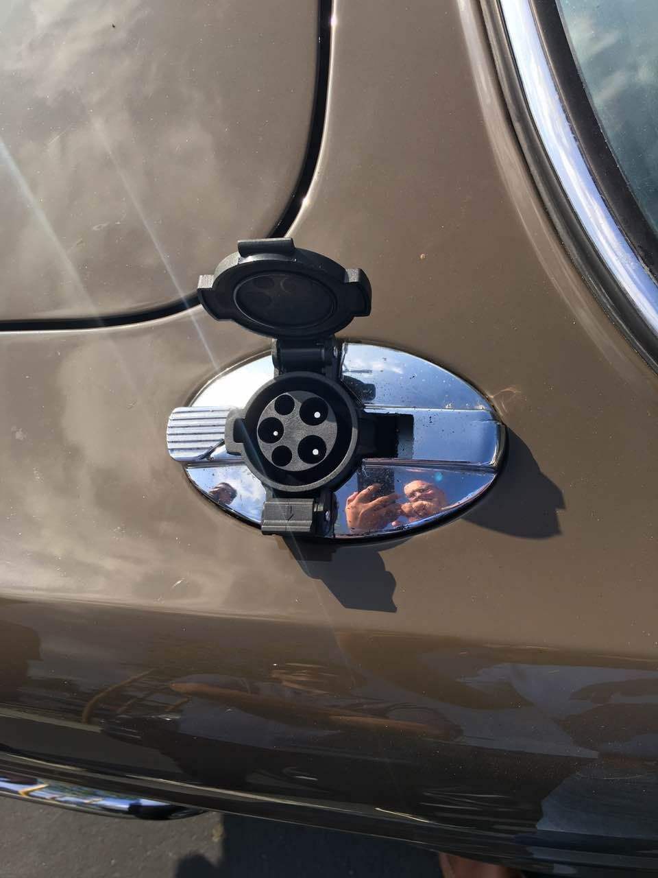

I'm seeing some 3d printed custom fuel/charge port doors...

Slick, not being picky as to the speedo needle. I see it, now. GPS interface insures super accuracy, whatever the gears or tire sizes. The future for all critters?

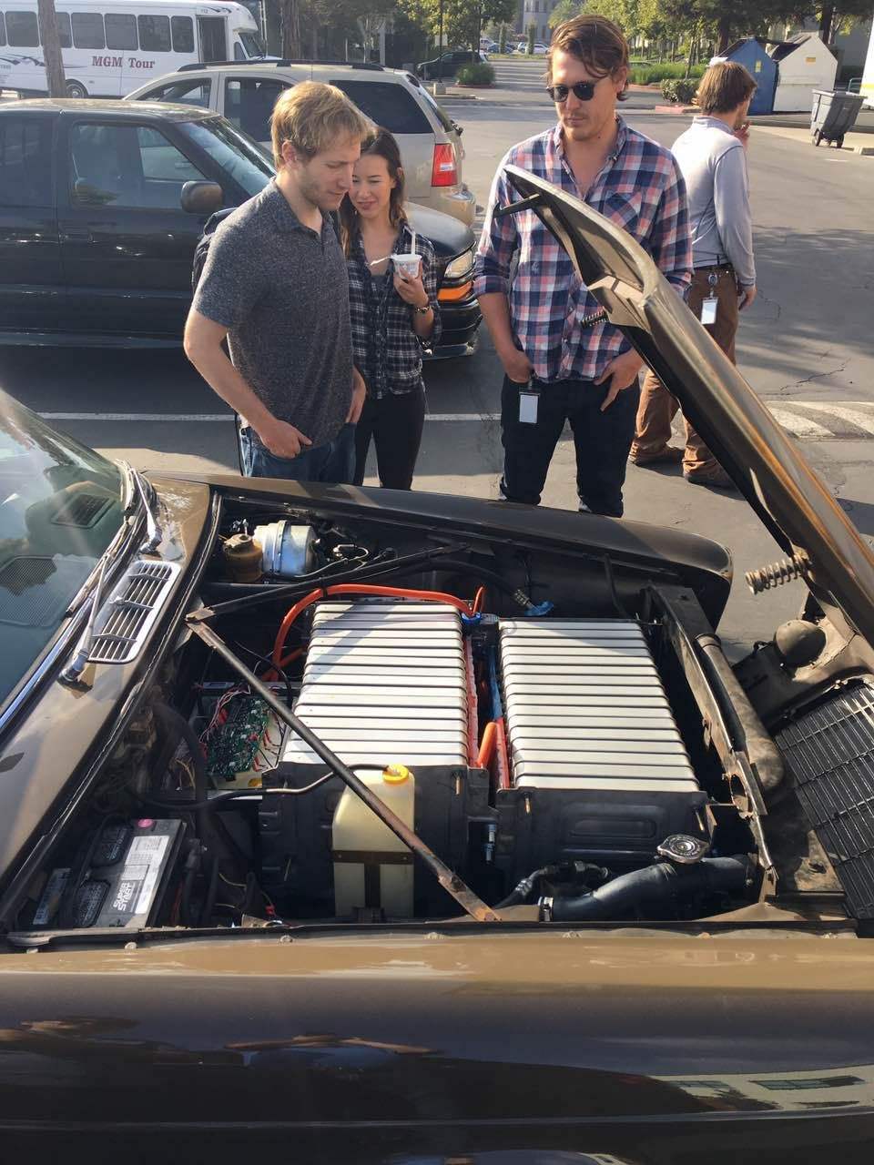

Bonnett open. Surprise ! And clear admiration.
Carl

Rides available once I get the startup from stop sorted out smoothly!
Carl, funny I did the exact same when the jag had the ICE. My speedo drive had busted somewhere shortly before I pulled the engine and I used the tach to estimate speed on the road. Now I have a speedo and no tach!
