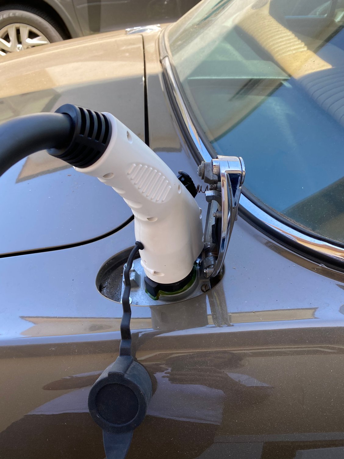

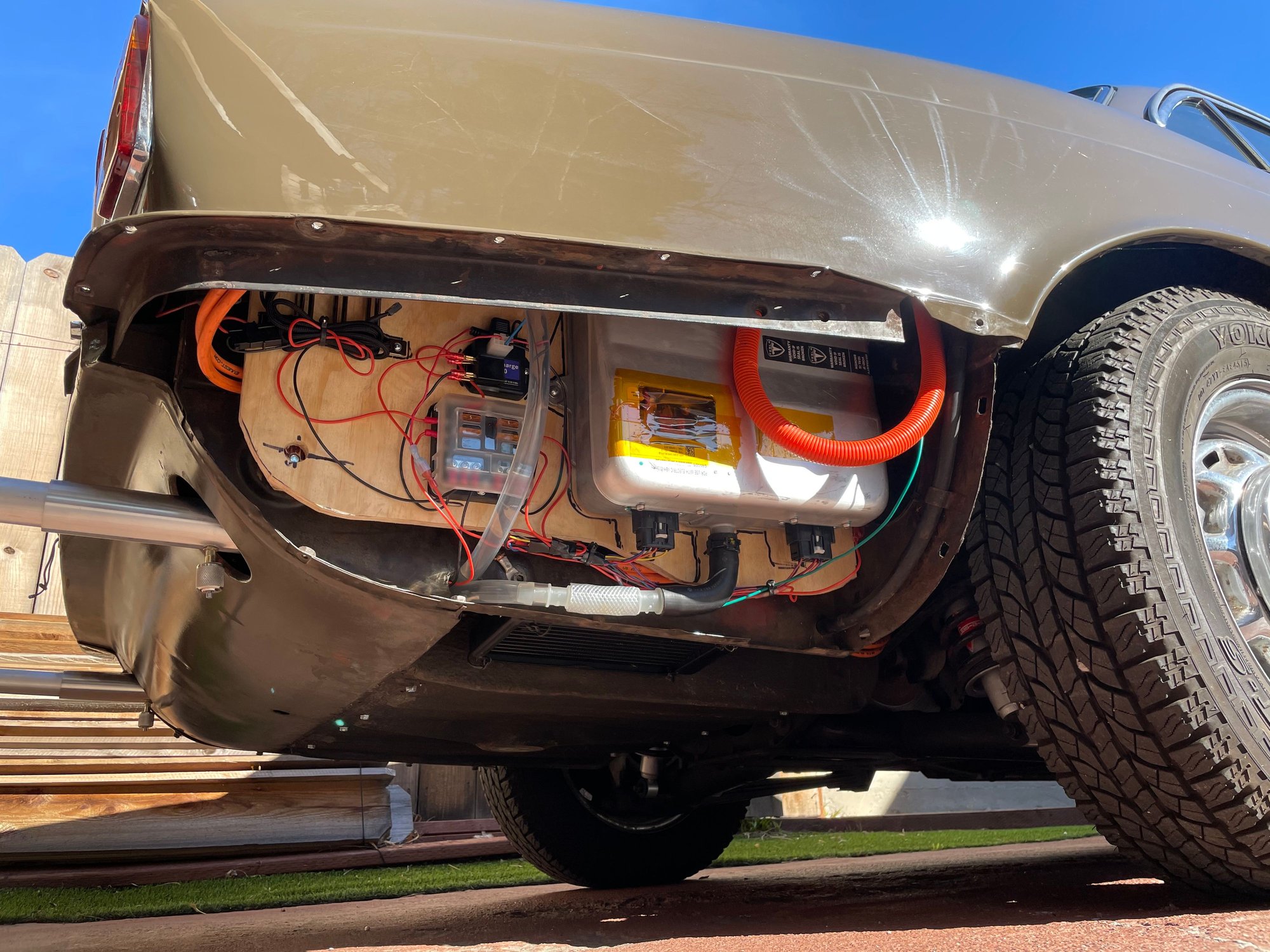

Well, I haven’t been super great about updating this thread, but I thought you all might be interested in seeing my fake tailpipe bike rack
I’m daily driving the car these days and it’s got 200-240 miles of useable range, depending on speeds mostly. The vast majority of my time has been spent in writing/improving the software for the motor controller, and fixing little things like re-keying locks to match, adding trunk struts, making the gauges work reliably, etc. I’ve also designed a drop-in electric replacement for the original heater core that needs to be installed, and I picked up a Tesla AC compressor that needs to be final installed and plumbed. And I still haven’t put my new carpets in that I bought three years ago -_- will do those when I do the heater core.

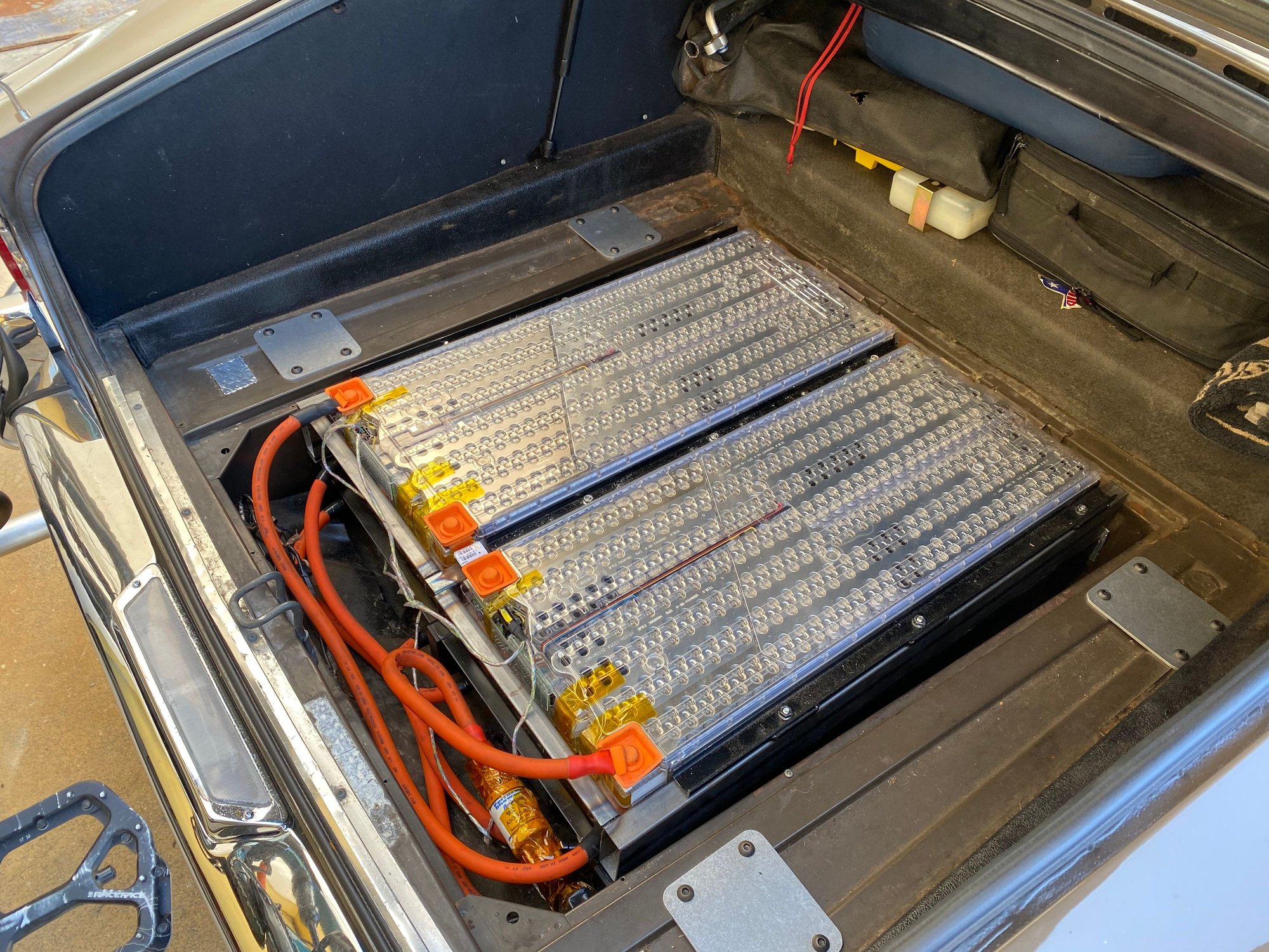

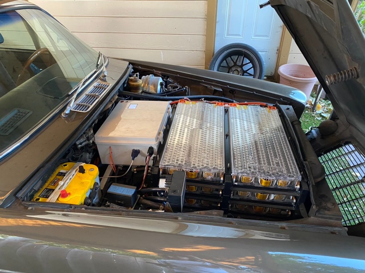

Looks like I also forgot to mention that it has a Tesla model S 60 pack and DC/DC converter as of the past year or so
10 modules under the hood, 4 in the spare tire well. It’s just barely overweight up front and underweight in rear, judging roughly by suspension sag on level ground. Happy with it though!

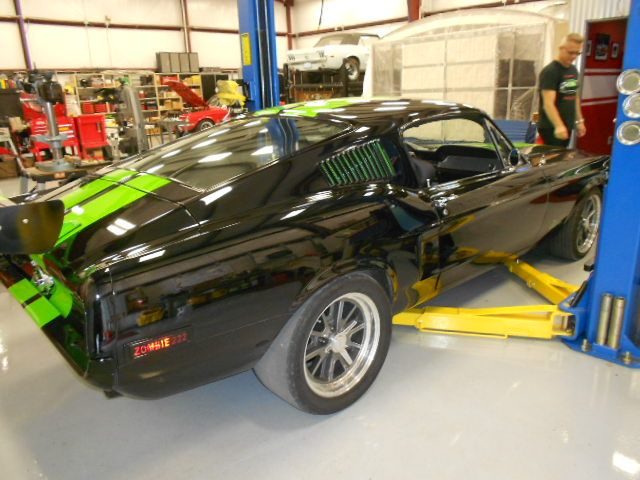

and NICE work , 100% different than this site sees!
a friend has this old Mustang ,you may have seen!
pix about 4/5 yrs ago, Austin tx. 0-60 in 1.95 sec.

This weekend I picked up 3 more Tesla modules to make a total of 17. This will let me run a slightly higher voltage than the model S/X at almost 430V.
Tonight I installed the first additional one under the hood, making a total of 11 in the engine bay, wired it up and took it for a test drive. Works great, as the original brackets were designed with this expansion as an option (clears the hood).
More material is on order to build up mounts for the additional two in the rear, hopefully in time for fabrication and installation this weekend.

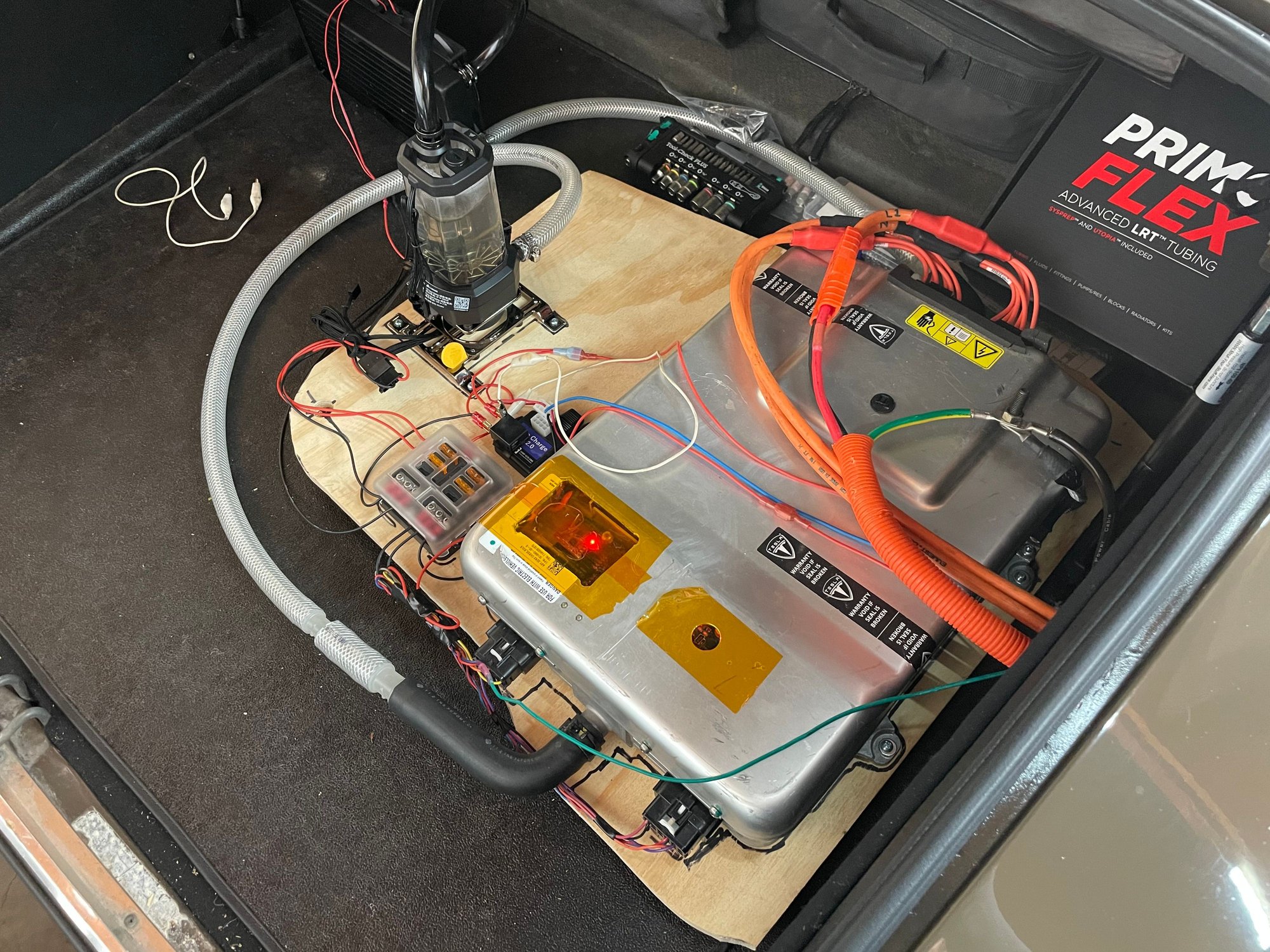

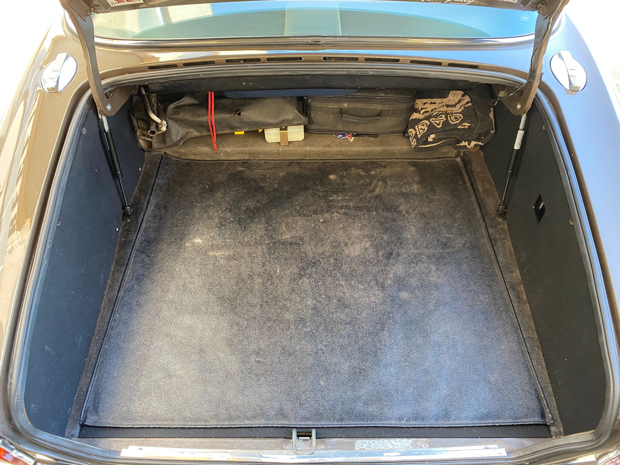

The last two went in over the weekend, I had to raise the trunk floor about an inch and a quarter to get them to fit. I’ve done almost 100 miles, mostly on my daily commute, and the data is telling me I’ll get 320 miles of range with this type of driving. Less is expected from highway driving, so I’m estimating somewhere around 280. Overall I’m super happy with it now, but there is still more to do, as ever.

Lots of work has been going on since I last posted, mostly trying to resolve some software issues when starting smoothly from a stop. Ultimately I've decided that I'll be going to a different motor setup - utilizing a lexus 'transmission' (two electric motors inside) with a locked input shaft as a replacement for my homemade setup. This should be more reliable and will let me give it the beans from a stop.

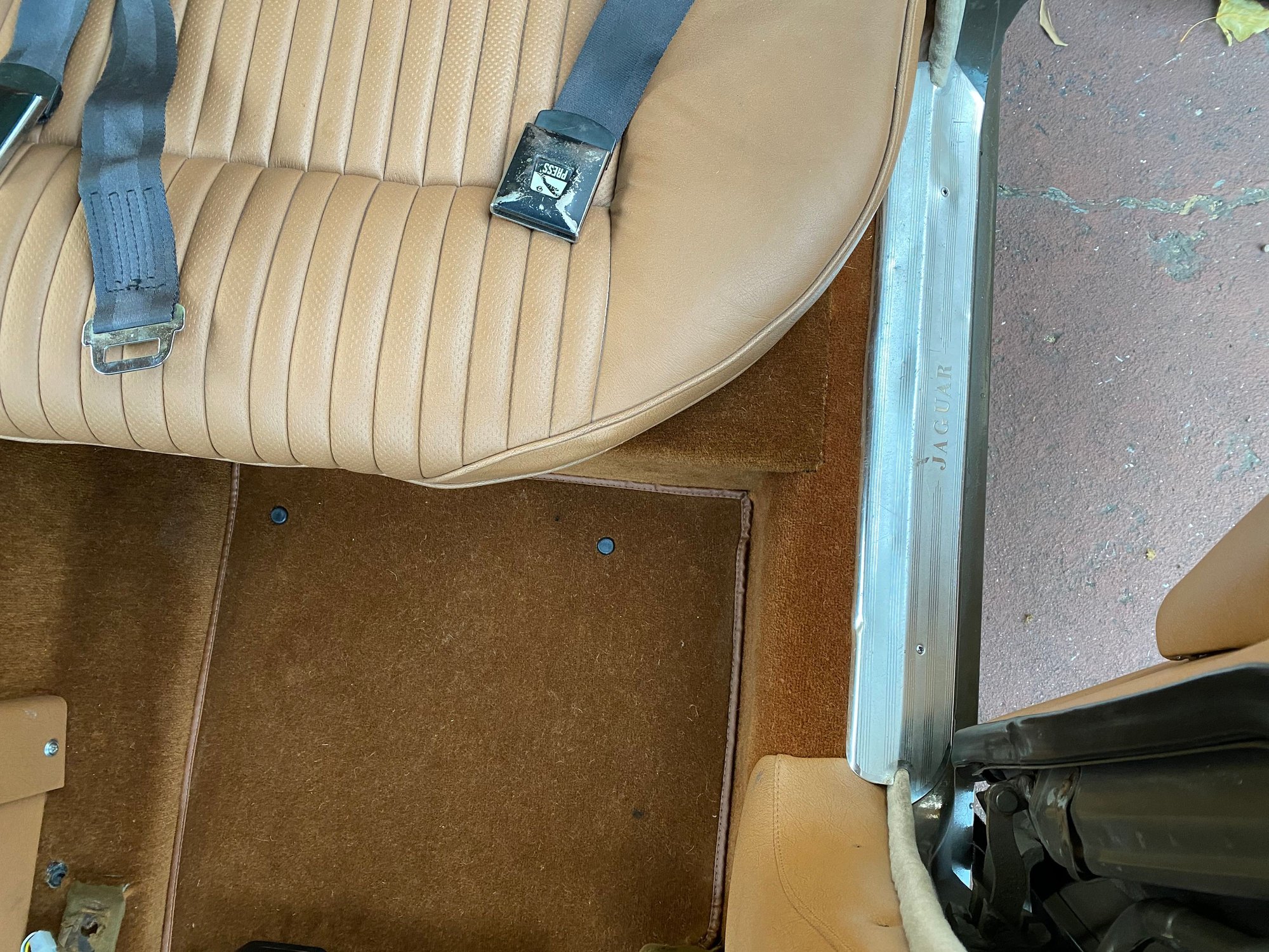

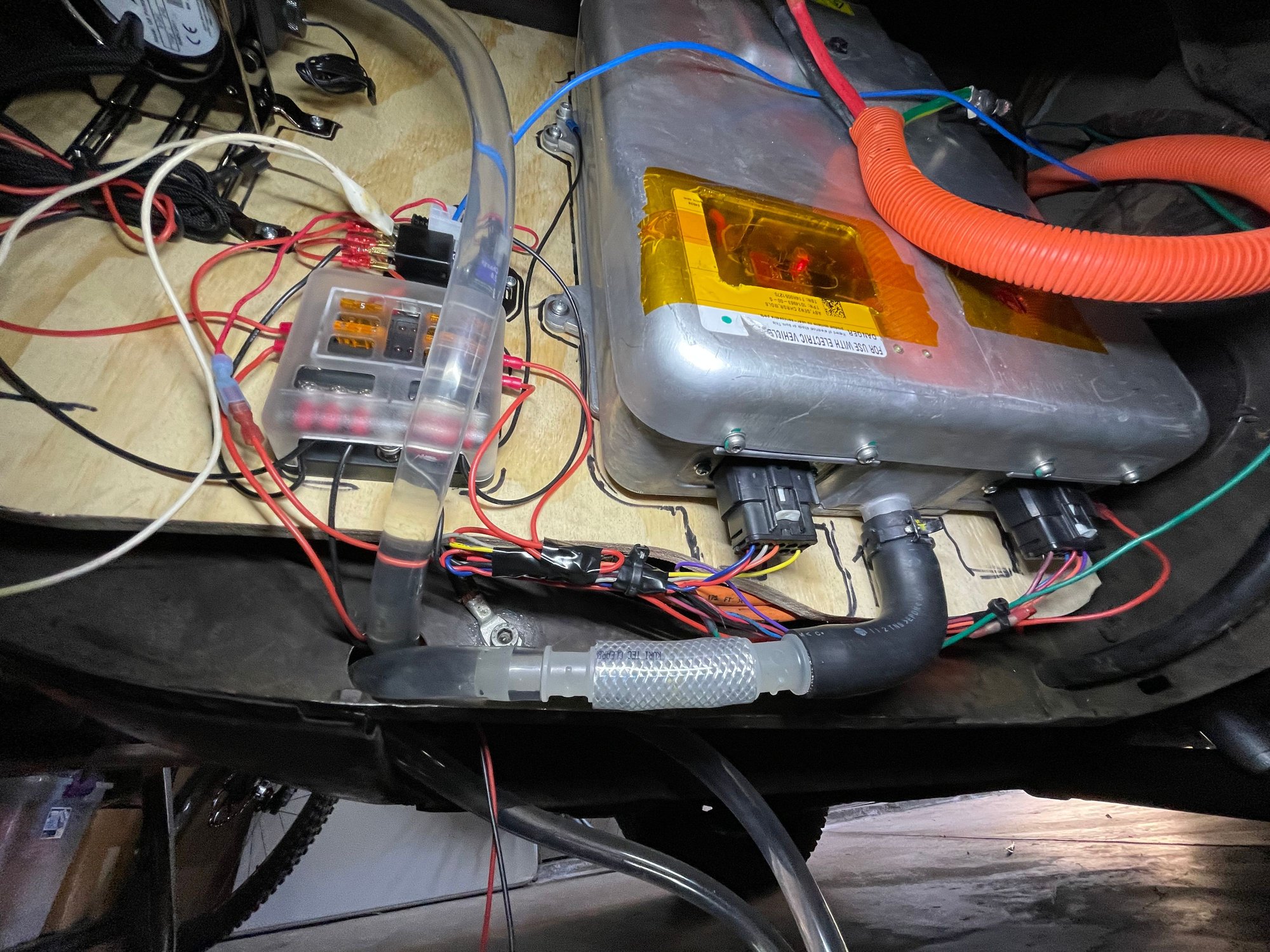

In the last 9 months, I did get a chance to finish the trunk floor, do most of the carpeting, and replace my AC/DC charger with a Tesla unit that does 11kW. Seen below..
