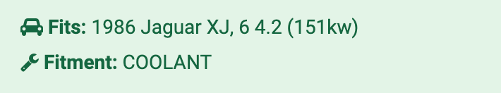

When looking for parts, I see this and I am not sure if my car is 151kw or 133kw. I just wondered if there was a way to find out this information?
