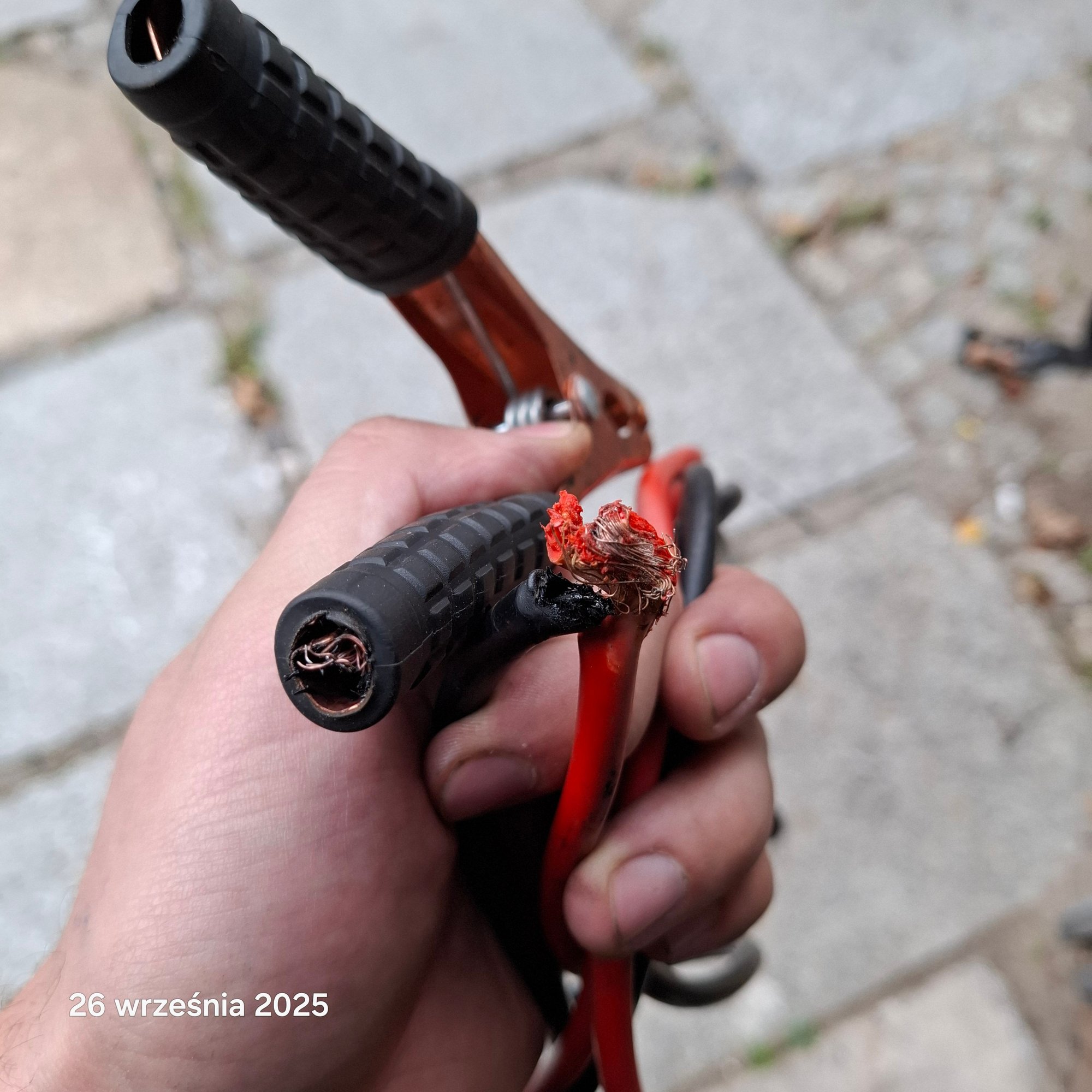

I connected the negative battery to the engine. The first attempt was the same. I also connected the positive battery to the starter. The second attempt, my jumper cables were made in China and melted, haha. I'll buy some decent jumper cables and try again. I'm typing this through a translator, sorry for any mistakes

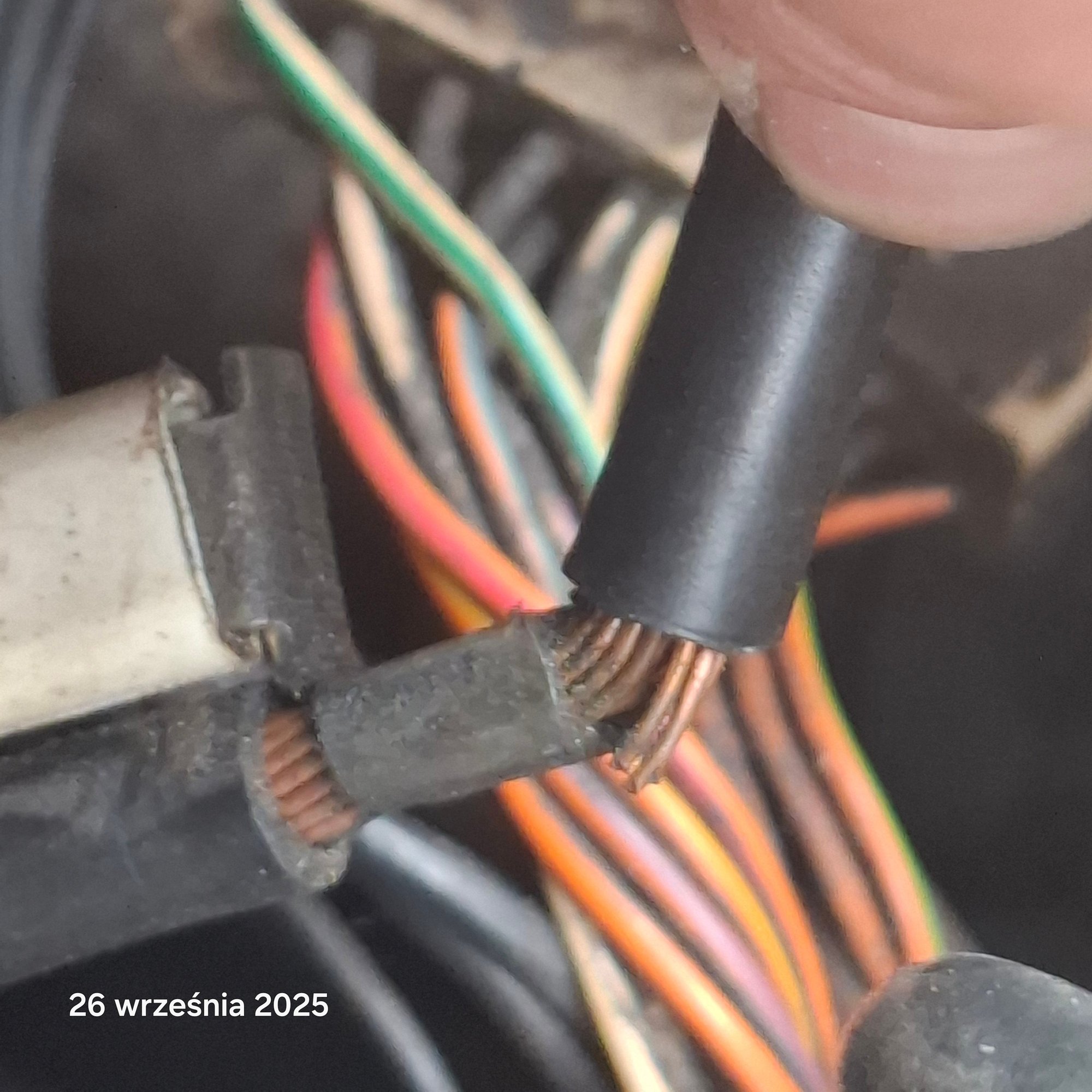

Hi, the socket/ spanner size to turn the crankshaft pulley is 3/4 Whitworth, either the starter motor is jammed or you have an electrical fault to melt the cable like that . The starter motor has a permanent 12volt supply and its the momentary activation of the starter solenoid ( red /white wire) that engages the starter. Might be easier just to remove the starter and test it? Again good luck!

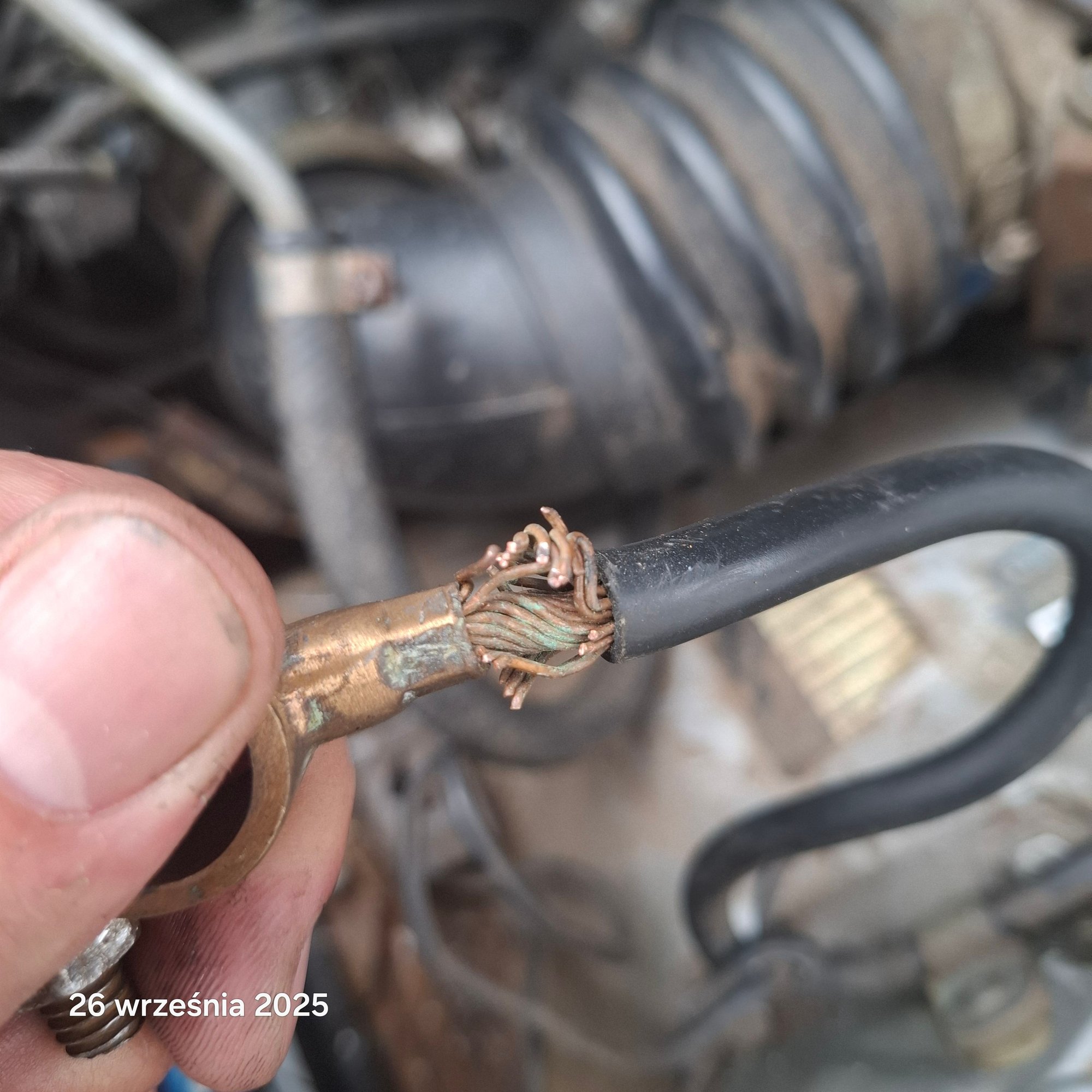

The starter is the second one installed. I think it's the cables, so I'll start by replacing that.

I think there is also a ground cable underneath, from a starter mount bolt to the frame. It's important and may be a contributor. Others may confirm this?

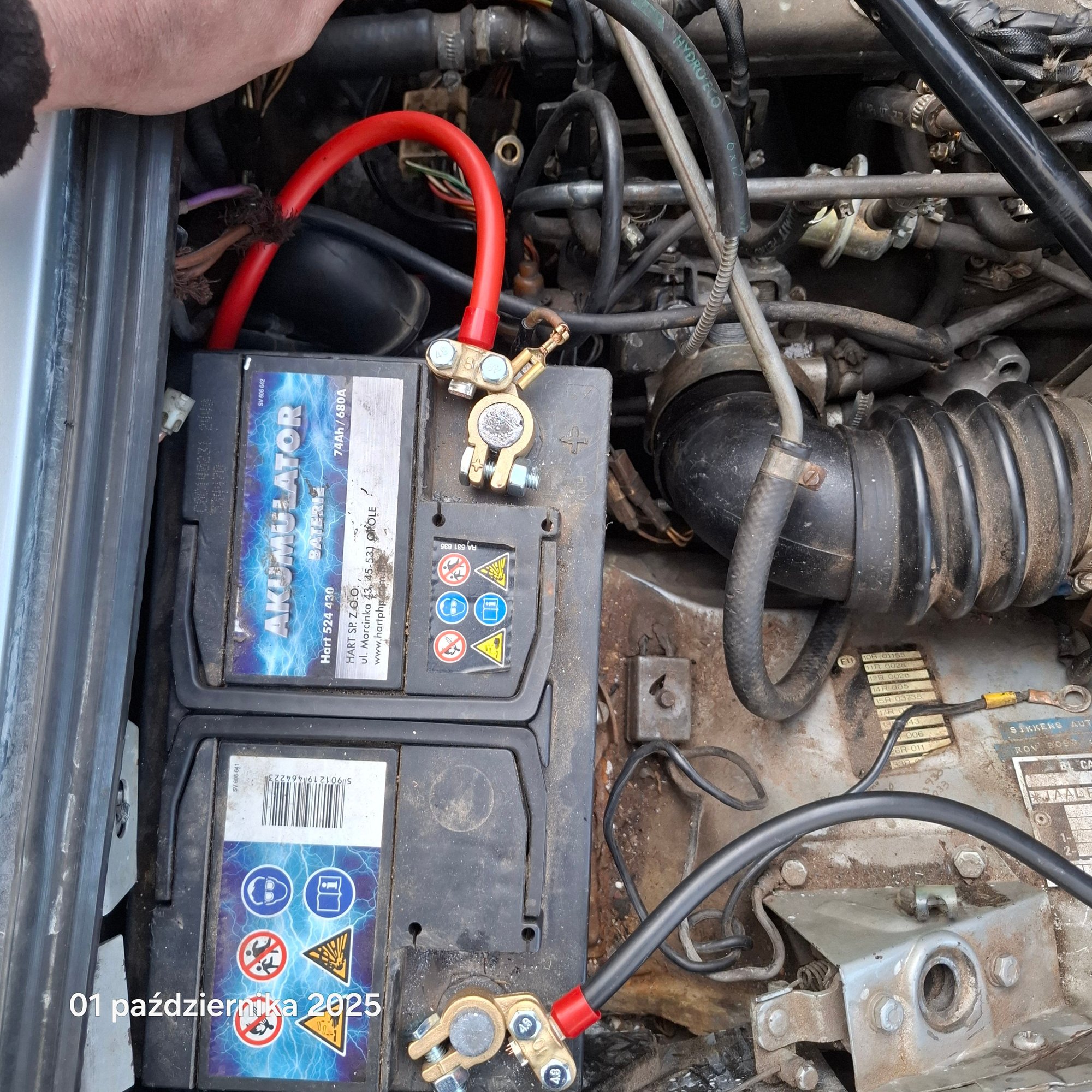

I replaced the positive and negative battery cables and the starter cable. The engine won't crank. I hear a metallic sound when starting the engine.
