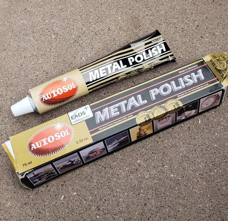

Helko all!
Just my quick impression of a product i bumped into.
I was looking at my tips (nudge nudge wink wink) and wondered what would be best to get rid of the dark brown left over from heat look.
I tried Eagle One but that didn't seem to do much. Great for the Nardi Wheel but not for stainless steel maybe?
Looking through some motorbike threads from the UK some fellas mentioned Autosol. Its a cream made by a German manufacturer i believe. And its for all metal, including chrome. Although I have not tested it on my chrome as of yet and still use Lemon Pledge.
Anyway. Ordered from Amazon as none of the auto stores have it or even knew what it was.
After talking to a guy in the uk he also suggested a method to clean the pipes up.

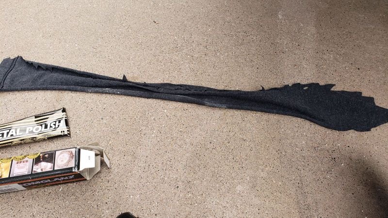

He suggested tearing a long strip of a cotton t-shirt. Preferably a t-shirt with some give. Then wrap around the pipe and apply some cream to pipe or strip of cotton. As the strip is somewhat wrapped around the pipe you can tug on either end and create a rotation that cleans all around the pipe while spreading the cream.
I have to say it works a treat! Pretty much all gone. I would say 99% clean and with very little effort. I would say make sure you have a decent speed on the pull and pull technique. I will have to give it another once over to get it 100%
Pics attached.
I was pretty pleased with the results and completely forgot to do a before and after. So I will post an after shoot once back home. Yes. I am a muppet.
Excuse the basic images
Cheers!

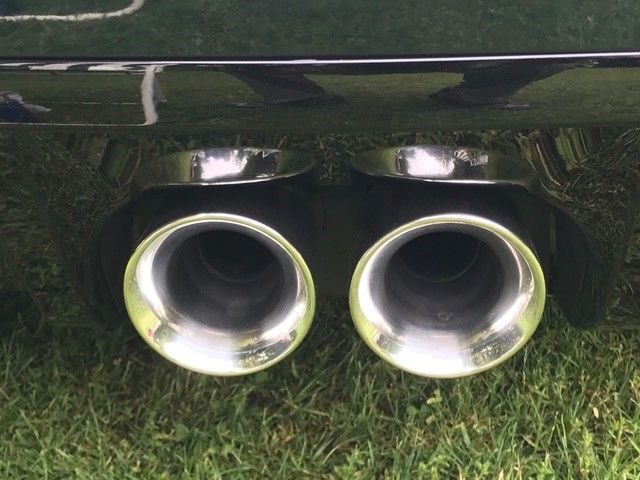

A picture= 1000 words (this photo was taken after the car had been driven about 100 kms to a show).

Sexy sexy! Thank you for posting!
