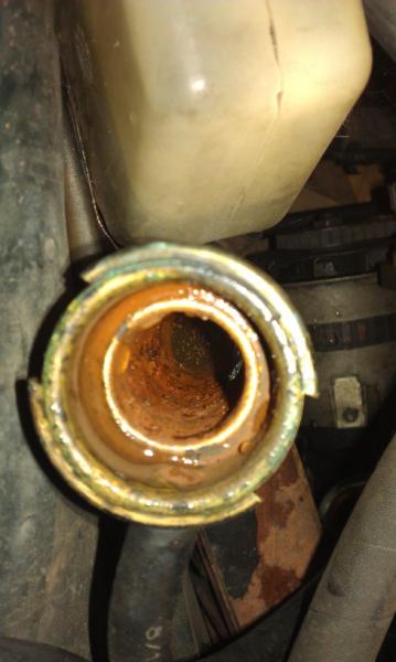

Second question, has anyone replaced their reservoir tank because it's gone rusty as hell?? I looked at mine (since it was basically dry) and was shocked to see an orange sludge (see photo). Is there a cheap replacement for these that won't rust in future? Given the state of it, is it worth doing a radiator flush? Anything else worth thinking about?

Hi- Not sure about the fuel tank switch issue but you could certainly continue to use your coolant expansion reservoir if you clean it out as long as the rust hasn't compromised the integrity of the tank. Take it out and if it's okay except for internal rust you could throw in a few nuts and/or bolts and rattle them around to remove the crumbly stuff inside. Then flush it out again and repeat a few times. If you want to seal the inside you can use the same stuff you would use for a fuel tank. POR-15 makes a version.
You could just use it as is without sealing though once you get out all the loose rust. As for a cheap replacement... it has to be a similar tank that can take a pressure cap. A good used one is your best bet if yours can't be saved but there certainly are aftermarket expansion tanks you can use if you can't find one... the ones I've seen aren't exactly cheap though. When I had to replace mine a used one was a much better deal.
Definitely flush the cooling system if it's been sitting a while but don't backflush it using one of those kits that goes into a heater hose. Just fill and empty a few times until the water comes out clear.

Good idea with the nuts/bolts to clean the tank out, will give that a go. Yeah I had a poke around a few sites last night and found a s/s replacement for $175, bit steep for me so might clean this one up.
