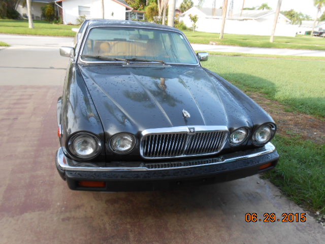

After over 18 months, my Series 3 will be registered tomorrow(Monday) and I will finally be able to take it out on the highway for a test run.
Most of my problems have been resolved, thanks to everyone on this forum.
New tires (Thanks LNR) 215/60/15.
New Brake hardware all around
Engine: Ignition System Serviced.
Fuel System: New Pump, Pre-filters, New FPR.(Thanks DOUG)
Engine idle: 1100 in Park, 800 in Drive. Will adjust after I drive the car for a while.
(JOSE) I still have my transmission weep to attend to. Like some one said, it was just "marking its territory".
All of the smaller vacuum hoses replaced
All electrical connectors cleaned and serviced.
Fuses holders and new fuses put in
All door switches except one now working.
I am planning to do Doug's bumper modification process after I sort out any issues i run into after the test run.
I know that there will be a lot of stuff still to be done, but those will be based on my maiden voyage.
I will take some pics and post them after.
THREE CHEERS
