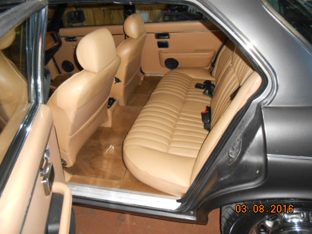

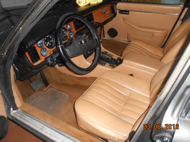

just a few more pics. Did service to my front wheel bearings today. Taking it on a 80 mile round trip today. Checklist in hand. So far, most of the electrical stuff seem to be working. I have to check the transducer for the speedometer. Sometimes it works, sometimes not.
Weird scenario with my rear marker lamps. Remove and replace fuse and they work, then slowly go off. Fiddle with the fuse and nothing happens. Remove the fuse and put it back and it works, the slowly goes off as if its on a decay switch. Front marker lamps are fine. Installed voltmeter and the voltage drops slowly from 12 volts to 0. It is not instantaneous as you would expect.
Installed a new 8 speaker stereo system. Four new door speakers, 2 6x9s at the back and 2 3x5s up in the front foot well. Had to move some stuff around to install those. So now I have bluetooth and USB for my music and phone.
Also changed out my wheels for some Series 2 ones.
