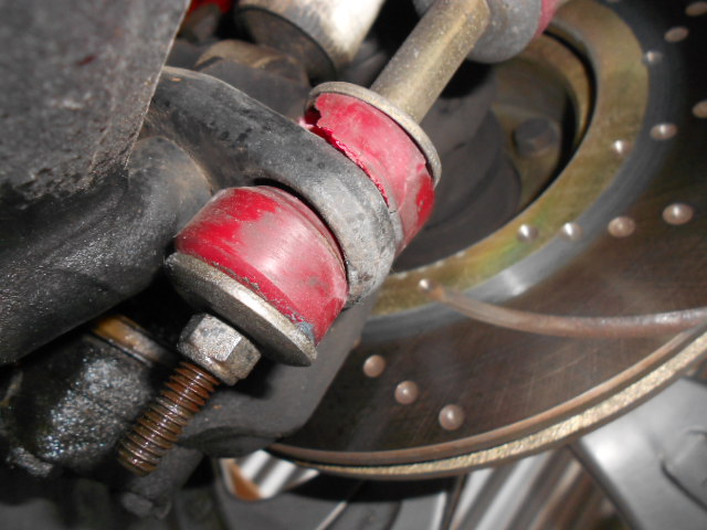

i did mine about 3yrs ago, pix
Attached Thumbnails Cleaning front suspension parts and redoing brake calipers and rotors-corvair-jag-brakes-003.jpg   Cleaning front suspension parts and redoing brake calipers and rotors-003.jpg
