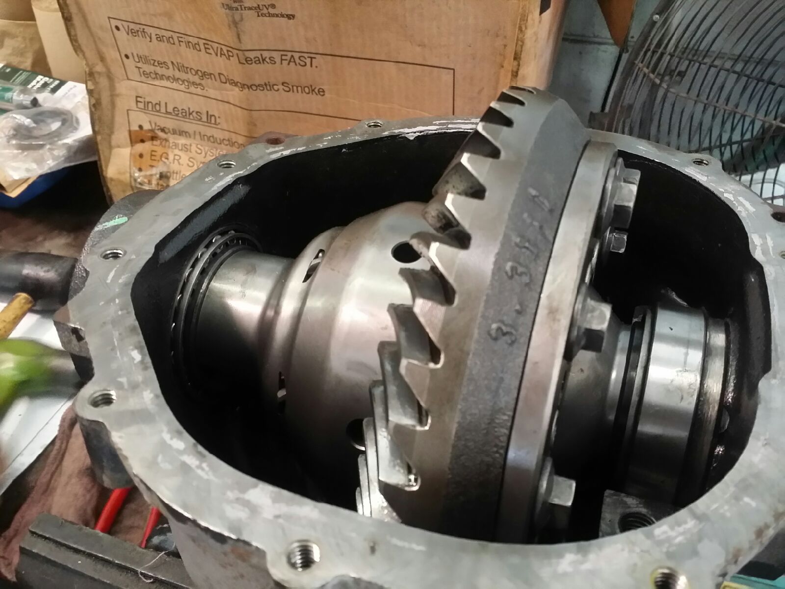

Now your staring at the cheap *** open diff. Using the dial indicator measure the backlash on the ring gear and make a note of it.
Remove the two bolts holding the race and bearing.
Remove the snap ring on the right side.
This snap ring has a specific thickness and the one they chose at the factory for pinion/gear settings. Mark the outside so you can install it the same way.
Now you can remove the guts. Once out clean the pinion gear and the inside of the housing.

Differential torn apart, interesting to note the original fluid was perfectly clear and not discolored, looked brand new. Also no wear or metal particles inside. A very clean diff for 8 years old!
Old May 20, 2016 | 03:01 PM
jahummer's Avatar
Joined: Dec 2008
Posts: 6,460
Likes: 2,587
Here are some pics.
Attached Thumbnails Quaife ATB Differential Installation-img_8981.jpg   Quaife ATB Differential Installation-img_8982.jpg   Quaife ATB Differential Installation-img_8986.jpg   Quaife ATB Differential Installation-img_8987.jpg

Originally Posted by Cambo
The diff in the 4.2 is the Ford Visteon 8" unit, same as what's used in the S-Type, X350 XJ, early XF and the Lincoln LS.
The Lincoln had a 3.58:1 diff from the factory, which is a bit of an improvement over the XK/XKR's 3.31:1
I retained the original 3.31, how much of an improvement would the 3.58 have made? Wouldn't that affect sensors and instrumentation?
