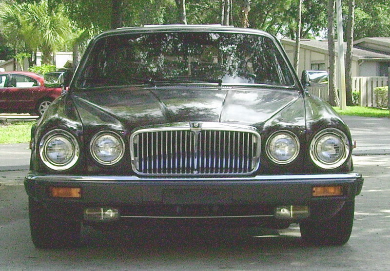

As to Tony's comment about the aux. lights protruding out from the body or bumper in US cars, that is not the case, the brackets do not allow that, the lights are flush or under-flush with the bumper, i.e., they are further in than out.
Here's my '84 with the double (fog & driving lights). BTW: the bumper is pre-drilled from the factory as well for adding auxiliary lights.
I have a set of the original Bosch Fog lamps with the protective covers, (see the second picture).
