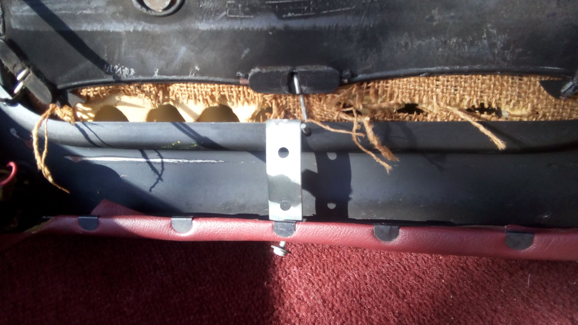

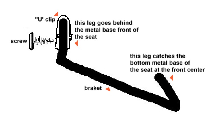

it goes under the seat rail tube, where the seat frame rests and fits.
the first picture shows the orientation of the bracket, match your bracket to the picture, then offer it to the seat in the same orientation.
Attached Thumbnails Front seat hold down brackets-seat-holdown-bracket.jpg   Front seat hold down brackets-xj-front-seat-holdown.jpg

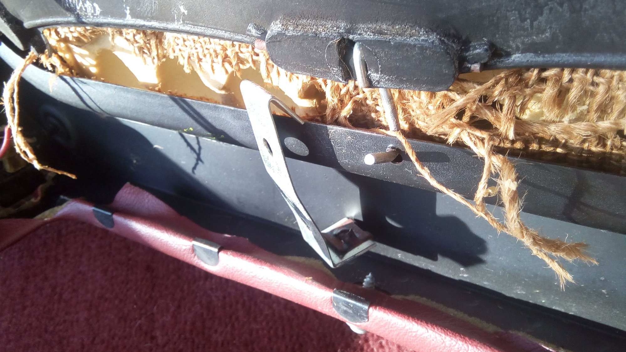

Here are some more pics if it does anything for you.
the bracket hooks in the metal pan on the seat on one side and screws into the outer edge of the seat on the other.
When in place, this "traps" the bottom metal seat frame between the bracket and keeps the cushion from lifting off.
Here is the cushion out of the car

because the seat's metal frame snaps into the metal tubing which is shaped the same way as the seat's metal frame.

Jose's illustration is just like my car. The first time I took mine apart it fell out just like happened to you and it took me quite a while to figure it out. But once you get the hang of it you will be able to take it out and put it back in about 15 seconds.
