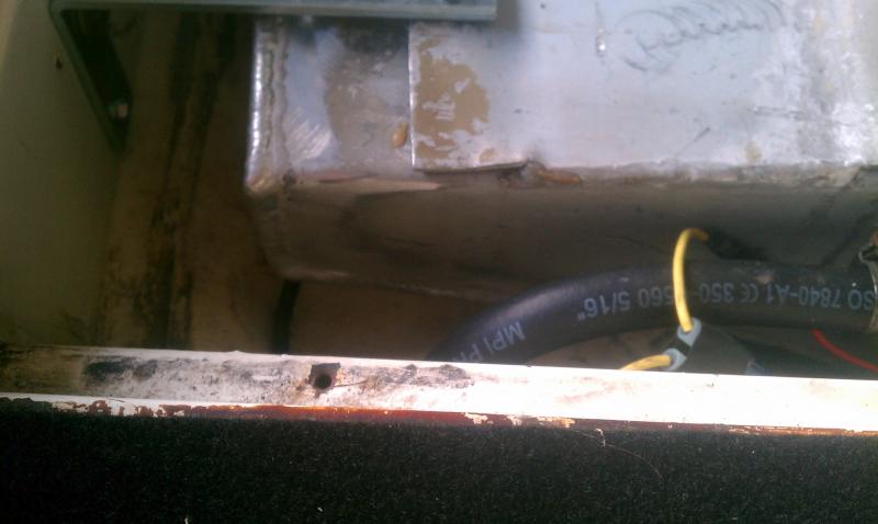

I resisted posting this on the site so as not to offend the purists. I installed a 23 gallon fuel cell in the space where the spare tire was. I paid $30.00 for a used 30 gal fuel, and had to cut the back end to fit the raised area where the original fuel pump and antenna was located. Welding ($160)The dimension of the tank is now 30" long, 23" wide 8" deep. To accommodate the raised area, the tank was tapered gradually at the 22" mark on the long side to 4". I removed the raised threaded piece for the spare tire on the trunk floor and blocked the resulting hole. The filler pipe is connected to the passenger side. the tank has to be removed in order to cut the hole for the filler pipe. I removed the antenna extension and mounted the antenna in the space where the passenger side tank used to be. I am in the process of working out the best way to use the driver's side fuel tank to store additional fuel using a lock off valve, so I can have an additional 10 gallons of fuel if needed. I have done this job in such a way that I can revert to the original configuration at any time. The fuel cell is vented through the original lines to the charcoal canister, and one through a check valve ($15) I bought at the marine store. This check valve opens when air is displaced from the tank when you are filling it up. In my case I am using a low pressure electric fuel pump 2-4 psi for the carbureted engine and the original fuel lines to the engine. I am including some pictures so you can get an idea of what I did without butchering the car. Looks ugly but the stuff on it is fiberglass resin. Still have to clean it up. It is now fully functional. If you have any questions let me know.

The problem with mounting the fuel cell in the forward most part of the trunk is the locating of the filler pipe. I have a tank that would fit there but when I looked at the area inside the fender well I would have had to cut through the wheel well then cut through the inside wall of the trunk. Placing it in the spare tire well was more logical, since I only had to make one cut through the trunk wall.
