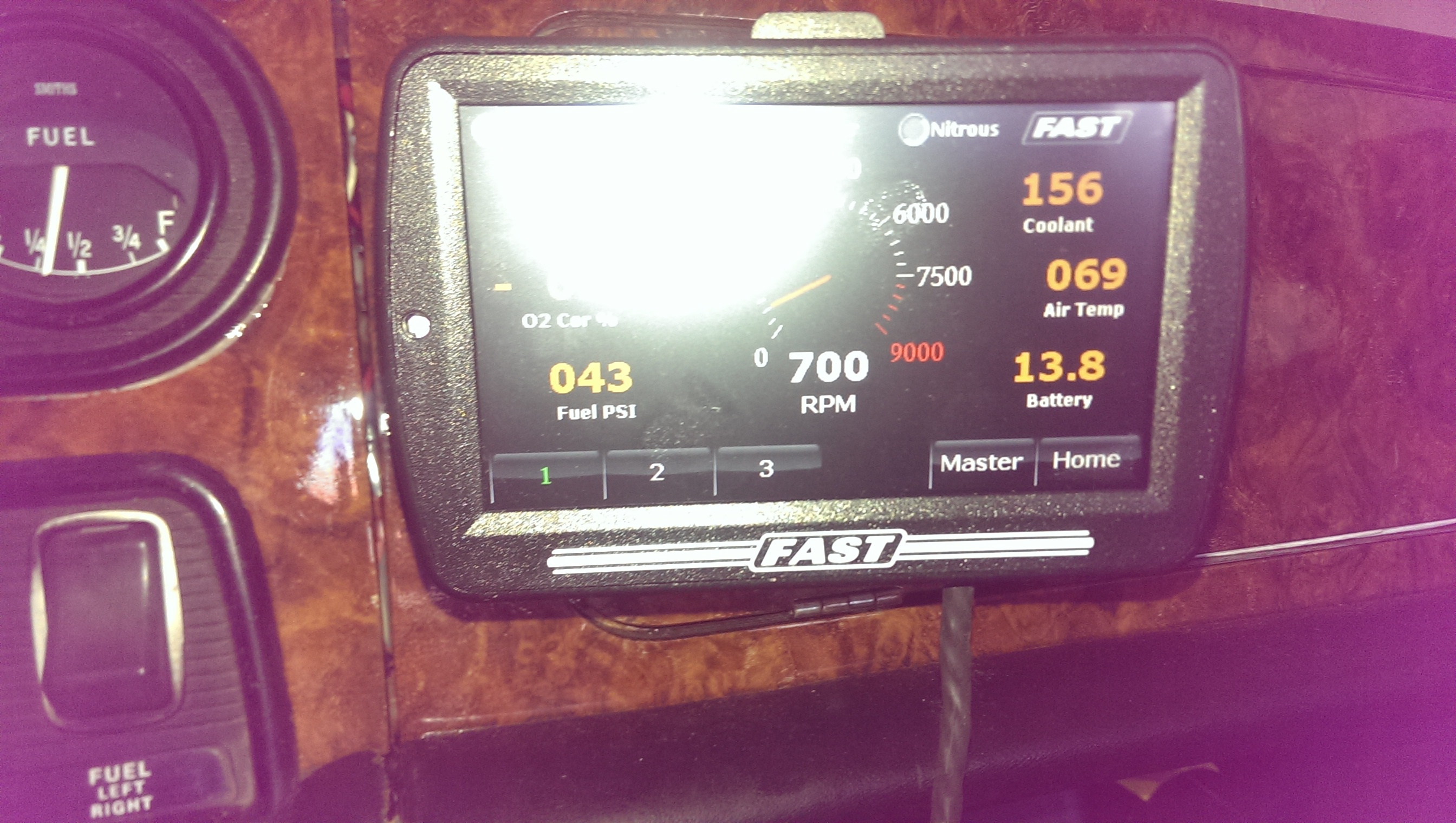

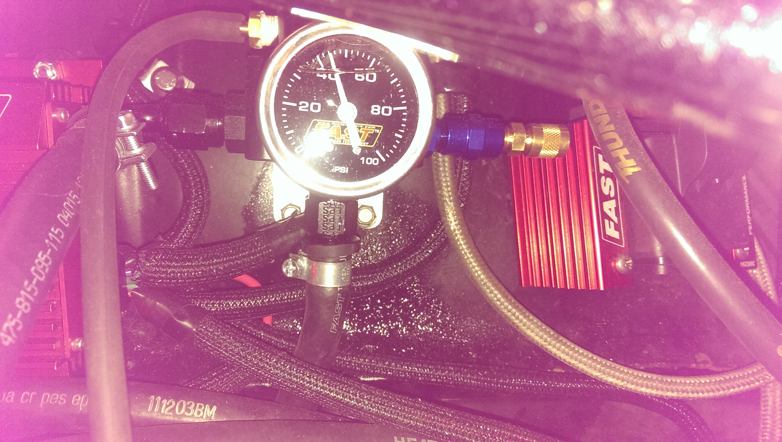

New FP gauge came under Warranty and I installed it and adjusted the FP to 43 lbs.. both the gauge and the handheld now show the desired FP.
Old gauge would read as much as ten (10) lbs different from the handheld and the other FP gauge.
Blue fitting sticking out the side holds a Shraeder valve the I can connect my regular large fuel pressure gauge for verification of the
pressure should the little gauge differ. I have a 90 degree adapter coming that will point the valve straight upward for easy connecting.
Having the handheld available that shows Live Data and has multiple screen setups - is very handy. It clamps to the glove box door
with a sticky GPS type mounting bracket. That is where I have my Garmin GPS attached when traveling.
Photos show the desired results!

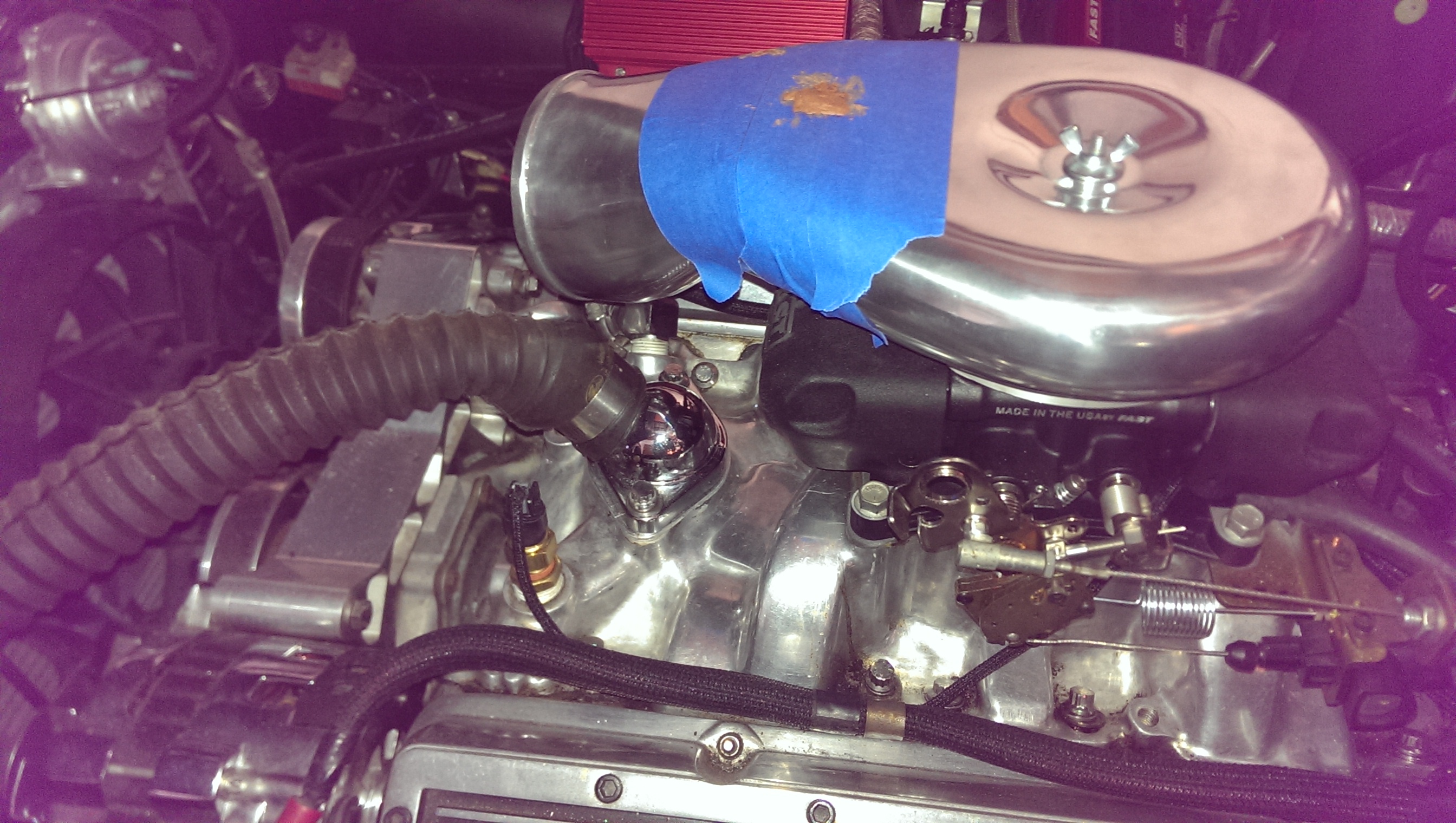

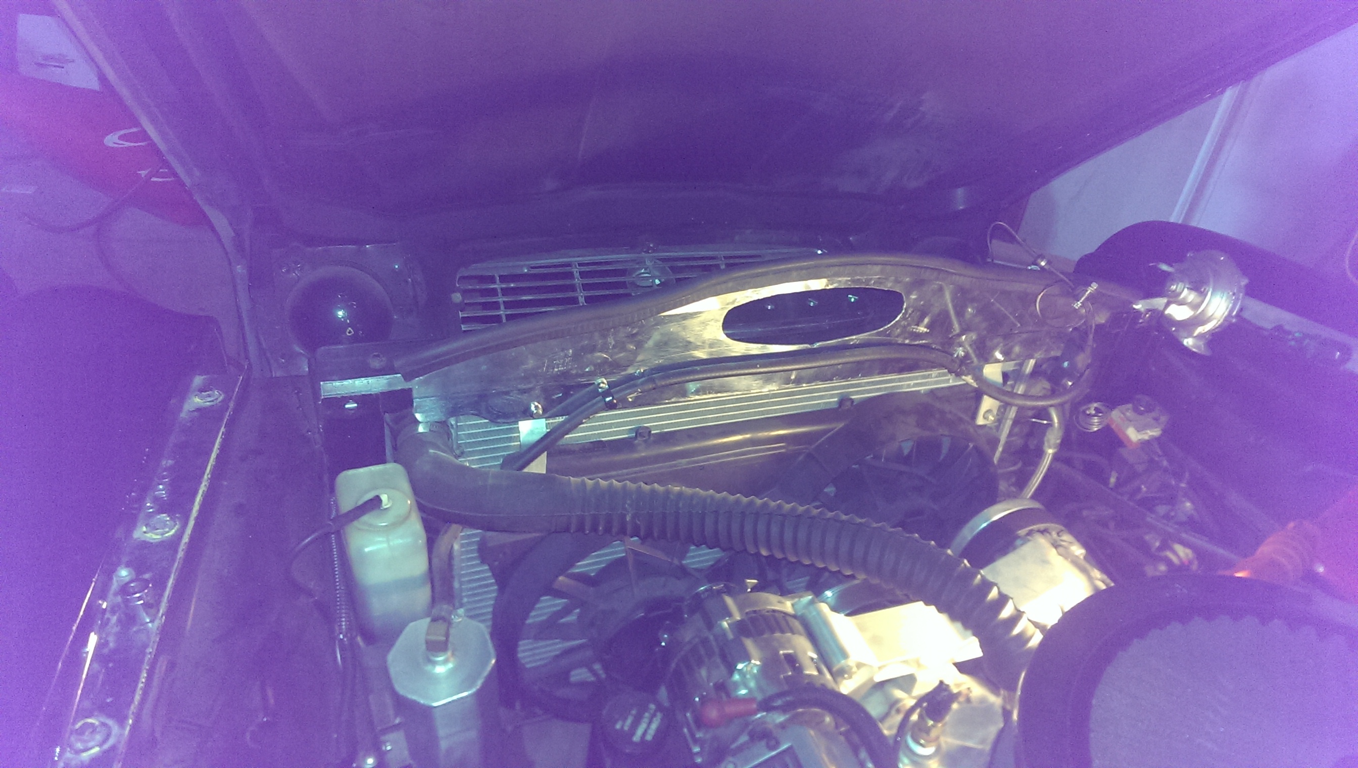

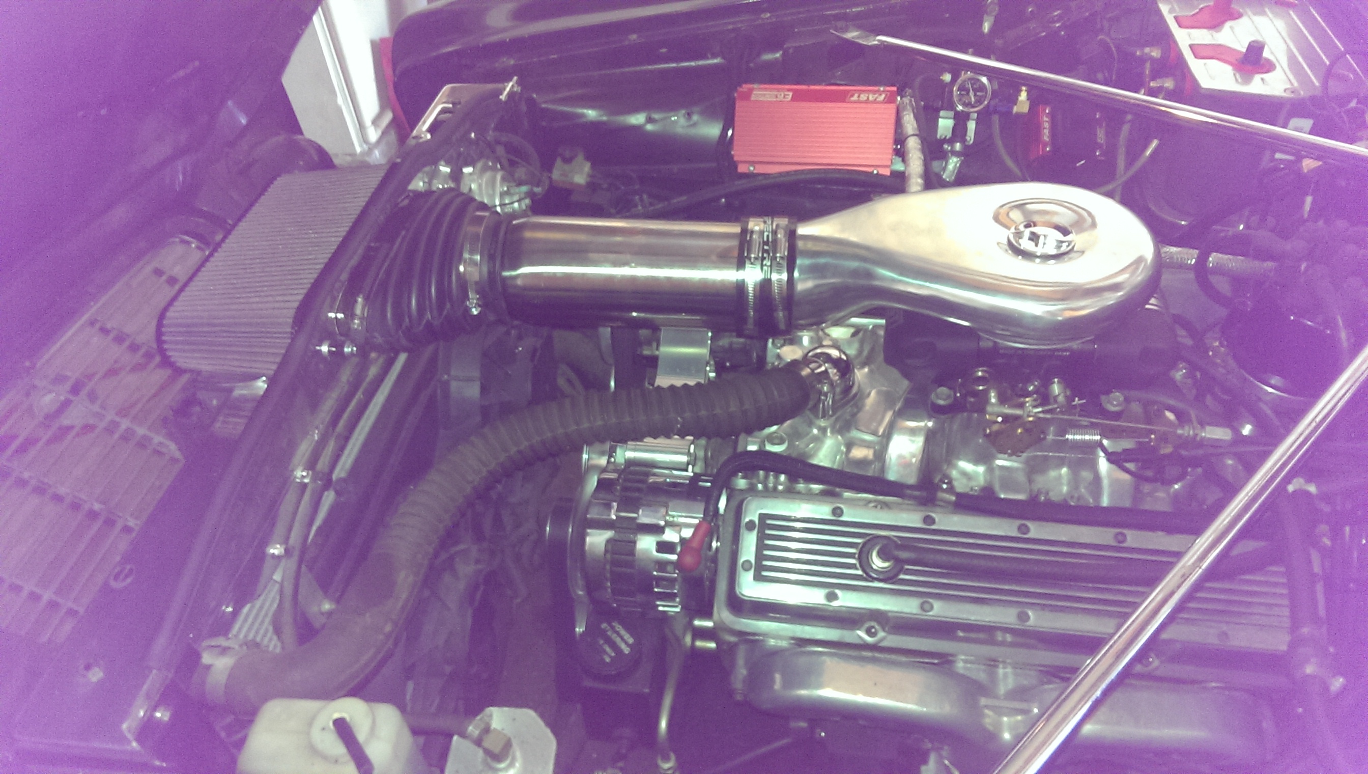

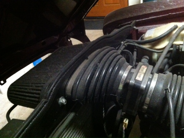

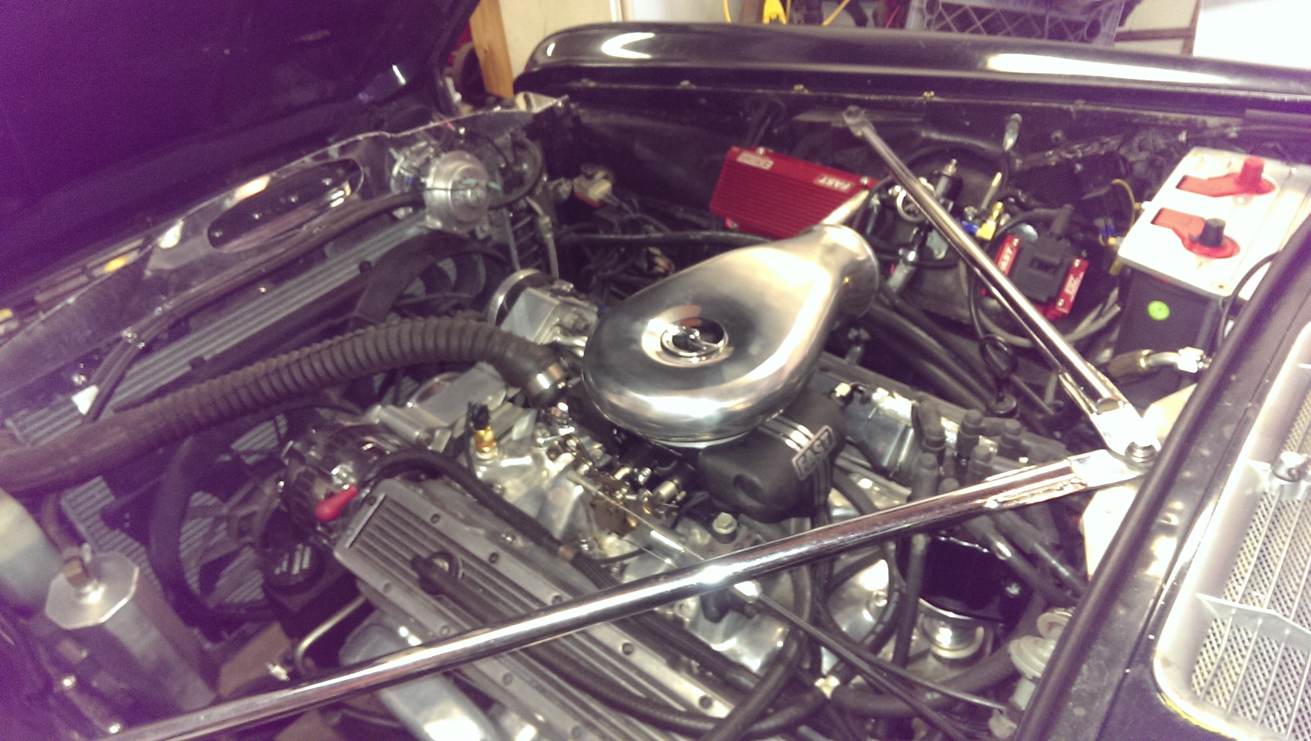

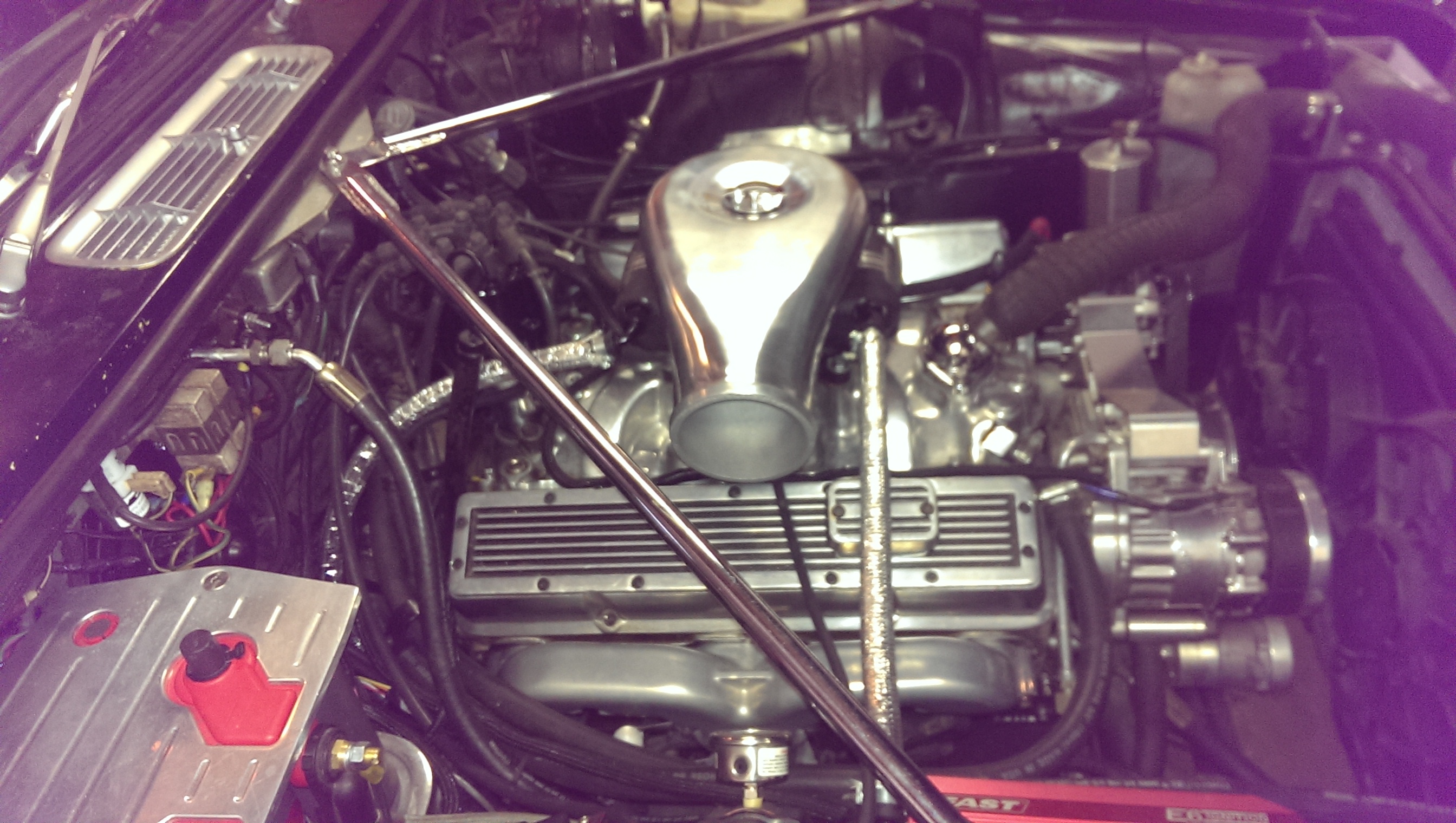

I increased the height of the custom aluminum radiator support to give me room for the hole needed for the carbon fiber air box from Bob Loftus.
Because of hood height, I will use the Spectre 98499 air plenum cap and tubing to connect to the air box bellows.The last photo is a .bmp and has to be opened by itself... sorry.The little drawing of the plenum is a .jpg but it did not open up like the others? Is good as it shows the plenum dimensions and the views.
The one photo shows the air box system hooked up to a MAF and mine will have a four (4) inch tube connected to that bellows and the plenum end.
The new fuel injection system is working perfectly...just want to help it with the addition of ambient outside air into the intake.

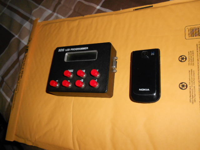

i use the SDS,(simple digital systems) standalone EFI system, been 21yrs ,upgraded 3 times, technology does not stand still!
been great many adjustments and break points, use a A/F ratio digital gage for tuning.
the magic of a hi/performance engine has always been in the tuning, most people just buy already tuned parts, standalone tuning enters a completly different area of engine performance! it is today(as always) an art form!
Bob Loftus is making me another of his custom fiber air boxes that fit into the S3 radiator support. My all aluminum support has now been modified with a higher piece to support the height required for the air box hole.
The plenum cap will only fit with the hose connection pointing toward the
passenger fender...I will use 90 degree stuff to get the hose going toward
the front rubber bellows. The low Jaguar hood precludes the outlet from
facing forward...
It all fits nicely now and rubber weather stripping piece is installed that
forces (seals the top of the radiator support) the incoming air from the grill into the K&N filter.
There is still plenty of room for a turbocharger?

Blue tape was "just in case" and the red stuff on top was rubbing compound to show where it hit the hood and by how much... it does not hit now even
with downward pressure on the top of the hood over that high spot.. the bottom of the plenum cap had a thick base that could be ground down at an angle.
I will put back on the angled thermostat housing and move the temp sender near it to the RR of the intake manifold- where there is another hole. Then the hose with a extension tube will point directly to the air box bellows.

Bob Loftus just shipped my cold air kit parts. All I have to do now is drill two holes and bolt it all together. This kit is not normal as I do not need to use all
the front mounting pieces he includes. My custom radiator support has a special attaching point for the B&M trans cooler that will allow proper supporting of
the filter.
There will be a polished tube between the bellows and the plenum cap on the top of the TB... will cut to proper size when all is here. Final photos will be
posted.
VERY SOON and the conversion will be 100% completed!
the filter.
posted.

Parts for cold air kit arrived and were installed. Looks and works great... the whole conversion has been positive... it starts with just the key and runs 100%+ and then shuts off properly... get rid of your carbs now!
Next step is to tear it down for a bare metal repainting in the same BRG.
