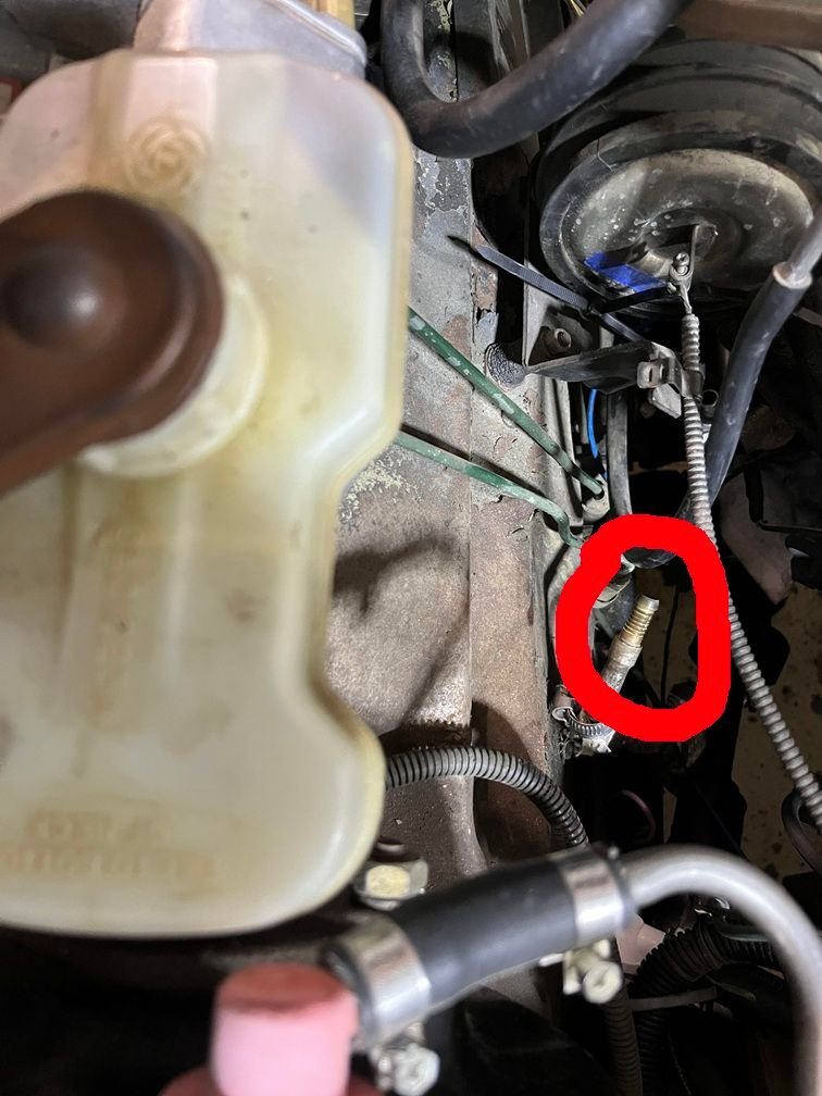

Confirmation appreciated.

Yes.
Return fuel comes from the pressure regulator, 'round the front of the cylinder head, thru the fuel cooler, and then to the pipe shown in your picture.
It has twin counterpart, the supply line, on the other side of the engine bay.
