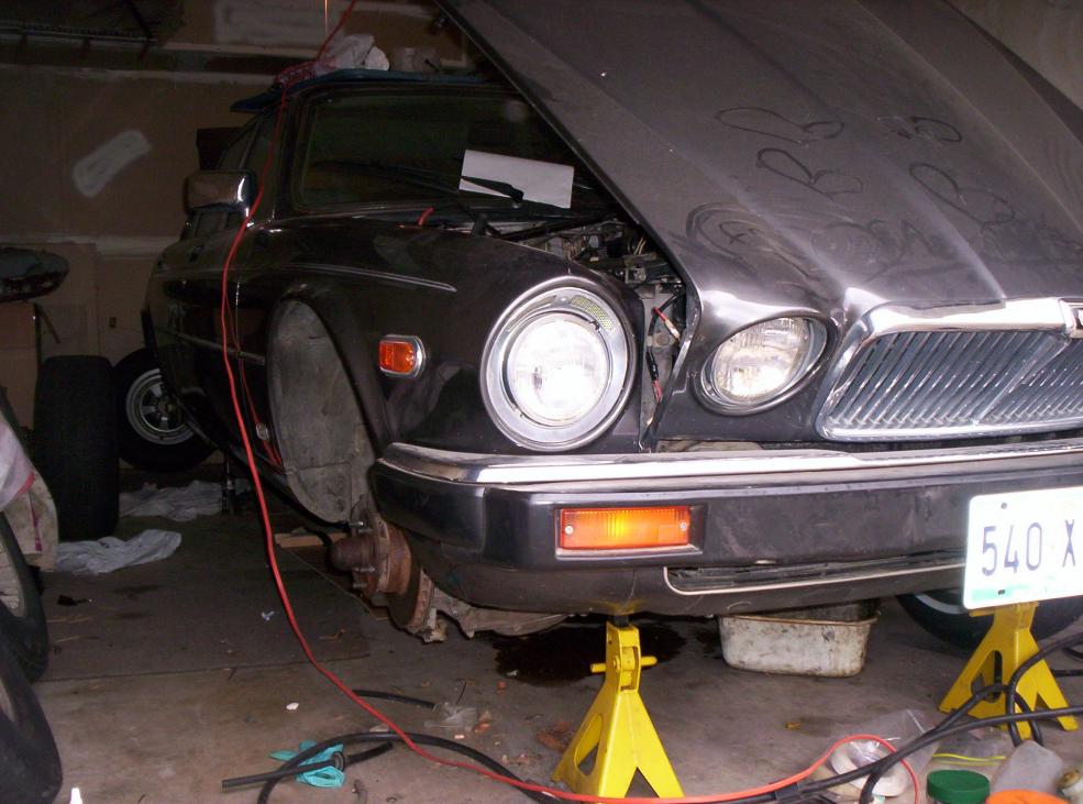

Today I worked on the Jag for a little bit. I went to the Pick-n-Pull the other day for a second strike (I also went last weekend with a buddy and some of his friends to help them out, and I got a few items but realized I needed to go back solo with more time). There was a pretty nice Jag there that was a cash for clunkers victim, and I got a piece of brake line and some other bits. Both of the scrap Jags were Vanden Plas models, one even had decent door panel wood. You could tell the car had recently been waxed, had shiny paint, and new tune up parts-- like they had to get it running to kill it for the clunkers deal.
Our Jag appears to have run over something in a previous life, and it damaged the brake line, so I am banging out some floor dents and getting ready to install that new used brake line. I also repaired some wiring bits and am getting ready to replace brake rotors and repack the front wheels bearings. Then I think I will get it gassed up and try to start it for the first time in a few years since I first put it in the garage. I will disconnect the fuel line at the engine and pump some gas through till it runs clear. Then I will replace the fuel filter. I already dumped some fuel injector cleaner into the lines, and some Seafoam, hoping that will prevent the injectors from being stuck. I have cleaned out the gas tanks as best I could, there was about a half inch of sediment in each tank. The gauge sender floats were all scaled up and stuck. I cleaned them and they should work again. (A lot of this work has been done over time, not all just recently).
A request: if someone has a picture of the parking brake cable, where it passes below the driver's floor pan, I would like to see it. The cable apparently passes through a small piece that bolts up to the floor with two 5/16 bolts that are right under the front edge of the seat. This small piece got mangled and I would like to see what it is supposed to look like. I will probably have to go back to the junkyard and get one.
Pics show my single car workspace. I was working on replacing the brake booster at the time.
