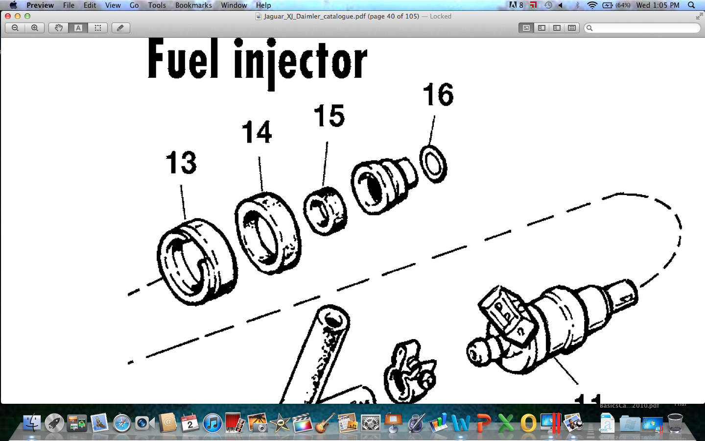

Hello all...I need to get my 85 XJ-6 V.P. running within 30 days or it's gone...I've had the injectors serviced, but I need the hard plastic seals that fit into the engine; they look like a little 'hat'...but every search I do, only shows seals for the injectors...I have an exploded diagram of the injector (attached) that shows the part (between 15 & 16 in diagram), but it doesn't have a number tag to identify it !
Any help appreciated...part #, name of part, etc. If anyone actually knows where I can get 6 of them, well, I'll set up a statue to you in my yard ! :-) Thanks in advance... ~Dan

if you are talking about the plastic parts with a lip at the opening and hole for the pintle...you really don't need them to get the car running. If you must have them they are called pintle caps and can be found on ebay,
Fuel Injector Service Repair Kit Seals Filter Pintle Caps 87 88 RX 7 CSKDE11 | eBay
Also rock auto has injectors complete with the hose attached for 31$ each. Get'em while you can.

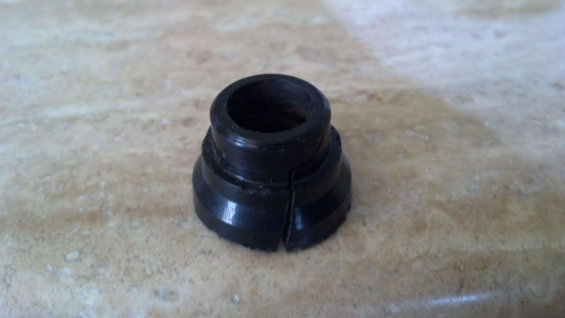

Thank you both... I've attached a pic of the cracked pintle...it's one piece and made of solid plastic...I just want to make sure the ones on Ebay is the same thing, just in two pieces instead of the one.

Google Jaguar EAC4403 ....I think
Here's but one
eac4403 - Fuel Injection Cone
Looks like the same as in your picture
Also try
Jaguar Fuel Injector Service
Dave is a great guy. He can help, I reckon

Fantastic ! That's it ! Many many thanks ! ~Dan

Just fyi, Doug~ I found this part at JaguarMerriamParts.com for $6.53 apiece...also got the tip washer/seal for .28 cents each...I ordered a couple extra at that price :-) Thanks again... ~Dan
