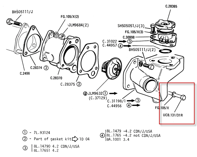

Does anyone have a special trick to remove the lower driver side bolt on the header tank? It's hidden and I'm having a bit of trouble getting a socket on the bolt head?
Hopefully it's really basic and I was just having an off day.

Not directly. The illustration was very helpful. I thought the part was a different one entirely!
Seems like a "normal" hex head fastener. So three things come to mind.
1. A PO used an "odd" bolt there. Metric??
2. A PO rounded the head of the fastener badly. I have a socket with "fingers" in it ala Chinese finger puzzle to grip odd bolts.
3. It is just grimy there holding off the socket from seating.
A fresh try works so many times....

Thank you very much for the reply Carl.
It looks like a fresh start is all I needed, along with a shallow 1/2" socket, an extension of just the right length and a flex head ratchet.
The hole the bolt lived in had a bit of corrosion so it required more effort to remove than I thought.
