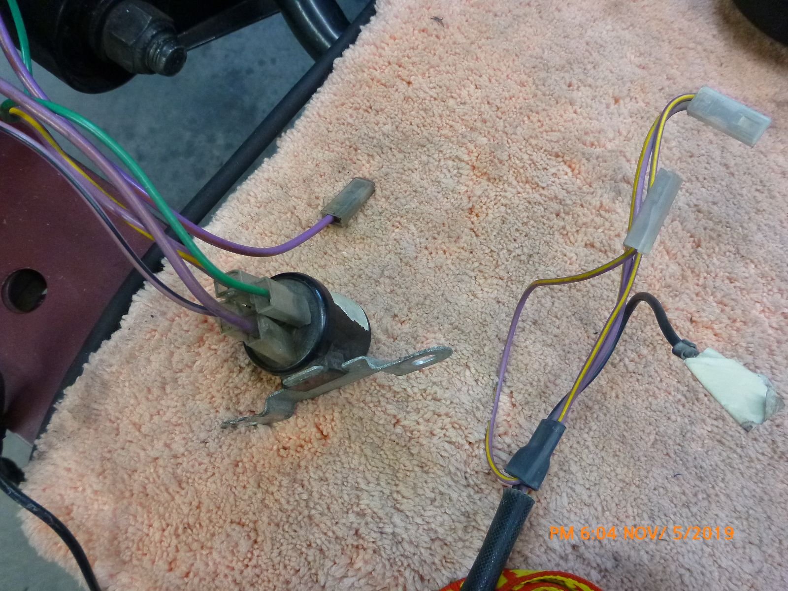

I have a 1986 Series III Jaguar. The Wiring Harness to the horn relay are (4) single wires. Green, Brown/Purple, Purple Yellow, and Purple Black. I am having difficulty finding which wires connect to my horn relay. Pins 85,86, 87 and 30. The harness must have been damaged or cut years ago, as the harness connector is gone and I am having trouble figuring out what wires connect to what pins.

Jim, here's a picture of mine.
Relay pins:
30-PN
85-G
86-PB
87-PY (to the horns)

Wups….here's the picture.
