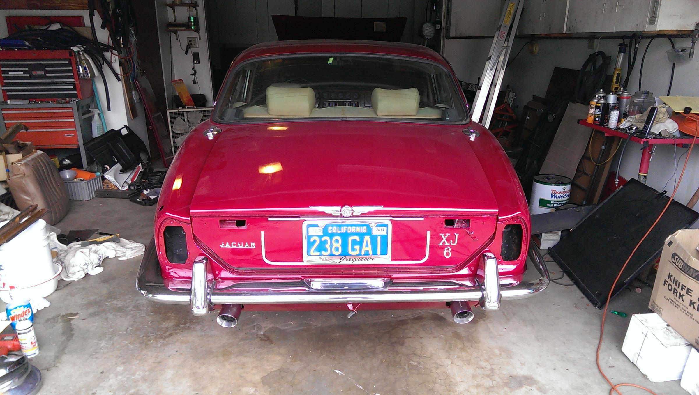

Default I enlarged the hole in the spare tire well
It worked, I used string to pull the antenna mast through the old smaller hole into the fender.
The antenna fits well and will be totally mounted (the motor and delay relay) tomorrow as I have to move around the fuel system stuff to make room.
Attached Thumbnails How to remove '84 S3 power antenna mast-s3-antenna-installed.jpg
