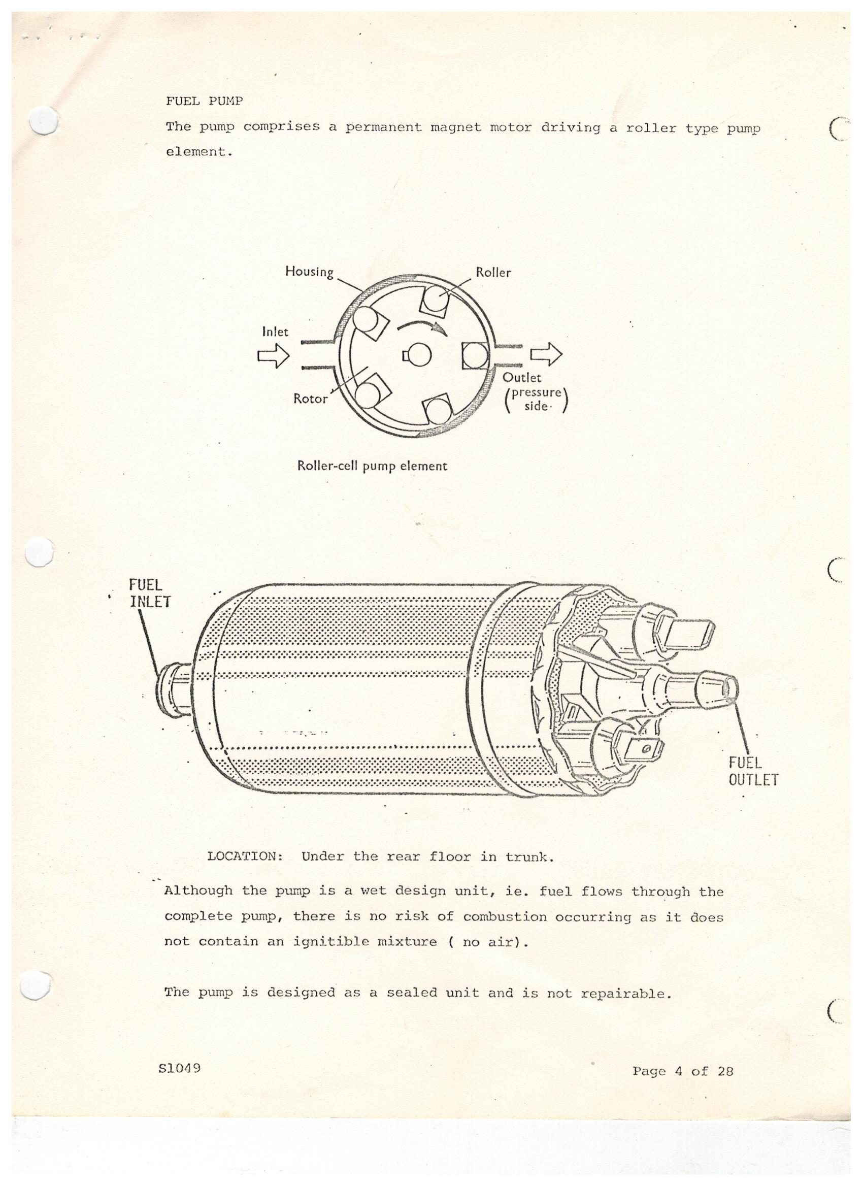

I've got a feeling that it's likely in the fuel pump.. Though the pressure regulator is certainly suspect too...
I said above the pressure should be 33, but I think it's 36....Either way, dropping off to 20 or less certainly isn't going to make it run...
Only thing to do now is the test that Doug suggests.. If it turns out it's the pressure regulator, I can help with sourcing that...
In the meantime, here's some extra reading material for ya......

Just did the deadhead fuel pressure test. It went up to 70psi. Therefore fuel pump is good i supposed. Is there a test i can do to make sure it is the pressure regulator? And would you recommend a certain one?
If the pressure was too high at the rail then you could look for a restriction downstream before condemning the regulator....but that scenario isn't what you have.
David can fix you up with a good used one. If you want new, I think any of the name brands would be OK. Bosch, Standard Motor Parts, Beck Arnley, etc. With all the global manufacturing and label engineering going on it's hard to rely too much on brand names these days, IMO.
DD
Yeah, My bet would be David's good used one. He might just have a proper NOS.
