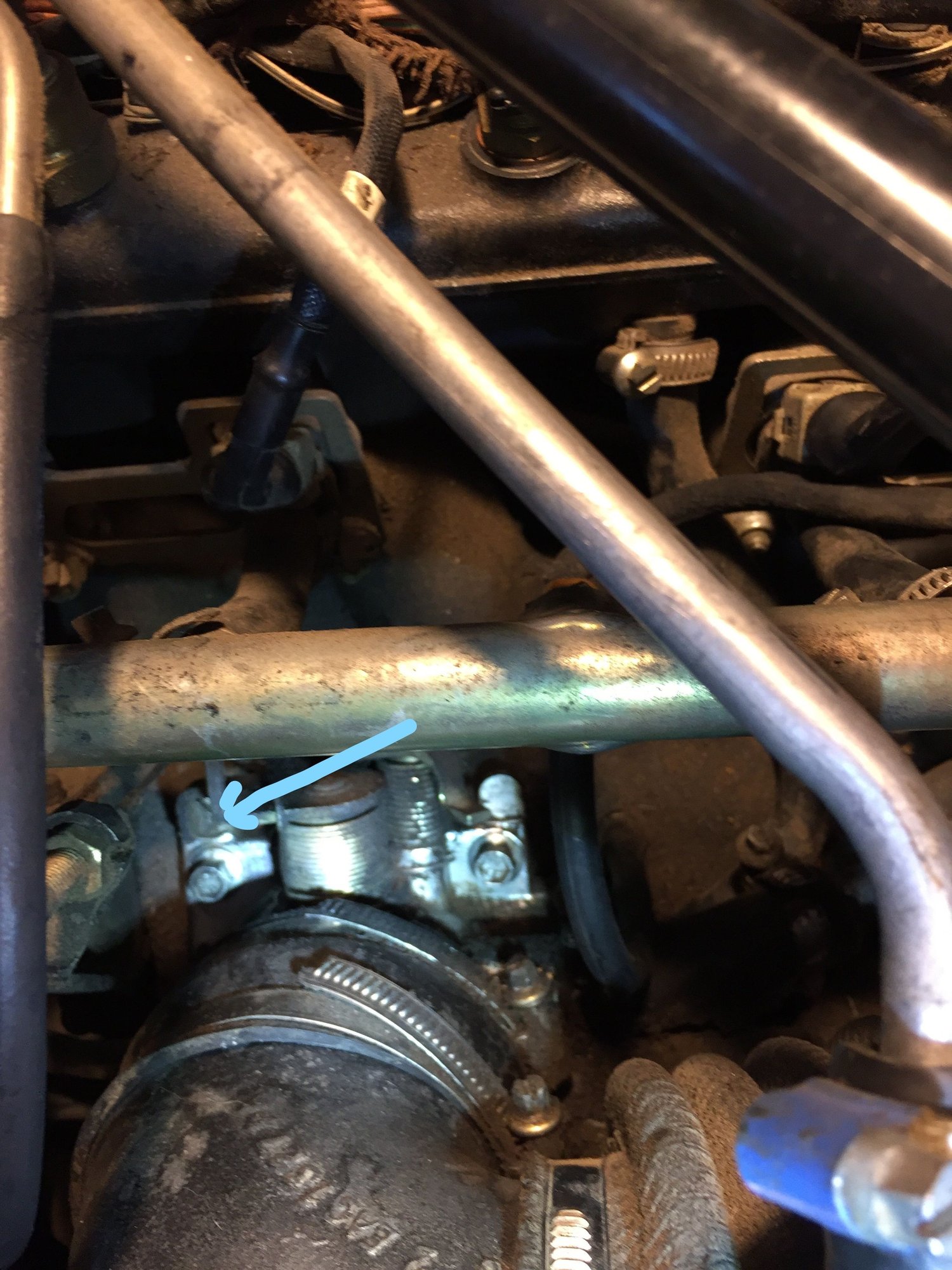

OK, there's a plate forward of the linkage spring that has an adjustment screw with a lock nut on, is that it? I thought that was for adjusting the gap on the butterfly valve. I wanted to increase the idle hopefully to solve my situation. To begin with the car wouldn't start and after some testing I discovered the spark amplifier module was bad, so I replaced it. The car started after that but when I put it in drive, it would die. It idles around 900 rpm. If I hold the gas pedal to about 1300 rpm, it would not die when put in gear but would die when I let off the gas. I have replaced the fuel pressure regulator and the plugs and have cleaned the throttle body and air flow sensor so far. I haven't adj the butterfly valve yet due to I don't have a .002 feeler guage. But it ran fine before all this.
Old Nov 27, 2020 | 03:00 PM
shelikesjag20's Avatar
Joined: Dec 2019
Posts: 14
From: Idaho
Here's a pic of what I have.
Is this the adj screw?
Old Nov 27, 2020 | 04:36 PM
Jose's Avatar
Posts: 9,142
Likes: 2,664
no that is not it.

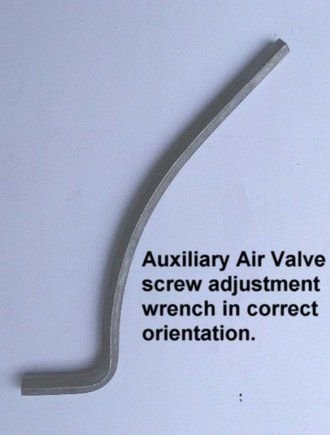

the part that Doug is referring to is at the center of the intake bolted to it. It has a large 5/8" hose clamped to it. The part is silver.
you will need a 7/32" hex wrench, bent in a specific angle to be able to get to the air adjusting screw. although some have achieved turning the screw with a normal hex wrench, it is not easy to turn it because the screw is usually stuck with crud deposits.
Old Nov 27, 2020 | 04:44 PM
Jose's Avatar
Posts: 9,142
Likes: 2,664
tool needed to adjust
Old Nov 27, 2020 | 04:45 PM
Jose's Avatar
Posts: 9,142
Likes: 2,664

You're welcome. I will upload a picture of the needed tool tomorrow morning.

Hi Jose, could you send me a pic of that idle adj tool that you mentioned? I have spent hours and bent an allen wrench every way possible to adj this idle. To increase idle, is the adj screw turned clockwise or counter clockwise? I can increase the gap at the butterfly valve to 1400 rpm and I can shift into gear and it will stay running at about 900 rpm. The idle screw doesn't seem to have any effect. Any ideas? Thanks Jose
Old Nov 30, 2020 | 05:09 AM
Jose's Avatar
Posts: 9,142
Likes: 2,664
if I remember correctly, clockwise is less air, counterclockwise is more air.

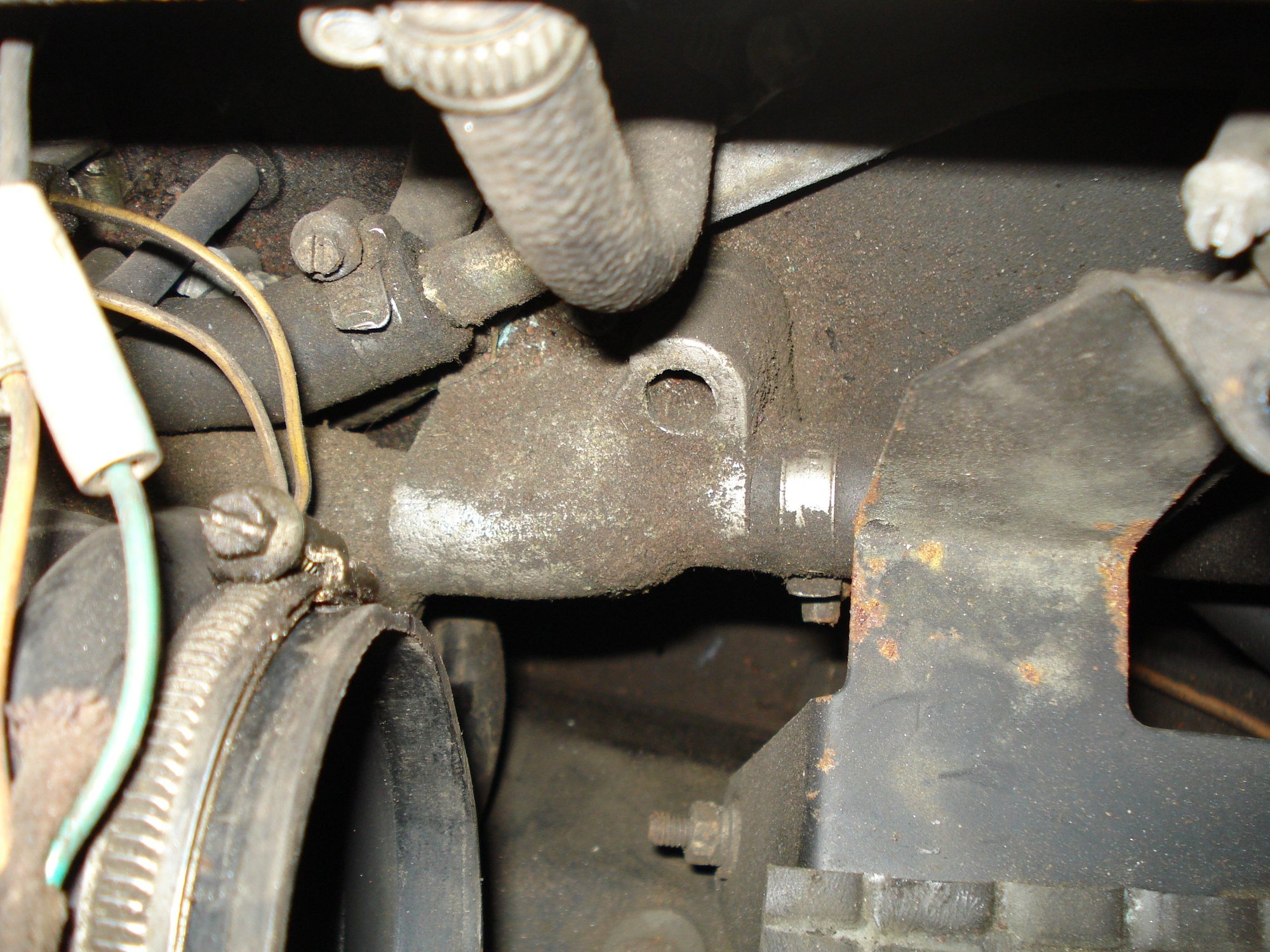

S.Bunzel's Avatar
Joined: Mar 2013
Posts: 131
Likes: 35
From: Aalborg, Denmark
Old Nov 30, 2020 | 03:45 PM
Joined: Dec 2019
Posts: 14
From: Idaho
Thanks S.Bunzel for the pic, I've already discovered the location. By chance, do you know why my jag dies when I put it in gear. I adjusted the idle to specs. didn't help. If I push on the gas and get it up to 1300-1400 rpm then shift into gear it will continue running as long as I hold the petal down but die when I let off. I'm at a loss. Thanks again.
