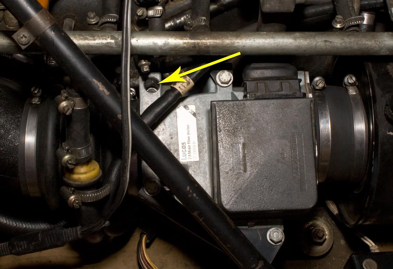

MAF sensor on 84 XK engine (Federal) -- is this the warm idle adjustment screw?
Forgive me if this has been answered, but I've searched and couldn't find it.
My 84 XJ6 (Federal, California) runs fine while cold, but idles low (~700RPM) when warm, and gets rough and sometimes stalls. Shifting into neutral helps but not enough.
As a first step I thought about trying to adjust the warm idle. I've seen this discussed at length in various places, but I'm having a hart time visualizing the location of the proper adjustment screw. I've attached a photo of the MAF sensor on my car (best angle I could get). I added an arrow. Is this the proper screw to use to adjust it?
I don't want to adjust the wrong screw on the MAF if I can help it. I have enough trouble with this sort of thing without digging a deeper hole for myself.

That's the mixture adjustment, not warm idle speed.

Idle trim (RPM) adjust is about 1" inboard and 3" down (from your yellow arrow point) on the intake manifold.. covered by vacuum lines et. al., but it is there. in an aluminum fitting. see red arrow

On intake manifold below red arrow
