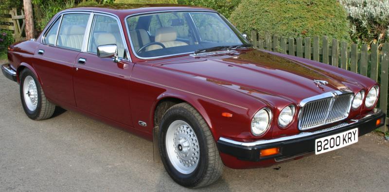

I had a Series 3 4.2 for 14 years, the longest time I have ever owned a car. The ride is an absolute magic carpet, there is nothing quite like it, certainly not in the later cars. You feel you could drive across Europe in one in a day and not get tired. Broadly speaking, previous posters are smack on the button regarding the Series 3.
Reason for buying a later Series 3, (from about '84-on), is the block machining was changed to stop blocks cracking between the bores. This cracking essentially wrote off the block. How do I know ? Well, I'm sure you can guess ! Despite this, the head gaskets can go but are easy to fix.
Of course you need to be aware that this engine came out in 1948, and apart from the DOHC is essentially a pre-war engine, certainly the block design.
Almost all the wearing parts on the car are quite cheap to buy and freely available even 25 years after production stopped. DIY is perfectly possible if you are a good mechanic and have the tools. I did all my own work, and rebuilt the engine, and the suspensions front and back. No pesky complicated electronics to worry about, its all discrete components and analogue technology. However bear in mind the very latest six cylinder car will be 26 years old, so try to buy a car that has been cherished by its previous owners. BTW, the 5.3 litre V12s carried on until 1992, but only about 50 a week, if that. I remember seeing the body shells for these being put together by grey-haired old guys in a separate shop at Castle Bromwich in the late-eighties, on a factory visit. I was lucky in being able to visit the body plant at Castle Bromwich in Birmingham and Browns Lane in Coventry when I lived in Rugby.
