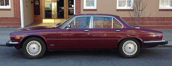

Default Thanks to all! I bought the wheels (picture)
Thanks to all! You guys are a gold mine of information!
I bought the '93 XJ6 wheels for my '86. They're the ones where the lug nuts are concealed under domed center caps... remind me a bit of steel wheels with center hubcaps -- sort of a retro look that I like on my XJ6.
I'm attempting to attach a picture of my car with the new wheels. (I Photoshopped the wheels in from the eBay ad... haven't actually got 'em yet!) Hope it works.

Nice car. wheels look very nice on it.
Carl
