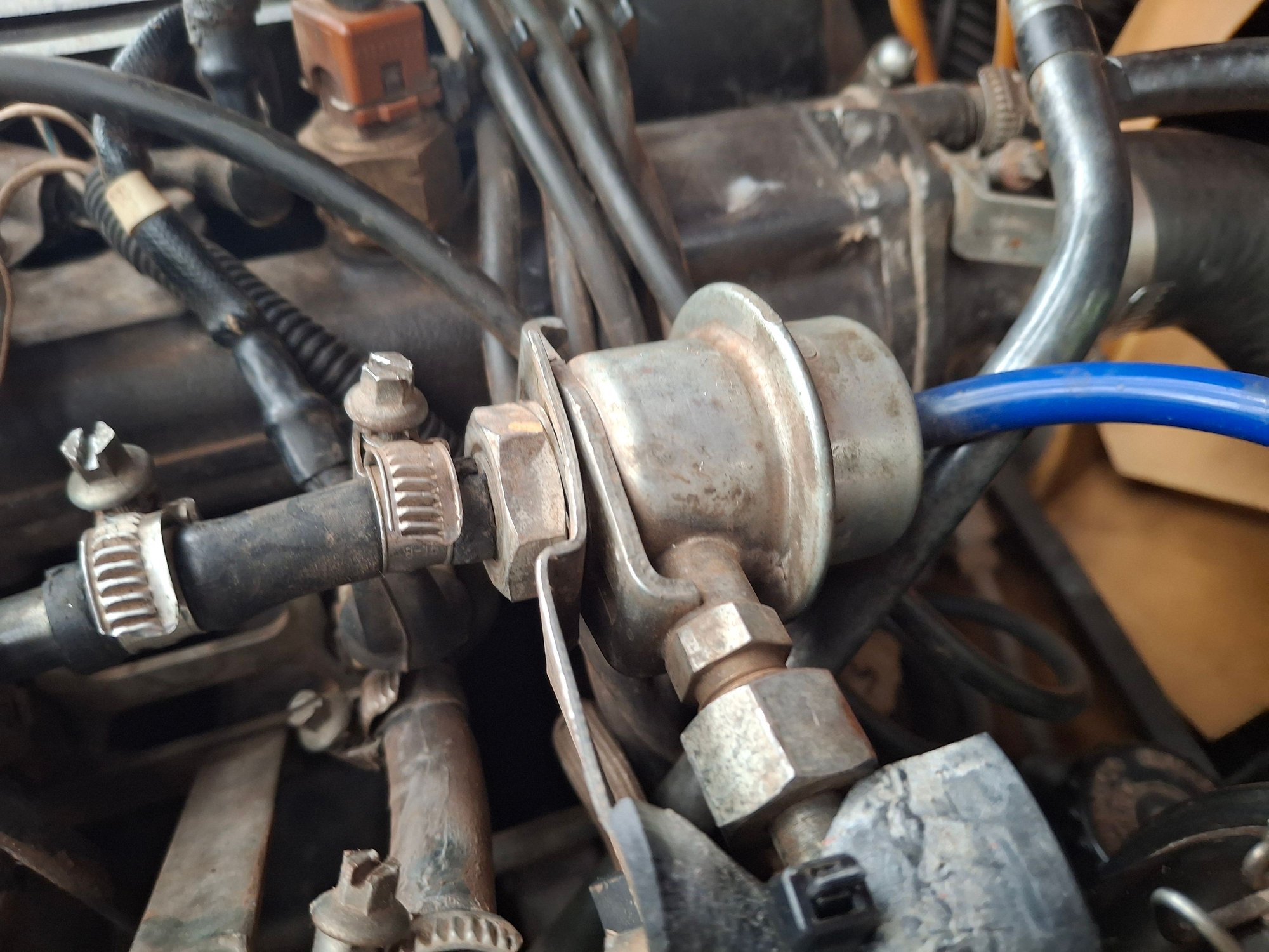

I found the issue is the pressure release valve, it's not working, I have to order from england but its incredibly expensive, im going to see if i can buy an aftermarket one, but what's the pressure must it release at?

This pressure release valve and i live in zimbabwe, southern Africa so very little jag support, ive got someone in SA who does it but he doesnt have them.

Fuel Pressure Regulator

What pressure must the fuel line be?
Old Jun 5, 2025 | 11:28 AM
Doug's Avatar
Posts: 25,526
Likes: 11,717
From: Pacific Northwest USA
36 psi when cranking the engine

I found it was the regulator and so I've gotten an aftermarket adjustable one, having to get an adapter made up to fit.
