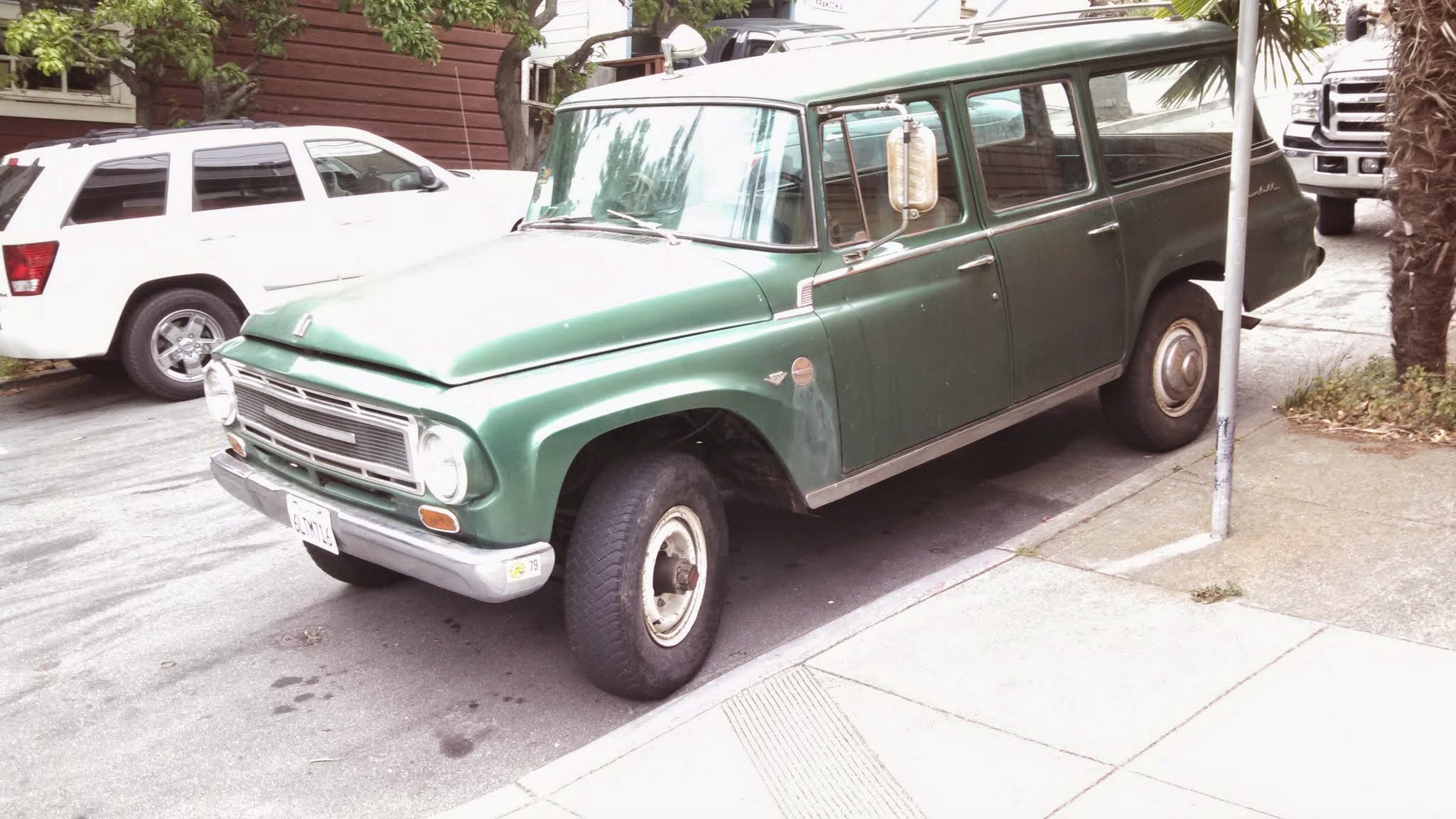

I have a 67 3/4 ton international harvester travelall with two very large tanks, nightmare getting fuel into it as the newer gas pumps don't fit the vertical fuel filler tubes...it basically comes back out due to pump speed as seen in the paint damage in this old photo of it...
Same switchable tank logic as the XJ's....
