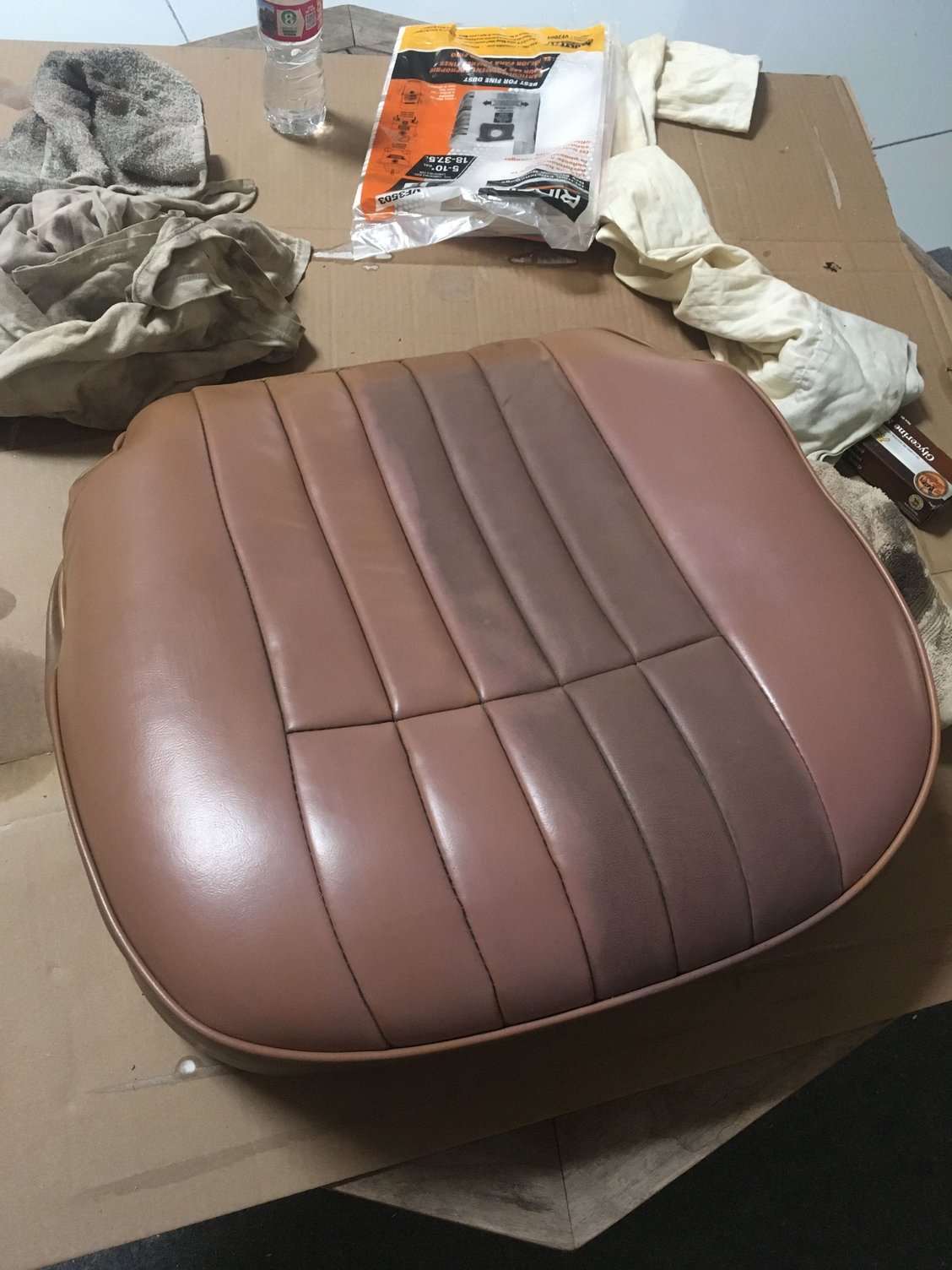

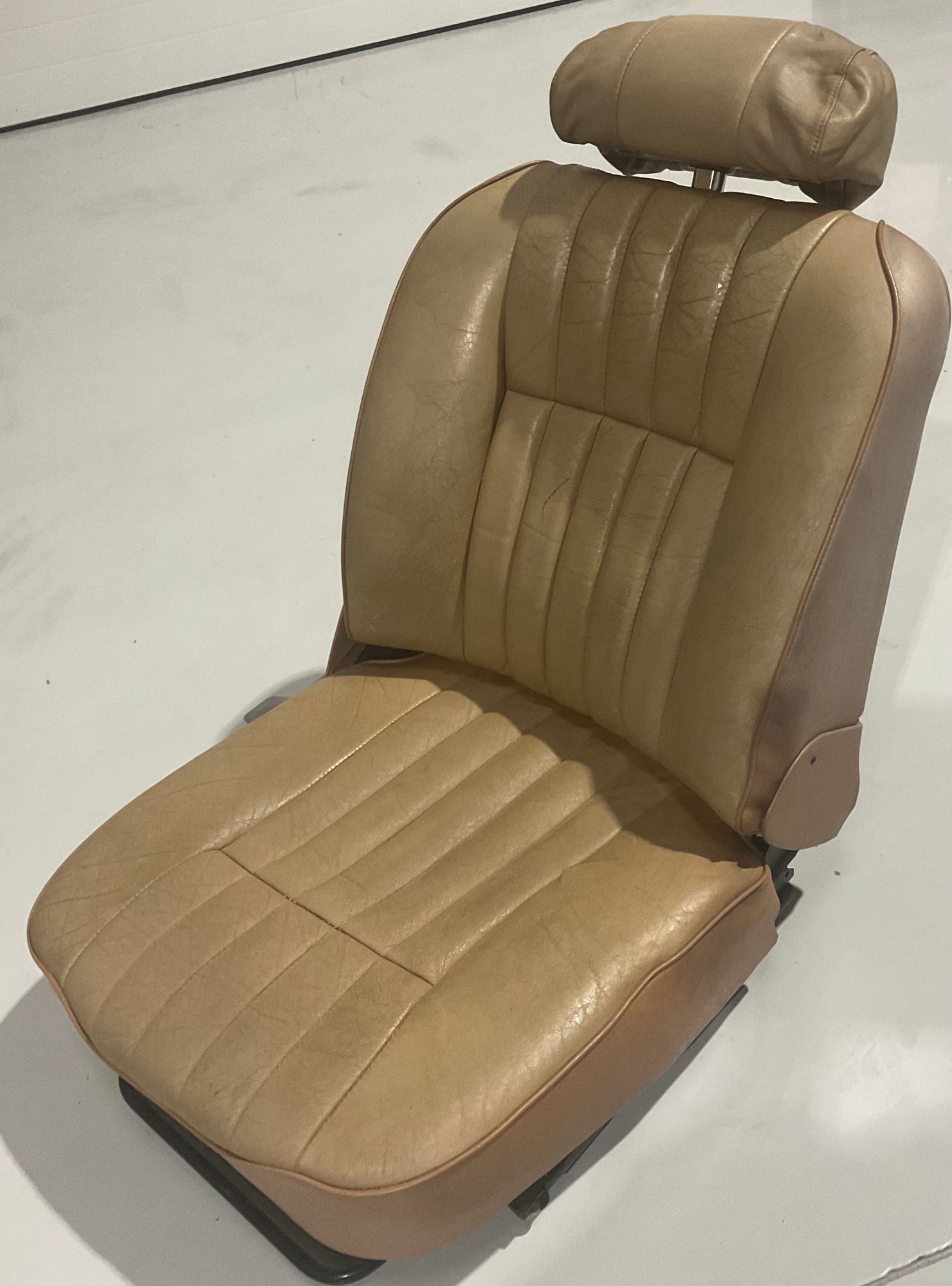

This is from a 1976 xj12. I wondered why they were so nice and cleaned up good with lacquer thinner… they are 100% vinyl. My other xj12 1977 has leather match (only touching surfaces are leather) and it’s cracked pretty bad. The pinkish color is sun fading..
Not sure what to use now. Worn out cracked leather or nice vinyl…. You can’t tell by looking it’s so good. (Pros can).
Something about leather. But really only if well taken care of over the past 45 years…
the worn out seat is the leather one. You can see the sides being vinyl..
Jeff, that vinyl seat has obviously been recovered, not factory.

Ok, I’ll stick to original materials then. Now I am stuck with a set of seats. Probably destined for the trash. The springs underneath are rusted gone.. and the foam is powder…
