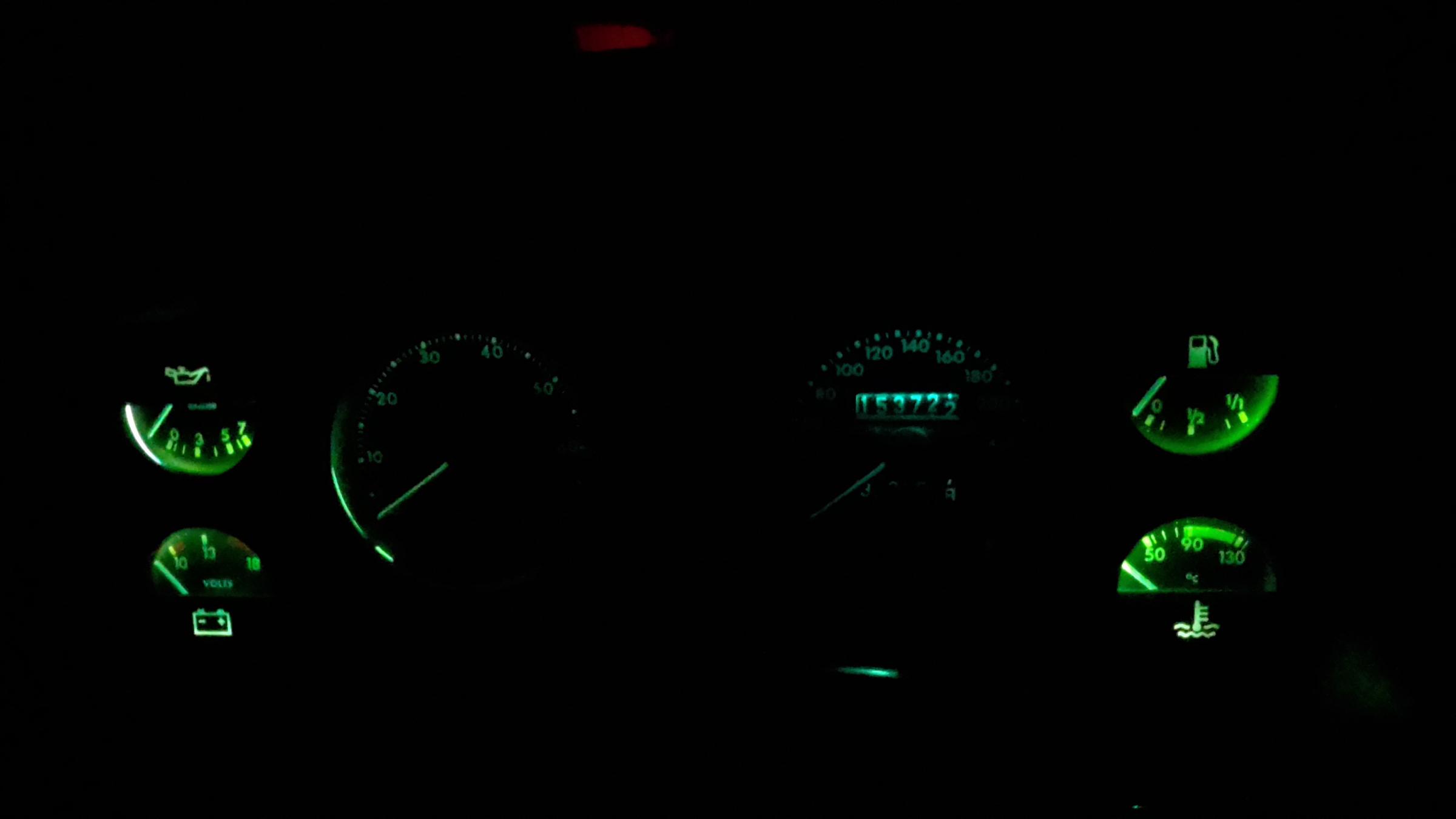

Overall, it makes a night and day (pun) difference in that now you can actually see the dang instruments at night.
The instrument panel lights fit fine, but there was one bulb (the tacho if I recall) where the E10 LED was a very tight fit and required that the socket base be manually pulled down from under the base so as to get the bulb to not protrude past the limited clearance.
As seen in the pics, one of them shows only one half of the panel lights swapped to LEDs, the crappy tablet camera barely even captures the incandiscent bulbs - that's how much difference there is. One minor side effect is that the speedo and tacho have a slightly different / lighter green shade.
