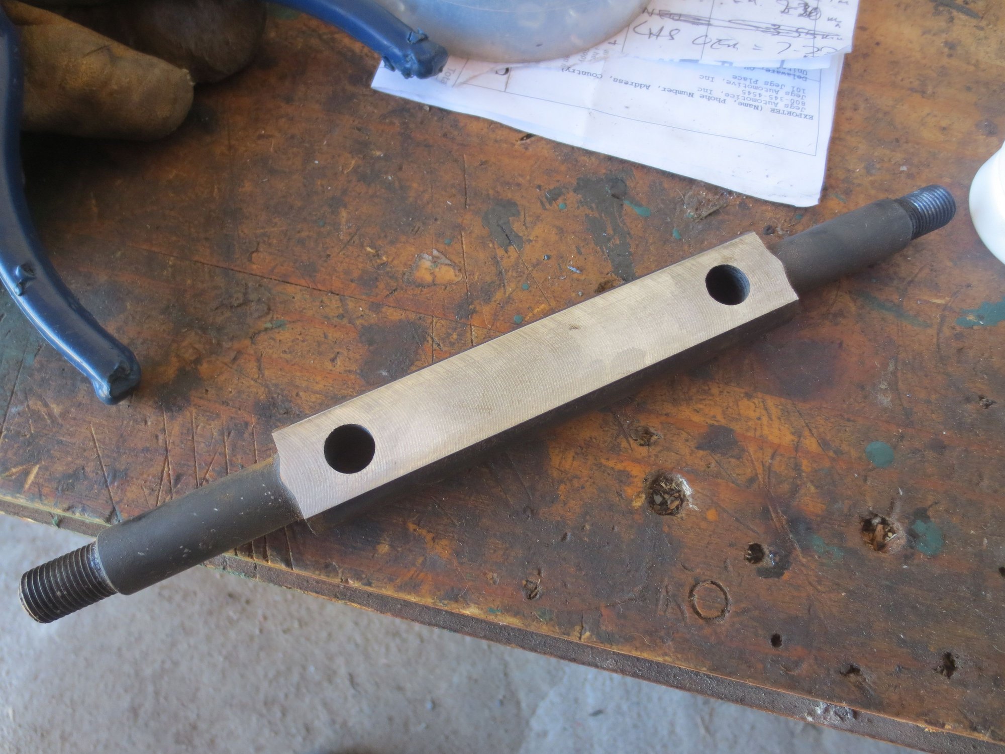

Another note, after pulling all the front spring spacers I got a noticeable drop in height (not enough) and lots of neg camber that mostly corrected after re-adjusting the toe in, but I'm about at the limit to add positive camber, ie. no shims. is this normal?
If you are at the limit of being able to reduce negative camber, quite possible on the factory setup if the ride height is lowered, then you can safely machine a bit off the outer face of the fulcrum pin. I had to do this when I fitted a brand new subframe that, I suppose, was slightly out of standard tolerance.
FWIW, I do not think adjusting the toe on the factory suspension can affect camber.

Good idea Greg, thanks. I don't think so either on camber, it's just when I pulled all the spring pads and put it back on the ground the ride height had dropped considerably, the toe was way out and camber was really heavy to negative. There was no room to bring the camber back out and I got worried but I also knew the car had never been in an accident so I figured I'd bring the toe back in close first. When I did, camber looked much more normal, still a little neg but driveable, might have been optical illusion as much as anything. All that said, I think it's due to worn ball joints and other parts being in another position without the spring pads. I think I'll go ahead and replace the ball joints and see if camber adjustment improves, then when I drop the subframe I'll have a opportunity to possibly jack the towers out a tiny bit before I take it all apart. I think I have another pair of fulcrum pins, I think I'll go have a few thou taken off just in case.
