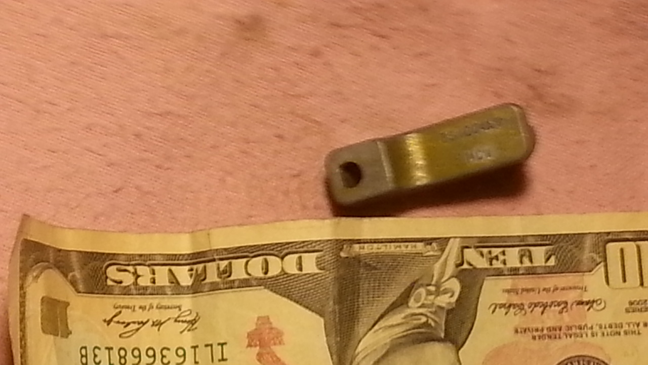

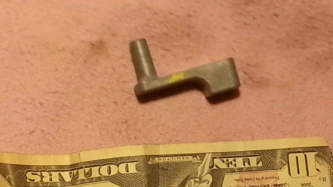

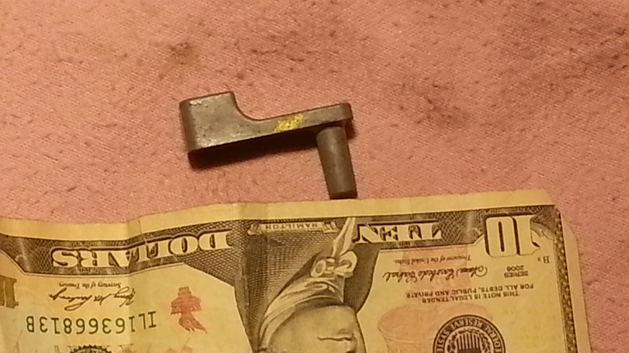

If you have a series 3 car,.. there is a small tool that was supplied with the car when it was new...It fits on the end of the motor that is used to electrically open/close the sunroof.
In the boot up against the cabin partition is where the motor is located.
The little tool looks like the one in the photo.
Handy little thing to have when it is raining and the sunroof does not want to close... I keep mine in cubby near shift selector.
Attached Thumbnails Manually open sunroof-20160415_070117.jpg   Manually open sunroof-20160415_070125.jpg   Manually open sunroof-20160415_070136.jpg
