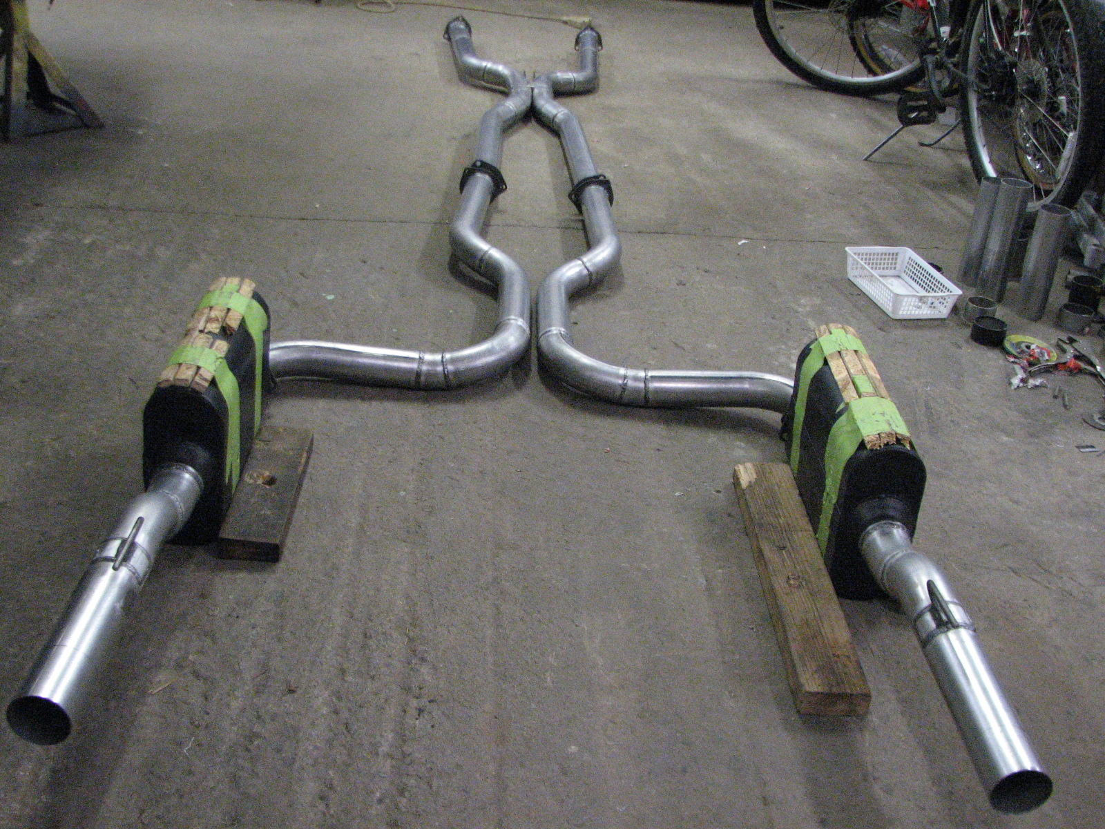

Hafrod,
X pipes do quiet the system. My 77 XJ12L has Flowmaster Super 44's - exactly what you do not want. But something that size in the rear muffler pocket and a crossover will give a quiet system. Mine is quiet at cruise, windows up. Romp on it, that is a different story. System is 2.5".
I also insulated the rear pockets and reinstalled that factory fiber board. Dropped the trunk temperature 20 degrees F.
I have used a 2001 XJ8 middle muffler ( has 2 pipes in and 2 pipes out ) where the old XJ6 cat used to live.
Connected to the rear stock (4) XJ6 mufflers and tail pipes.
That same XJ8 muffler is connected to the front down pipes.. Cheap quiet effective.
