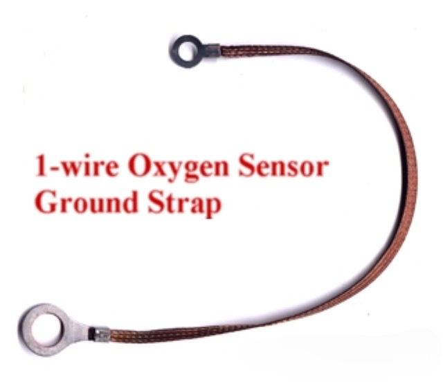

Carl and Mike,
another issue with the single wire O2 Sensors, is rusted exhaust manifolds and valve cover oil leaks over/under the manifolds preventing a good Ground to the O2 Sensor. (repeat: SINGLE WIRE O2 sensors, not the later 2 wire sensors).
try adding a ground strap to the O2 Sensor if yours is a single wire sensor. (I have no clue when Jaguar went with the 2-wire sensors but it might have been sometime in late 1985).
this "remedy" comes from the 1990's, it was recommended back then in other Jag forums, one of those "lost tips".
I fabricated my own strap per the picture below, the result is a stabler idling and a more "positive" signal from the O2 sensor to the ECU.
Snake Oil some people conclude? Try it, you have nothing to lose. It will not cause a nuclear explosion!!, I have had a strap in my O2 sensor since around 1991, the engine idles great, starts right up, and mine is older, first sold in 1984 and built in Sept. 1983.
wonder why Jaguar added a second wire to the O2 sensor later on??

12. Get under the car on the right side. You will fid a ground strap from the transmission to the car body. It must be intact and the connections clean. Grounds are a lot on cars.
Carl[/QUOTE]
This ground strap is critical in fuel injector operation. Make sure the contacts are spotless. I had a no start on an 1985 XJ6, and it turned out the injectors weren't being grounded properly, due to oily connections. I also added a seperate ground strap from the body directly to the coolant rail. No irratic idle since.
Carl[/QUOTE]
