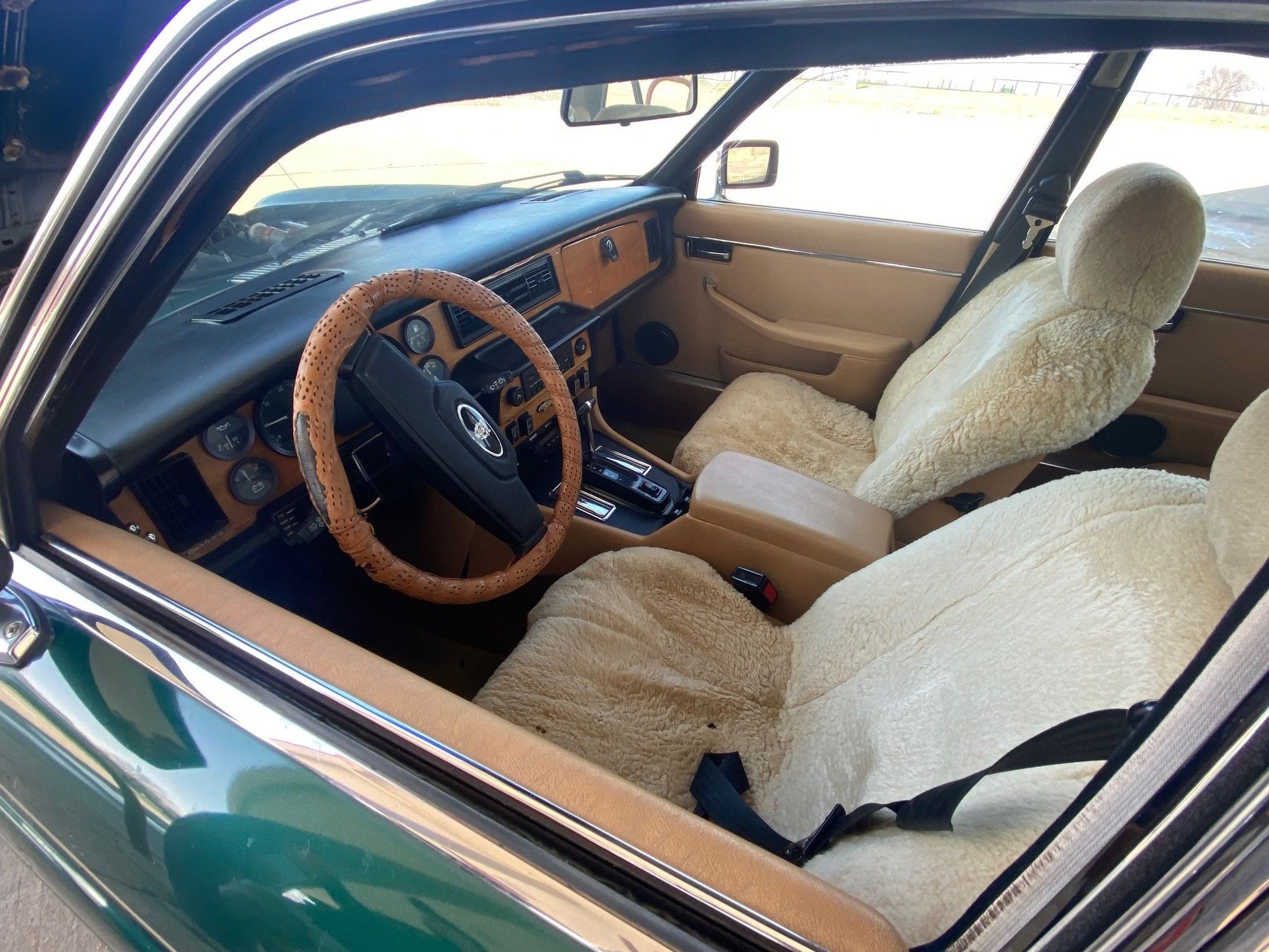

  • Interior is practically like new. Seats are original and perfect, still has the original Jaguar sheepskin covers from the dealer. Headliner is new. Dash is solid (with some flaking/cracks here and there).

Hi, I too have a 1984 but I never heard of factory or original sheepskin seat covers.

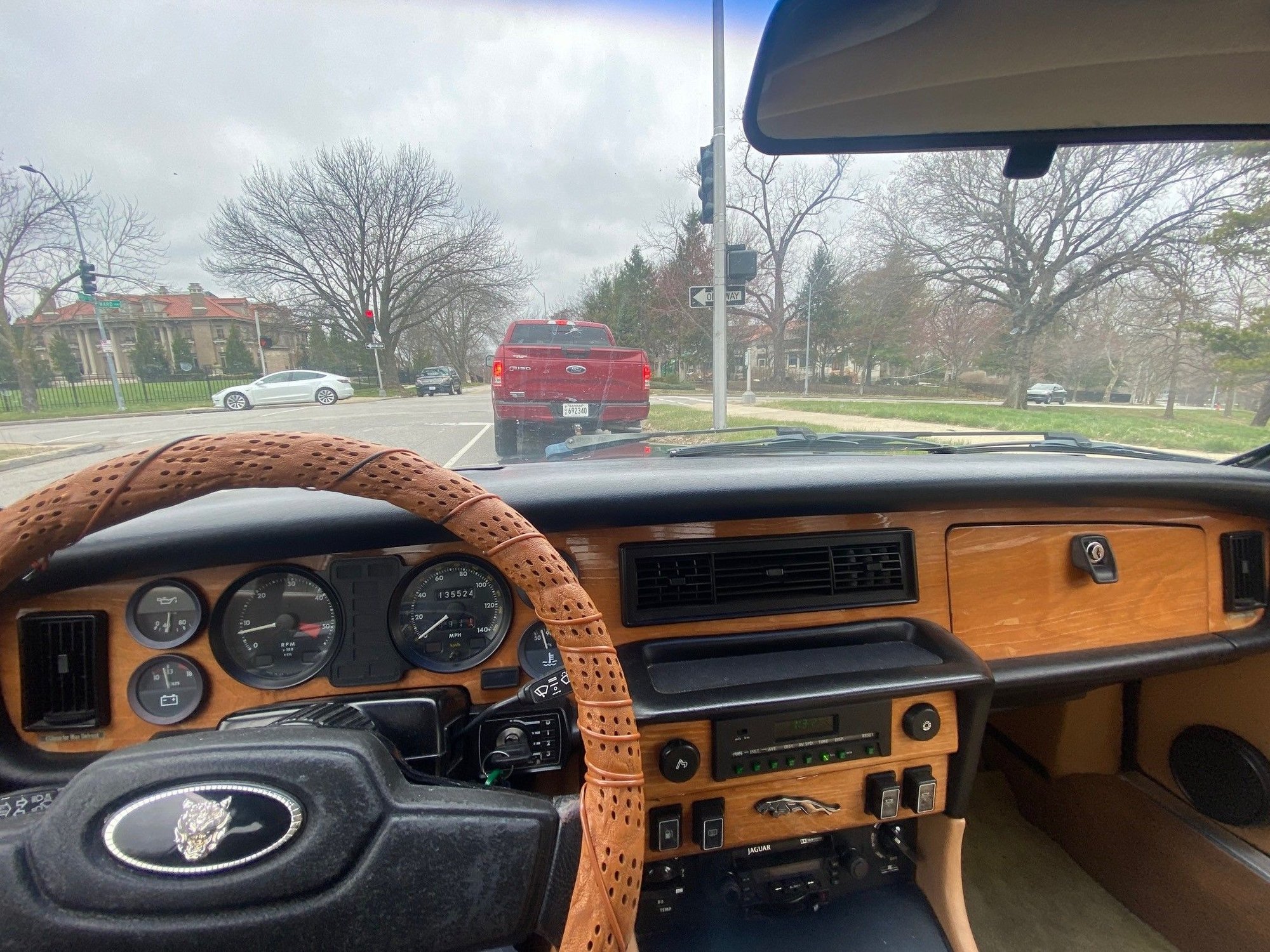

a photo of the radio will let us know if it is the original factory radio.

The seat covers have the Jaguar logo on them, I looked at the tags and I think it had what I assume to be the original US dealer. I assume they were some sort of dealer accessory. I'll check when I get home, maybe they were just some aftermarket cover purchased from a catalog, who knows. But something about them made me think they were from the original dealer, which I think had the same name as what was listed in the glovebox manuals/warranty info.

ok, yes that is the original radio, it raises and lowers the antenna automatically. It is a great sounding radio, I try to find them all the time, There is a guy in Orlando who can repair them.
If you are able to replace the mast with its cable, that is one way to fix it, or try to bend it straight.
There is a green relay in the spare tire compartment which is for the Antenna Delay and to raise and lower the antenna. Obviously the motor is good since it raised it. Those motors are gold. You might try opening the green relay and see if there's anything burned out.

The seat covers are most likely a dealer accessory.

Can’t swear to it but I think Jaguar offered sheepskin covers as an ‘official’ accessory. They were sold at the dealer level but carried a Jaguar accessory part number.
But the covers were all the rage back then do who knows where they might’ve come from.
I once bought a Jaguar fog light kit for a Series III. It was a full installation kit with Bosch lights. It was in Jaguar packing with a Jaguar part number. I think it was something for the USA market only.
