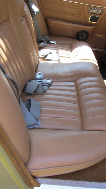

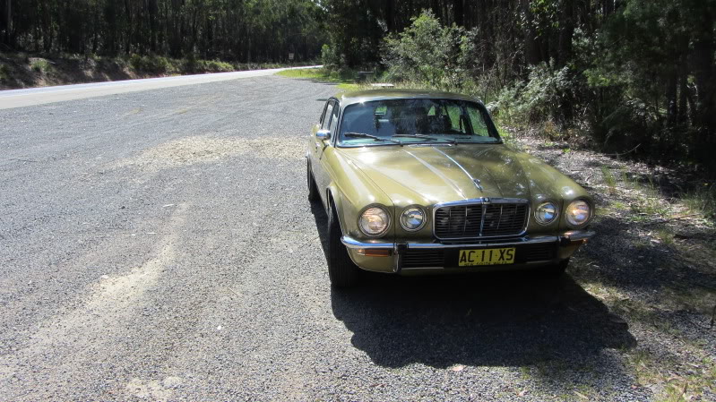

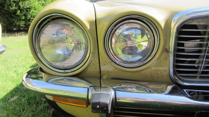

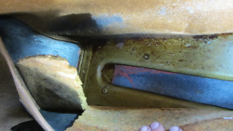

Bought myself a new toy on Friday, a 1976 Series 2. Drove it 1100km home with only 1 hickup (small inline plastic fuel filter clogging), otherwise was a dream. fuelpump on the left struggled a little at 100kph uphill but cruised beautifully. Incredibly original and well looked after car (mostly original paint), I can only find 1 bubble of rust anywhere in it. looking forward to pushing it in to daily use while I give my Volvo Amazon some TLC.

the engine compartment and the interior (including the headliner), looks in excellent shape. Congratulations.

Nice patina on that Kitty. Looks very comfortable. Check the tanks if your fuel filter clogged. In the USA we get "Federal" bumpers. I love those euro bumpers.
