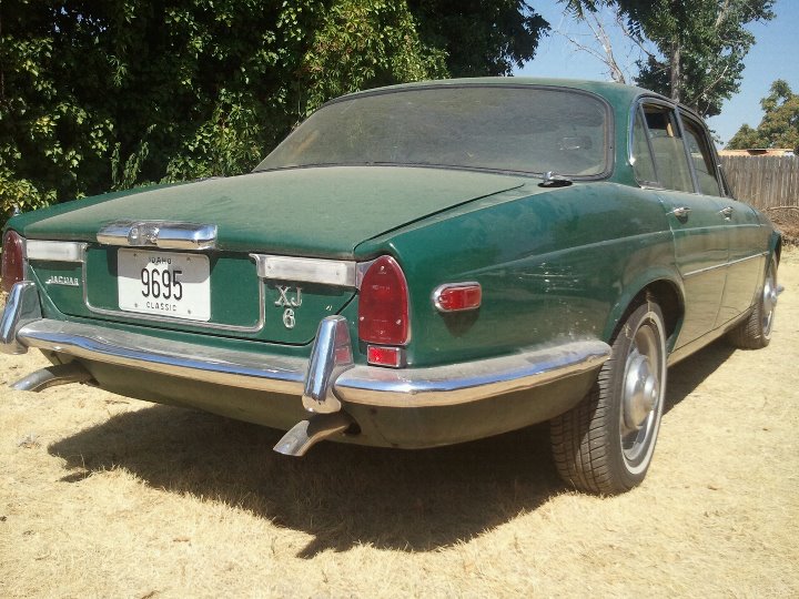

It actually reminded me of the song that goes, "I heard it from a friend who, heard it from a friend who..." Anyway, got the carbs running together and it is running and idling great! We are going to retard the timing a little and it should be purring like new! I will take some better pictures when it has been washed, but here are a few from my phone. Hopefully hit up the DMV tomorrow and have it legal by the weekend!

Nice looking car! Have not seen a green Jag too often. Make sure to get some engine/interior shots. I had a set of those wheels for my 86 for winter. I like the chrome look.

Congrats, this looks a fine lookin' ride . This is my fave front end for this era as well
