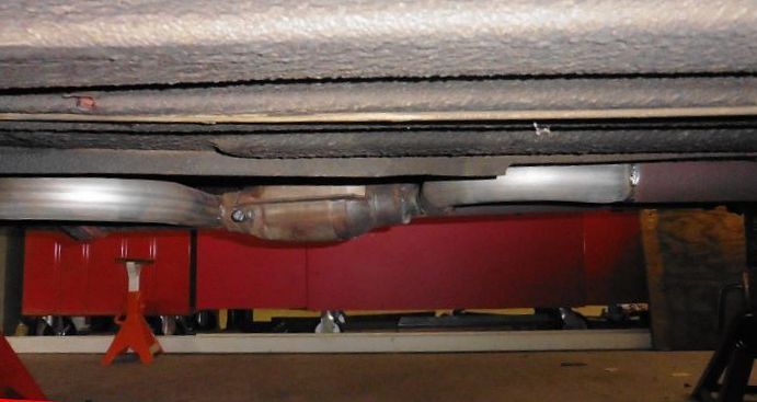

Wink Nix Got Her Exhaust Fixed!

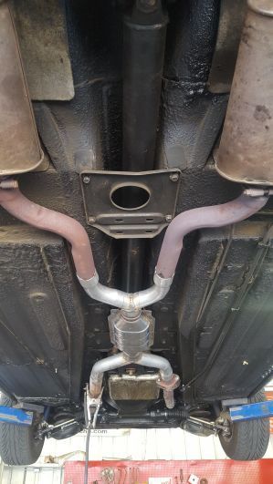

Almost everyone who's been here for more than 2 weeks knows about the Travesty of Nix's exhaust.
When we first saw the car it had dual exhaust and 2 cats. Well, in 1976 Jag didn't come with dual exhaust, and in 1986 the Chevy 350 didn't have a dual exhaust, but the PO had it done anyway and paid some guy under the table to look the other way (Even suggested we do the same!).
So they did this hack job to get it past SMOG legally and gave me the other cat in a plastic bag! Like what am I gonna do with that??!
Not only that, the cat hung so low I couldn't even go over the speed bumps at the COSTCO gas pumps without fear of dragging the cat loose. (I did that once in my misspent youth; knocked the muffler off at the front and wrapped the exhaust pipe around the rear axle. I do Not want to do that again!)
This has been an annoyance and irritation since I got the car!

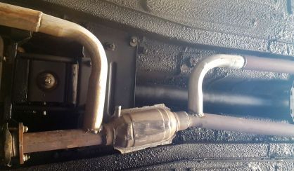

Well today I got it fixed!
I know some would not consider this is a big deal, reusing so many old pipes and all, but Jay (my mechanic friend) says the pipes are sound so there's no point spending any more money. I rather like that attitude!
He painted them all BLACK so they don't look so obvious.
Nix is Very happy! She even feels more peppy and sounds a Lot more authoritative!
We're going back to Jay in a couple weeks to get Nix fitted with NEW Mufflers! She's Really excited about that!

Looks good and that 2 -> 1 -> 2 is a good exhaust system design. It balances the pulses and spreads them across both mufflers more evenly for better mutual flow and a more european sound. Good move.

Very tidy Elinor, much more what you would expect to see under a car like Nix :-)

That really looks great, nice tidy professional looking installation.

Elinor:
1. Where did you get the idea that you were past misspent youth ? Misspent, yes. Youth, you gotta be kidding !!
2. You found a gem in Jay. A real craftsman. Twin pipes! An old term!
But, I'm an old guy! The cat serves well in two ways. Balance and cleansing. Admirable, no doubt.
3. Are the Jaguar mufflers bad ? Why replace them ? My car does well on mine.
4. I painted my down pipes with an aluminized paint. It is not burning off?? At one time, I regretted not doing the same on the new pipes and possibly the ones going through the cage. But, as they are "doing well"
I'll remove it from the pre list tasks.

Thanks, Guys,
The resonators are still there and I'll probably leave them alone for the moment.
That single cat was 30 years old and had dumped its guts into the right muffler effectively plugging it. Jay has ordered a pair of offset turbo mufflers as replacements which he says will give Nix an even more authoritative voice.
Even with one plugged muffler Nix has better response than before! Enough better that it isn't coincidence or weather or temperature. Not surprising I suppose, when one considers the hard 90 degree turns gasses had to make to get out of the engine. That had to compromise performance to some degree.

Um, well, I wrapped the exhaust pipe around the axle when I was a kid still living at home; in a place I wasn't supposed to be, doing something I wasn't supposed to be doing. Nuff about that.
2. You found a gem in Jay. A real craftsman...
Yes, I will keep Jay "on retainer." He does Excellent work, works fast, and works "with us" when he can. He's also certified SAE.
Besides that, he's a nice guy. I would guess he's in his early 40s; not an age I would expect to groove on old cars, but then neither am I!
3. Are the Jaguar mufflers bad ? Why replace them ?...
Yes. As I mentioned, the single cat shed its guts into the right muffler effectively plugging 50% of its flow. If one muffler is replaced, might as well replace both and not worry about it again for another 30 years.

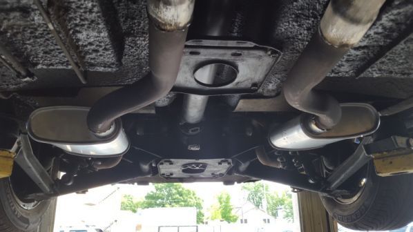

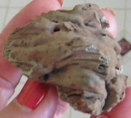

Talking New Mufflers!
El Gato Negra.
That's what Jay calls Nix even though they've been properly introduced. I don't mind though, because I understand how people find their own pet names for things they like, and Jay Likes Nix.
Today he put new mufflers on her and she Really likes them; they're Walker Turbo Off-sets.
He said the old mufflers rattled like they were full of rocks. Probably had something to do with being 40+ years old and having the guts of the single cat in them. He mentioned the cat was hollow when he took it off.

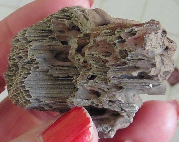

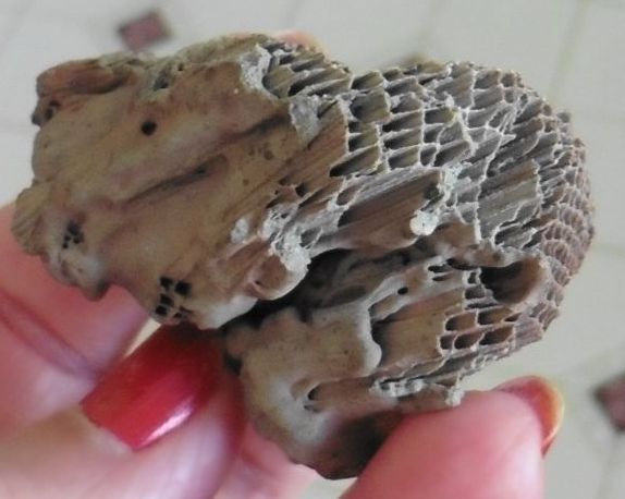

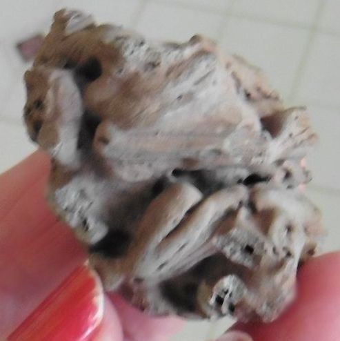

While he was at it he noticed a rattle in the right pipe. Further investigation revealed this chunk of *Melted* ceramic lodged on the curve just ahead of the muffler!
Notice how it's been *Melted*! That means it was At Least 4200F in there at some point for an extended period of time! It must have been Red Hot! It's a wonder the car didn't catch fire!
Does she sound different?
Oh Yeah! More throaty but still very lady-like, with just the slightest hint of snarl when taking off from a stop; growing to a wonderfully deep, full fledged Roar under hard acceleration.
Does she run any stronger?
I Hope To Shout!! Even husband (the hardest man alive to please) was impressed as I stuck my foot through the firewall and surprised him with minor whip-lash, pressing him back into his seat!
I can't wait till the next smart @** challenges me on the Passing Lanes. She did 138 mph with that potato in the pipe, I wonder what she'll do now that she can exhale as well as she can inhale.

1. How in the "God's green earth" did NIX pass SMOG with that molten "whatever" in a muffler???
2. As you say, Ceramics are akin to glass. Lottsa F's to soften.
It's all about Emissions, Carl, hydrocarbons and CO. I don't think ceramic sheds either of those so it would make No difference what was rattling around in there except maybe a charcoal briquette.

Elinor, that is catalityc converter honeycomb material, and it is toxic, you should not be touching it!!
