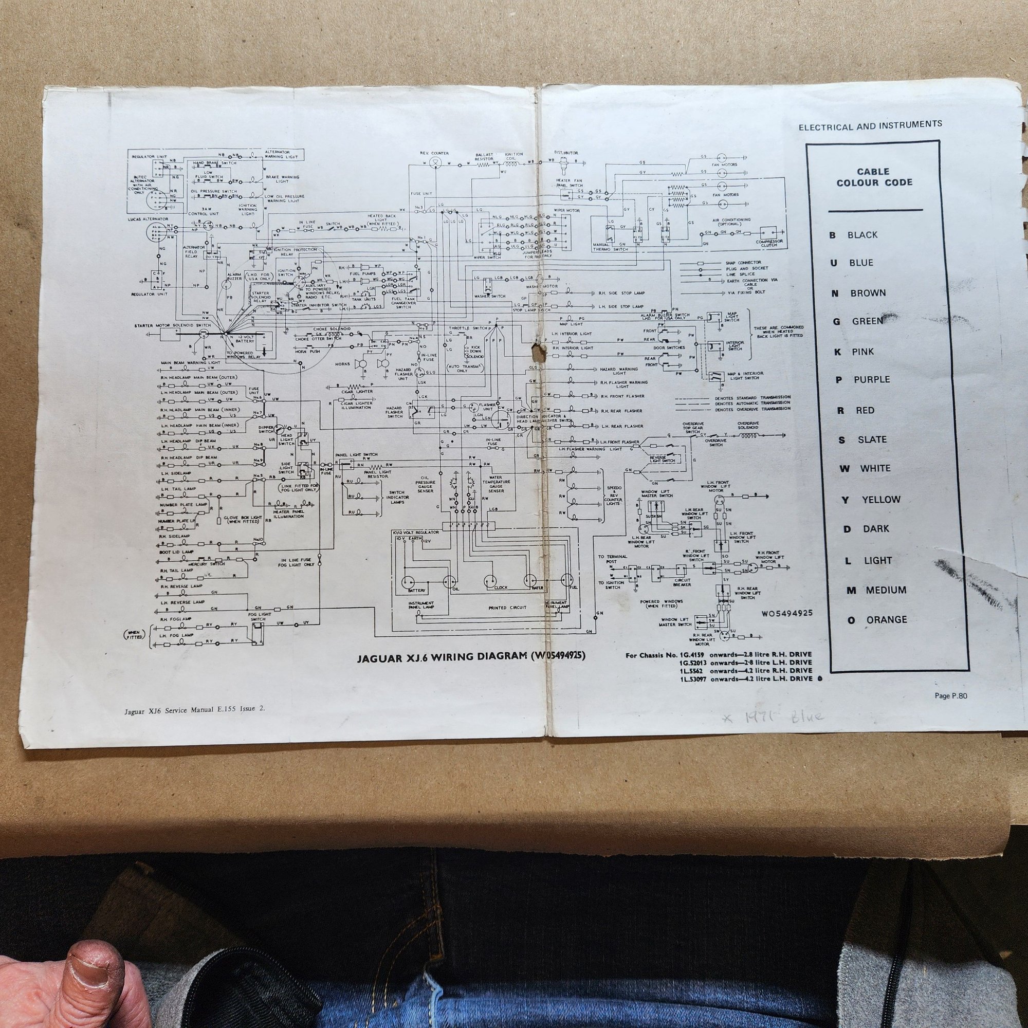

Old Mar 29, 2025 | 08:00 AM
Peter.peno's Avatar
Joined: Mar 2025
Posts: 4
From: Delaware
This may help.
This may help.
