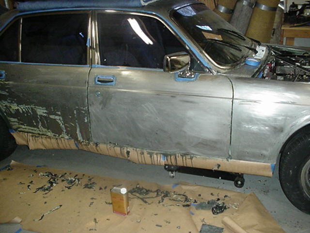

My 86 used to look like that... one of Jaguar's wonderful ideas that did not work very well ..thermoplastic paint,.. total crap !!
I took the trim off of the car and using paint remover from Home Depot and a pile of razor blades,.. I scraped the paint completely off.. down to the metal,..a bare metal respray. All of the car !! What total garbage paint that was.
Once the paint was removed,.. the pattern of the dry lake bed was visible on the bare metal as minor rust. Water had been dribbling down between the cracked paint fissures and coming to rest on the metal itself ..trapped there.
So after completing the body work (removed the hideous protection strips along the side of the car and filled the holes). Then the car was repainted with 2 part epoxy primer and paint. The windscreen channels were repaired at the same time.
So either soda blast it or (panel by panel) spread paint remover and use razor blades.

Yeah, when paint is crazed like that, there are only two choices:
1. Live with it ??? It will continue to irk you.
2. Do as Alyn did, remove and respray wit better material. Preparation is everything.
