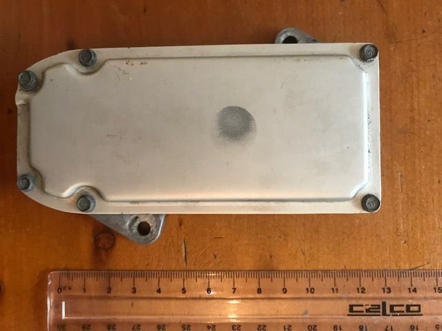

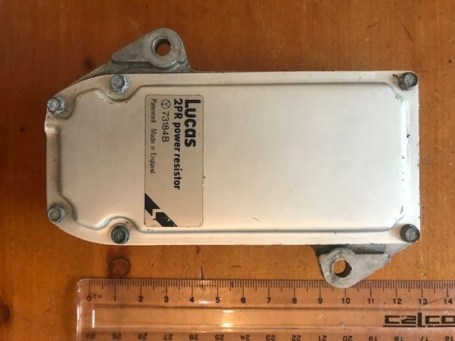

It's on the RH wall of the engine bay, down very low, well forward.
See the power steering pump on the RH side of the engine? Now go right over to the RH wall of the engine bay. The resister will be in that neck of the woods

thank you for the directions and the images.
hope to dissect the unit and find one of the eight resisters burned out.
only need six, so should be repairable.
