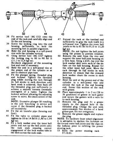

Dave - Have you done Item# 43 in the below?

Thanks for the thought, Bill. Yes, I followed that procedure when I rebuilt the unit, I'm not getting any "knock" or play of any kind and the action is very smooth, just ultra quick. I'm going to check the alignment tomorrow just to see if anything has moved around after its maiden outing last summer. I'm sure this will have to be an acquired condition.
