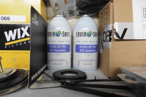

Enviro-Safe 134a Replacement Refrigerant
Available now and cool better that OEM refrigerants (yes mostly propane/butane), but does not harm environment if escapes; deals with system moisture that OEM refrigerants can't tolerate.
Have successfully used on 84XJ6 for 3+ years
Rgds
David
Not only used on my Xj6 Jaguar, but that Ancient Chrysler which I mention quite often in here, which was also R12 OEM.
I have easily over 10 years experience with this stuff (Ooo! Closer to 20 years experience now that I think about it!). It's very easy to use (directions on every can), takes far less to charge the system, and because of that, pressures are lower, hardware and hoses last longer and it leaks less due to larger molecular structure. Said to be compatible with all known refrigerants and lubricants.

Do you need to evacuate the system to use this? My system currently runs on R134. Ian
Old Sep 23, 2022 | 10:28 AM
Posts: 26,776
Likes: 10,318
I didn't. I took them at their word about compatibility. Works Just Fine! In fact, they say you're NOT supposed to put in an empty system.
Check the companies website for directions BEFORE you commit.
RTFM and all that.

Yes, all OEM refrigerants should be removed (evacuated) by A/C shop. ( keeps GRETA from having a meltdown). The evacuation will remove some oil as well as moisture. (if you have an A/C system leak, have A/C shop use their sniffers to find it before evacuating).
Minimum prep for new ES refrigerant would be to replace receiver/drier and do oil service with system not running. With ES they do not require or recommend pulling a vacuum.

I've used Enviro-Safe also, and recently converted a '73 E-Type with an empty R-12 A/C system to Enviro-Safe R134a Replacement. First, I converted the service ports so I could use my R134a manifold gauge set. Then I located and resolved the leaks in the system.
Then I did some math to estimate the proper Enviro-Safe charge. When converting from R12 to R134a, we typically use 75% to 85% R134a compared to the original R12 charge weight. Then, figure 6 ounces of Enviro-Safe per 16 ounces of R134a. The 8 ounce cans of Enviro-Safe are claimed to be equivalent to 21 ounces of R134a. So this system that was originally charged with 40 to 48 ounces of R12 only required 15 ounces of Enviro-Safe to cool well. Does it cool as well as R12? Probably not. Does it cool well enough? Yes.
Be sure to follow the current instructions from Enviro-Safe. They have changed over time.
Enviro-Safe R134a Replacement is predominately Liquefied Petroleum Gas, so it is rated "Extremely Flammable." See the attached Material Safety Data Sheet.
